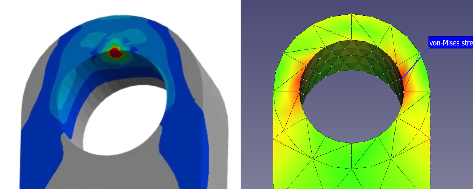

      Hi. We have now a more realistic distribution of the FEM loads derived from joint force and torque. We added shoulders to the pin
      in order to avoid adding un-realistic axial loads to the cylindrical face.
      We also use different profiles (linear, sine and triangle), for the force and torque FEM loads.
      However, we still have not been able to obtain consistent stress results from both Ansys and our combination of MBDyn and Calculix. To recap:
      Ansys and MBDyn output almost exactly the same joint forces and torques. But when these forces and torques are applied to a static
      structural simulation using Ansys inertia relief, the resulting stresses make no sense. We still do not know how to obtain a realistic
      stress distribution from the static analysis with inertia relief and the force and torque from rigid dynamics.
      Also, the Ansys transient simulation produces a very different stress too, inconsistent with our simulation.
      I suspect that the reason is that, unlike what is shown in the video you shared above, in our simulation we assume that there is no
      clearance between the pin and the pendulum. Can this explain the discrepancy? This is the difference between Ansys and MBdyn/Calculix:
      You can have a look a a detailed explanantion of the MBDyn/Calculix simulation here:
      https://mbdfem.com/obliquePinPendulum.html
      I would love to understand what is going on. Thak you very much.
