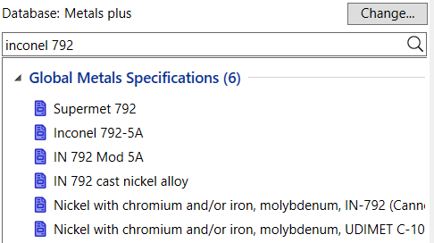

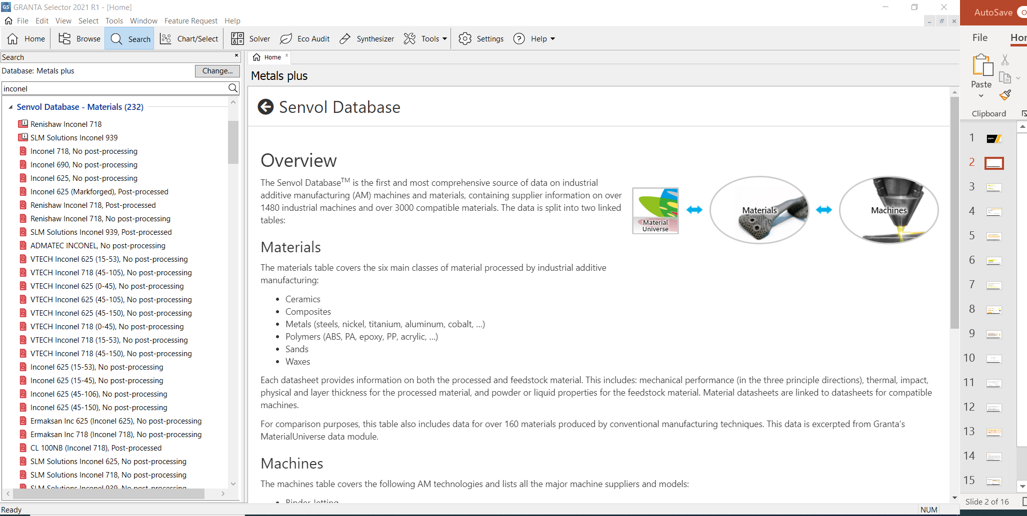

Ansys EmployeeHi, you can find anisotropic properties of additive manufactured materials in the Senvol Database for example, included in Ansys Granta Selector. Below a screenshot for all type of Inconel alloys. And for the Inconel 792, many datasheets are given in a more global databse of bulk materials. Here for more details: https://www.ansys.com/products/materials/granta-selectorn
