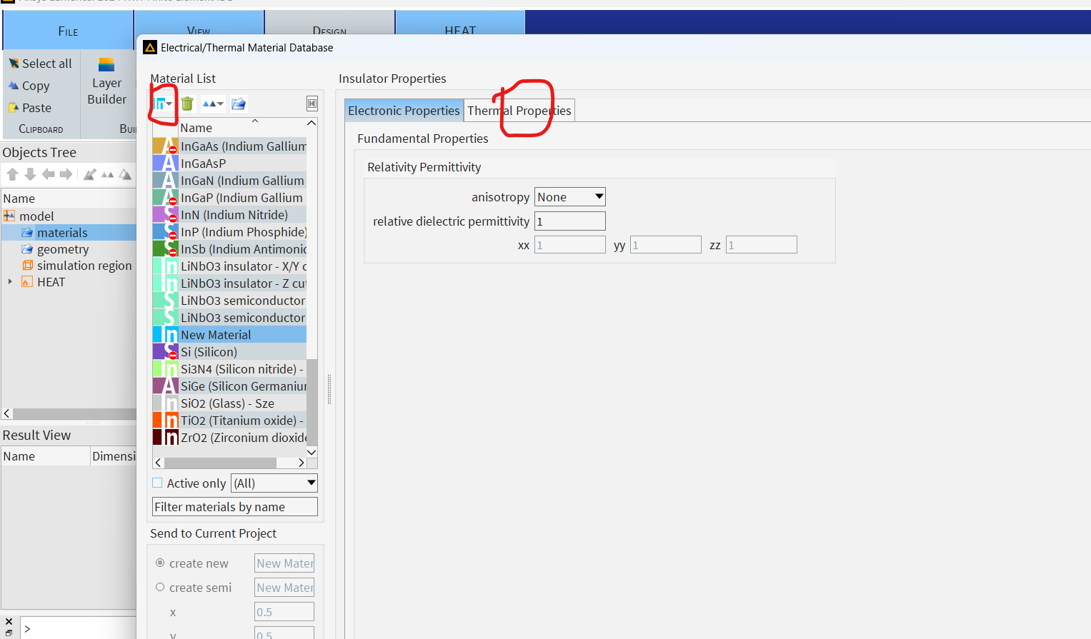

      Hello there
      I am using Lumerical for the first time and am facing some issues like one among them is that I don't find the materials like ITO , P3HT-PCBM in Lumerical Heat whereas all these materials are present in material database of Lumerical FDTD . Is there any way to get these materials in Lumerical Heat ,
    • Guilin Sun
      Yes, you can create new materials with known parameters. The material database has limited number of collections. Please refer to this link
      material parameters needed: https://optics.ansys.com/hc/en-us/articles/360034919093-Electrical-Thermal-material-models-in-CHARGE-HEAT-and-MQW
      using script:  https://optics.ansys.com/hc/en-us/articles/360034919233-Creating-and-modifying-thermal-materials-from-a-script
    • bisma_03phd17
      Thanks for answering this question! Is there no option just like "import" in Lumerical heat like we have in Lumerical FDTD ?
    • Guilin Sun
      Electrical/Thermal material models in CHARGE, HEAT, and MQW
      You can import material from optical solver, or import by script. Please refer to the above links.
