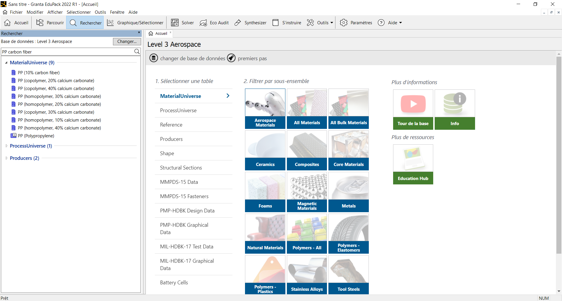

I'm looking for a very specific material- 40% Carbon Fibre reinforced PP composite, but I can't find it under the Level 3 Advanced Composites section. Could you please help me locate this material or anything similar to it?

Ansys EmployeeHi Vishakha What do you mean by Level 3 Advanced Composites section? The Level 3 Aerospace of EduPack?
If you use the search option, here a screenshot of what you get if you look for reinforced PP with carbon fiber (see below).
There is only a record for the 10% carbon fiber one. I think you should use the Synthesizer tool to estimate the properties of the 40% one.

SubscriberThank you so much for your answer. What I mean is- I couldn't find it under the composites section, do you have any carbon fiber reinforced PP composites available under it? When I clicked on composites, I could see that there are glass reinforced composites available.
I found the 10% carbon fiber, I'll try using the synthesizer tool.

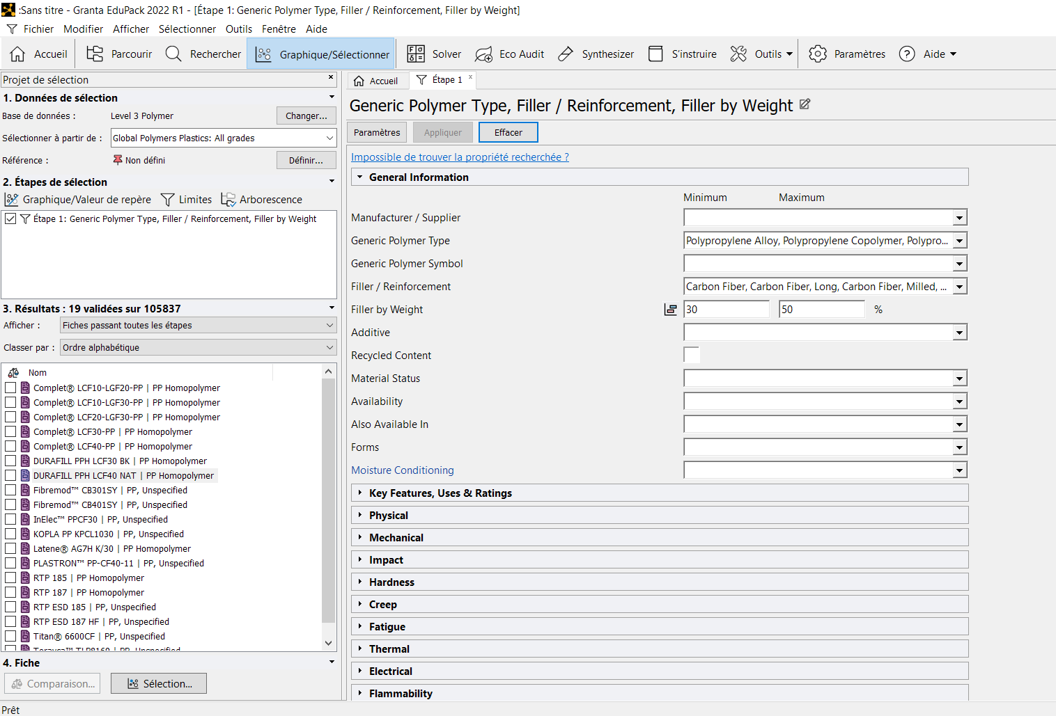

February 8, 2022 at 5:53 pmFebruary 8, 2022 at 6:20 pmVihakha
Thanks so much!!
March 17, 2022 at 2:07 pmDavid Mercier
Ansys EmployeeIt's a matter of classifcation. Of course a reinforced polymer can be seen as a composite, but in our case we prefer to keep it in the polymer section. Cheers
