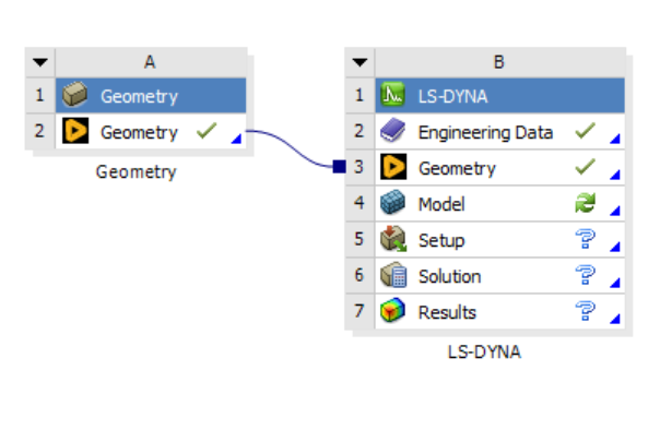

      In my LS-Dyna/Workbench workflow (shown below), how can I find/add the following materials to engineering data? My simulation application is electromagnetics (i.e. magnet snapping).
      • NdFeB, N35, Permanent Magnet
      • Copper

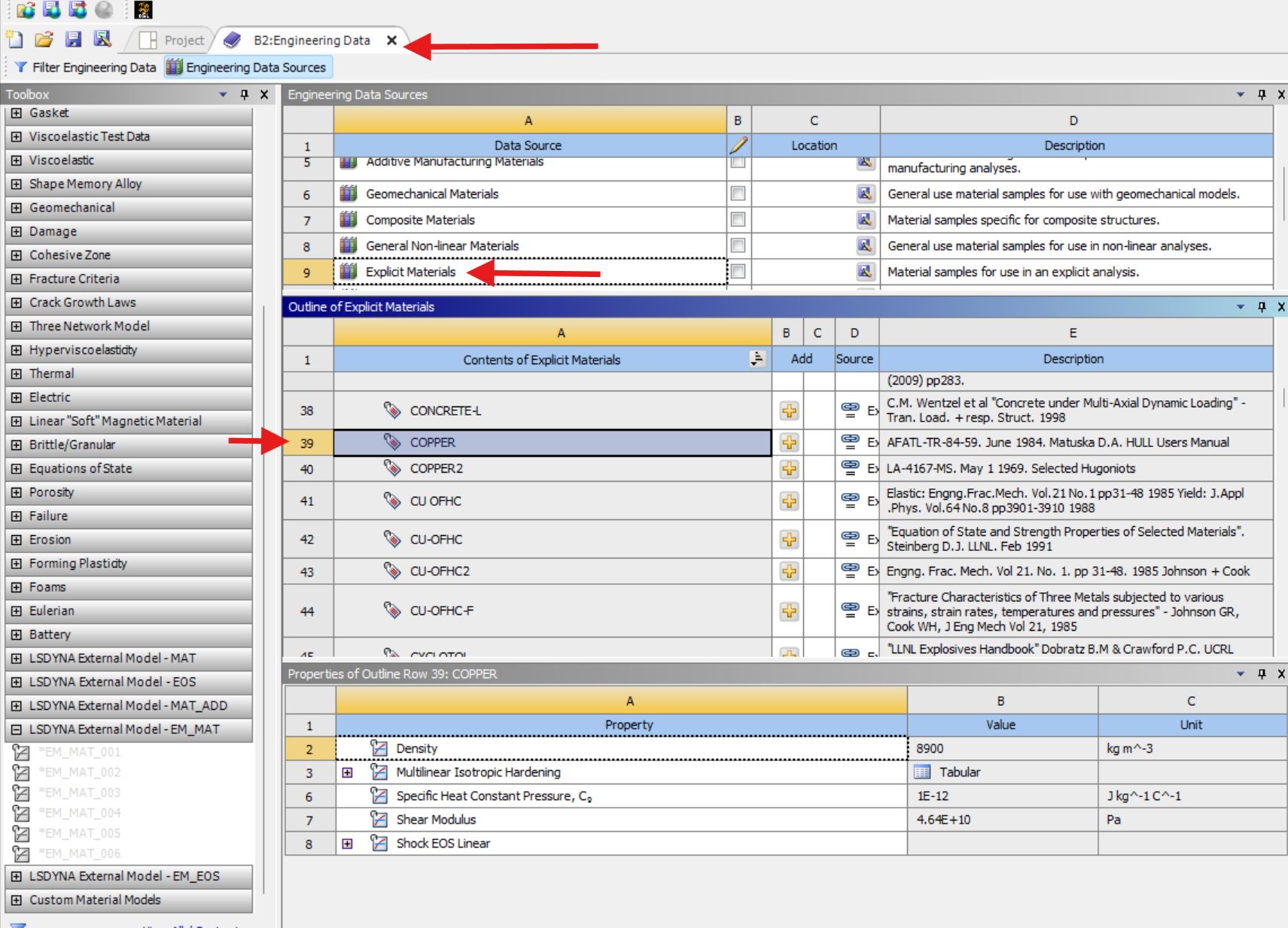

      I was only able to find a copper material under the Explicit Materials library, would this material selection be apporiate for my application?

      the best way to check these things is to write out an input k file and read it inside a text editor.   Most of the workbench material models that's not part of the "LS-Dyna material models" group are not converted.
      You can write out the input file by click on solution inside workbench ls-dyna.
      The most direct way to use the material model you want is just to insert the mat card directly by right click on the component and insert a command line.
