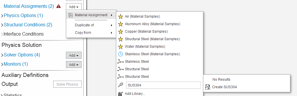

      I am using ANSYS Discovery AIM 2019 R3 for structural analysis of a model made of stainless steel, in reality defined as SUS304 in Japanese Industrial Standard. However, I cannot select stainless steel as the material in the analysis option instead of structural steel. Stainless steel has different Young's modulus, so its deformation must be different.
      Does anyone know where the material data of stainless steel is available?

      Hello tyada
      Have you tried creating new material and assigning the Young's modulus or other required values?
      Please refer image below for this options.
