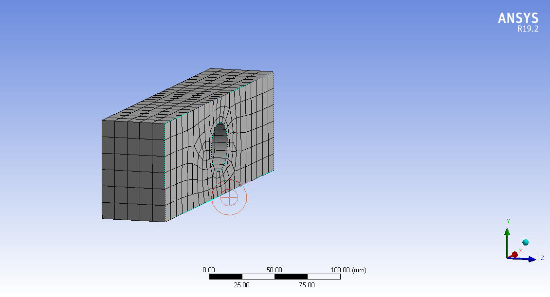

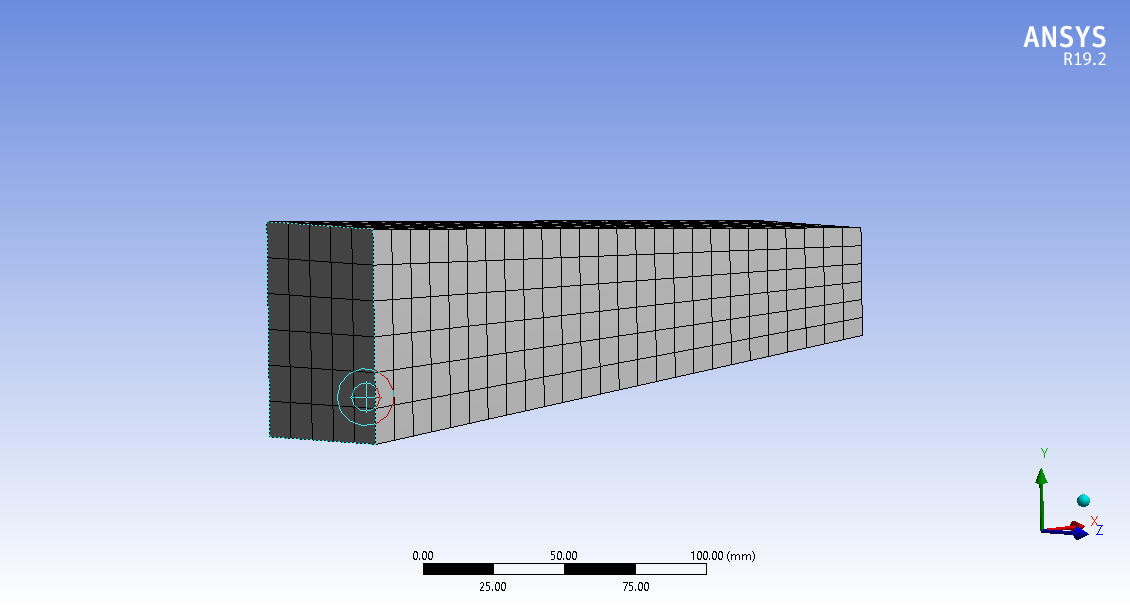

Saieswar
I am working using the static structural module, I have two geometries with similar dimensions and their origins at the same location and I have observed that many nodes have the same coordinate values. I have attached the images for reference.
My first doubt is "Is there any option such that we get the same node numbers for those nodes which have the same coordinate values?" -
