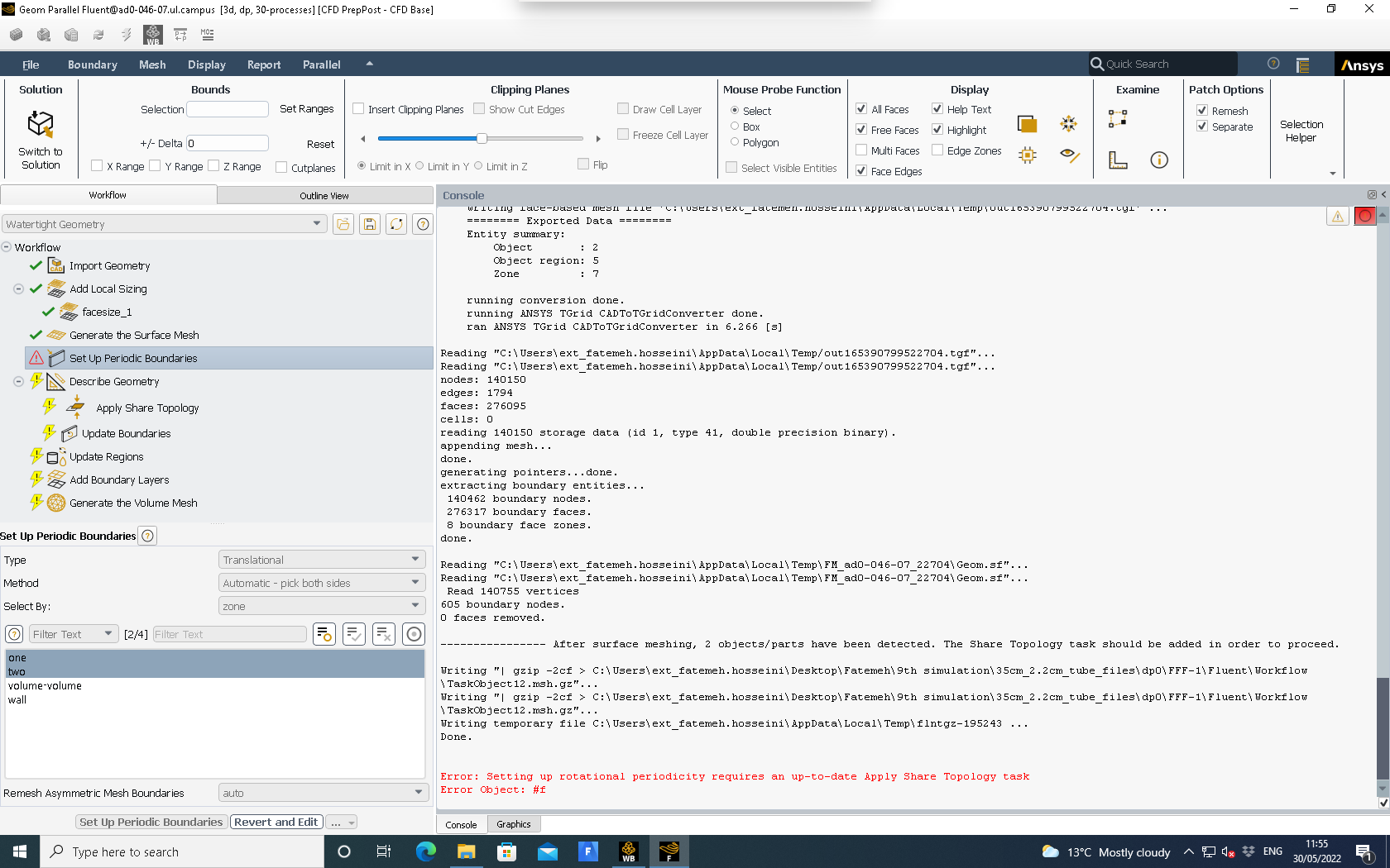

I am using Fluent meshing to mesh a tube. I need to use periodic boundary condition in fluent for inlet and outlet of the tube.
Before I used Ansys meshing, I used match control to matches the mesh on two surface(Inlet and Outlet). But now I can not find match control in Fluent meshing . Is there any other option in Fluent meshing that match 2 surface mesh?

I tried to use the method on the video but the error occurs.
The geometry is a tube that I want to use periodic boundary condition for inlet and outlet. (So it is not a rotational periodic boundary condition,it is transnational.)
The screen shot of the error has been attached.
Regards Fatemeh

Ansys EmployeeMake sure your geometry is topologically periodic. Also if automatic is not working, try manual option.
6.2.5. Setting Up Periodic Boundaries (ansys.com)
