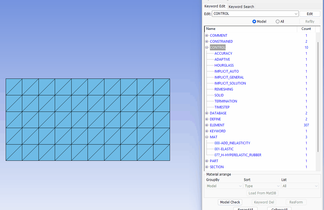

SubscriberIs there any reason that control_adaptive does not work with mat_add_inelasticity coupled with a hyperelastic material model?

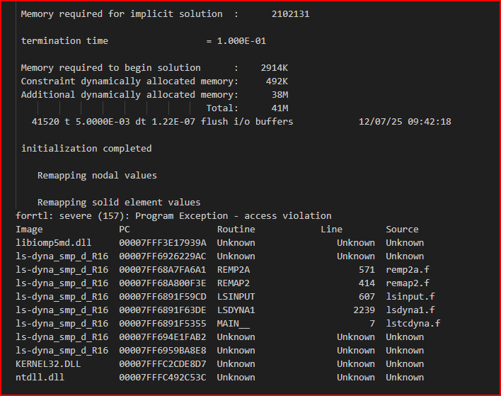

December 7, 2025 at 3:46 pm
Dennis Chen
SubscriberHi Ram, sorry for such a late response.  Below is what I see.  I am not sure if this is because I am on a student license at home that this is happening...I also used Mat_77 with mat_add_inelasticity.  If your example is working, then I am sure it should work and it's probably something going on with my home student license setup.  I will try this at work next and see if it's still an issue.  If it is still an issue, I will submit a formal support case since it would be work related.Â
