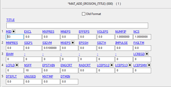

I came up with this idea. I want to use the MAT ADD EROSION card to remove unnecessary elements in the calculation.
for example, I know that I do not need stress elements higher than 550 MPa.
The MAT ADD EROSION map is very large and I am afraid of making a mistake.
Please tell me how to indicate in the map so that all elements whose stresses exceed 550 MPa are removed? Can I assign a SIGVM card? What else is needed? Thank you. -

Yes. The best way to learn about LS-DYNA is to create a simple model (single element model) and do some quick tests. You should be able to erode your elements with SIGVM only defined in *MAT_ADD_EROSION. See the LS-DYNA user manual Vol II for more information about *MAT_ADD_EROSION:

SubscriberThanks for the answer. Yes, I studied the materials. But it doesn't say that there. The problem is that I cannot generate the correct binot file to read the fatigue data. Some elements are strongly stressed throughout the entire calculation (singularity). They interfere with the fatigure calculation and I get an error that the voltages are greater than the Wöhler curve. Therefore, I decided to remove singular elements directly during the calculation. The criterion for removal is von Mises stress. The MAT ADD EROSION map is very large, but the parameter I need is only one - SIGVM. I plan to use only it and the material indication. Thank you. I hope I'm thinking correctly.

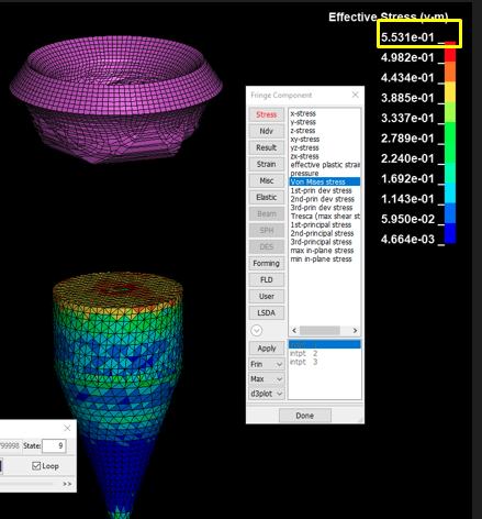

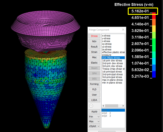

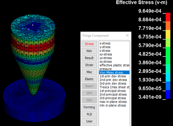

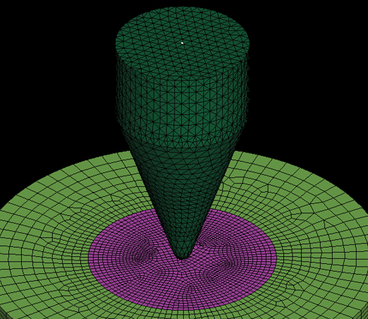

SubscriberHello SIR!I didn’t make a small model because my model is already small and the test model is just right for such tests, I drill the SPG die with a simple drill without a blade:When the drill passes the die, during its free downward movement, a voltage increases (I think a singularity) which prevents me from conducting a fatigue analysis:For this purpose, I decided to use the MAT ADD EROSION card to cut off all stresses above, for example, 510 MPa when the drill has already passed the die. But when I turn on the MAT ADD EROSION card:it immediately begins to remove elements when the drill has not even touched the die and the calculation goes on to infinity:
