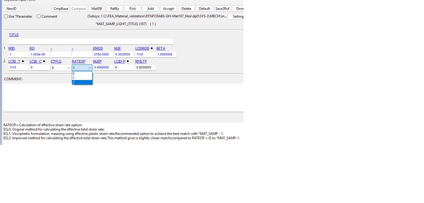

Hi
Reason it is not there is that in 2025 R2 LS-Dyna keyword manual II (R14 is used in WB LS-Dyna) it is not there:
RATEOP Calculation of effective strain rate option:Â
EQ.0: Original method for calculating the effective strain rateÂ
EQ.2: Improved method for calculating the effective strain rate.Â
This method gives a slightly closer match to *MAT_-
SAMP-1 and is thus recommended.Thanks for letting us know though that it exists in R16 manuals&LSPP – so you would need to open up a support ticket (ACSS) direct or via channel partner (cadmen) and ask for an enhancement request on this (cadmen will then create one for you).
