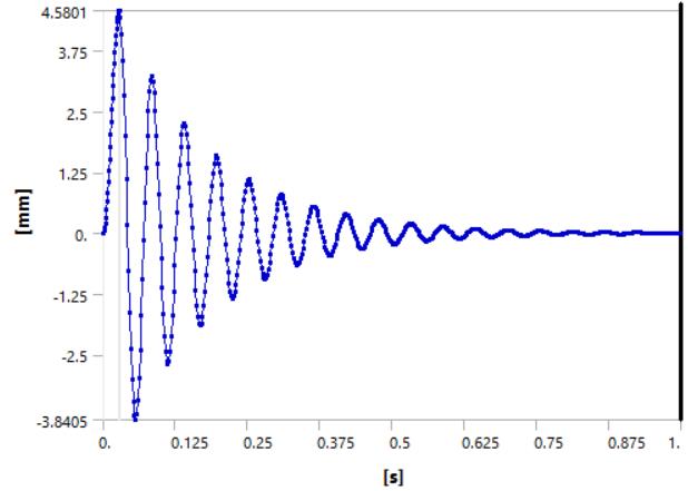

    • AhmedCfx
      Thank you sir for your support, your information were really helpful. Please how can I create a graph like that ?
      Attached is an ANSYS 2019 R3 model that provides a damped spring-mass system with an input force to disturb it.
      I did not use 500 g of mass or a spring rate of 0.4 N/mm, you will need to edit the system to set that up.  You can add a Point Mass to body 1 to make up the difference between the current mass and the desired mass.

      Dear peteroznewman
      How can I get such graph in ansys 18.2?

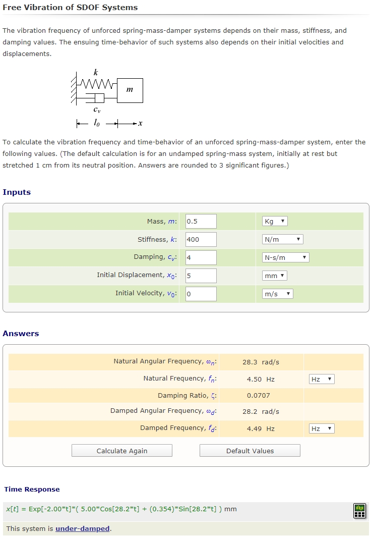

      You don't need to use ANSYS to get the graph. You can use this website. Below is the solution to your problem.

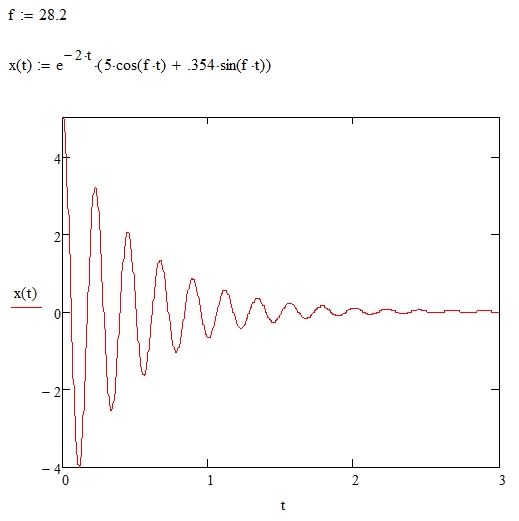

      You can type in the equation into a program such as MathCAD or Excel to plot the time response.
