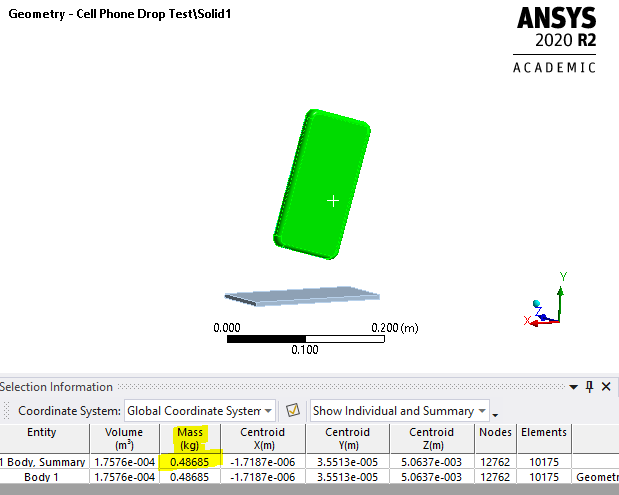

I was running an Explicit Dynamics simulation of a cell phone drop test (as part of Ansys Innovation Course called Strain in Deformation Analysis). In the simulation mass scaling was used and after getting the results I started wondering how much did the mass scaling affect to the mass of the cell phone.
I got the following results as shown in the figures:
October 14, 2020 at 2:49 amMissy Ji
Ansys EmployeeMass from solver output is more accurate, the mass shown at the selection information is an estimation.nOctober 14, 2020 at 8:36 pmNikke
SubscriberHi mji,nThank you very much for your comment!n I checked the solver output file admodel.prt for the analysis with mass scaling turned on. I found this data from the file (the unit of mass is milligrams):n
The highlighted row corresponds to the phone part. I guess these are the correct values for the mass scaling that I should use when checking how much the mass scaling affected to the mass of each part.nHowever, I'm a little bit confused now what do those MASSALL results mean that I showed in the first message, especially the row saying Total [kg].n-Nikken

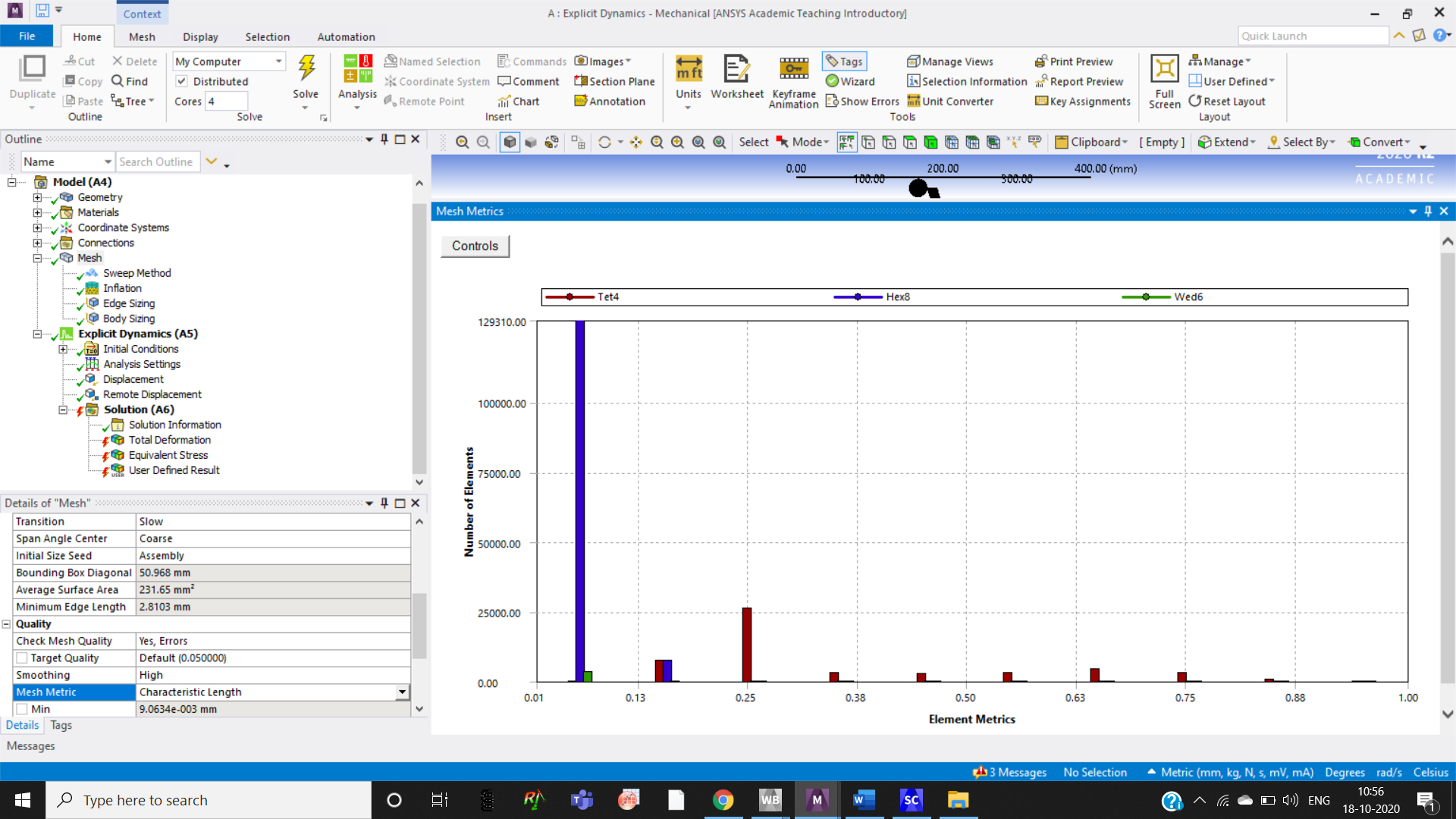

October 21, 2020 at 6:58 pmKp_9079
SubscriberThank you nIn these photo i can see min mesh metric characteristic length and the graph nso can you tell me how to locate these element with min mesh metric characteristic length from the graphnOctober 22, 2020 at 11:24 ampeteroznewman
SubscribernClick on the tall blue bar and those elements are shown in the graphics window. n
There may be some elements with shorter CL but those bars are too short to see with the top of this tall blue bar visible on the scale. Watch this video to learn how to use the Controls button to zoom in on a small number of elements and the short end of the CL scale.nn
