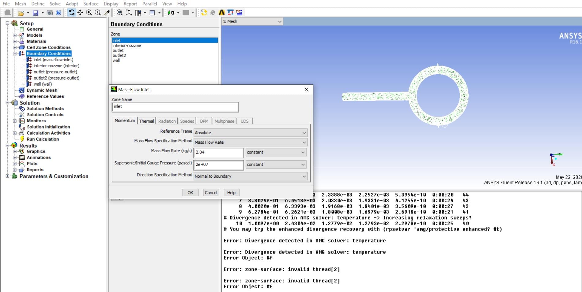

      Here I have problem.
      In this flow of water is flow from inlet at 2.04 kg/s and at pressure 20Mpa. so I found this divergence error of temperature. what it is? and why is it causing? I go for 50 iteration.
      the mesh is natural. I did not change it.
      I want to know outlet pressure and mass flow rate. once in past I did same experiment with 0.34 kg/s and 1MPa flow rate. so I got weird result the dynamic and total pressure at outlet is 42Mpa. How?
      The inlet diameter is 25.4mm and both outlet is 1.5 mm. the flow rate is also sometimes give me positive value and sometime negative at outlet. once it gives me 7.058 l/min at each nozzle? Is it possible at 1MPa pressure?
      So basically I want to know relation between mass flow rate and static pressure at inlet boundary condition? how I can get accurate pressure and mass flow rate ?

      Here I describe my problem in detail.
      Here the water is flow from inlet to outlet as shown in this image.
      suppose for inlet the diameter is 25.4mm while the outlet diameter is 1.5mm . Now my inlet mass flow rate is 0.34kg/sec and static pressure is 1Mpa as shown in first post.
      I put that all things in boundary condition, so I get weird results mass flow rate at outlet is in negative and static pressure at outlet is atmospheric, but dynamic and total pressure is 42 Mpa.
      How is it possible? what is wrong with it?
      when I changed the value I got "divergence detected in AMG solver: temperature" and iteration stop to run. Why is it?
      So my concern is If my inlet pressure and mass flow rate is fixed and I put that both in inlet boundary condition although I get weird results of both of them. why?
      I want to know outlet pressure at tip as well as mass flow rate from outlet,also I want to know that pressure and mass flow rate divided equally or not.

      I'm assuming that you are solving an incompressible flow.
      You cannot specify both mass flow rate as well as static pressure at the inlet. If you are specifying the mass flow rate, then you are fixing your velocity at the inlet. The other input is only the Initial Gauge Pressure (which is used only at the time of initialization). What boundary condition are you using at the outlet?
      Also, are you seeing any reversed flow at the outlet?
      Thanks.
      Karthik
    • MEETG
      Heyy, thanks karthik for response
      I have gauge pressure and mass flow rate of water at inlet and I want to know the mass flow rate and pressure at both outlet as shown in fig.
      I also want to know the velocity of fluid at outlet if possible.
      So I put inlet boundary condition in terms of mass flow rate and outlet is pressure outlet, but I got an error while calculating iteration "error: Divergence is detected in AMG solver: temperature"
      yes, the fluid is water. outlet is something like nozzle so I want to know about spray.
      so where am I wrong, can you help me?
      Thanks again.
      Meet

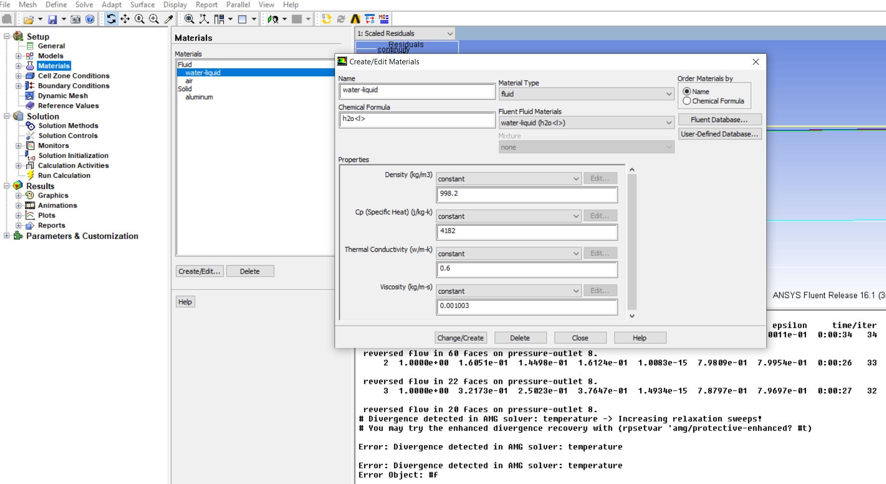

    • RK
      How are you calculating Cp value?
    • MEETG
      Hello, Rahul
      I take default value of Cp for water that is 4182 j/kg k ..
      but does it matter?
      thanks.

    • RK
      Can you please try with piecewise-linear?

    • RK
      Look into the dropdown option beside Cp. You will find the piecewise linear option. Also, what are the operating conditions?
    • MEETG
      Heyy, Rahul
      Thanks.
      yes the error solved.
      I take input gauge pressure 1MPa and pressure output is atmospheric pressure means gauge pressure.
      I get integral static pressure at inlet : 14369291 (pa)(m2)
                                                       outlet & out2 : 0.17382078
      mass flow rate at inlet : 0.34 kg/sec
                                  outlet & out2 : -0.28304719 kg/sec
      why is the negative value of mass flow rate?
      why mass flow rate at outlets is greater than input?
      Thanks.

    • Karthik Remella
      Administrator
      This means you are getting reversed flow at the outlet. That is why you have a negative mass flow rate at the outlet. Can you show us the individual values at outlets 1 and 2? Also, your inlet and outlet flow rates do not match. It is very likely that your solution is not converged.
      Could you please show us your convergence residuals? Also, are you running this as a steady problem? Do you have any monitors set-up at the outlet (perhaps, average outlet velocity)?
      Also, please calculate the area-weighted average of static pressure at inlet and outlet boundaries. They would give you a more physical result than an integral of pressure.
