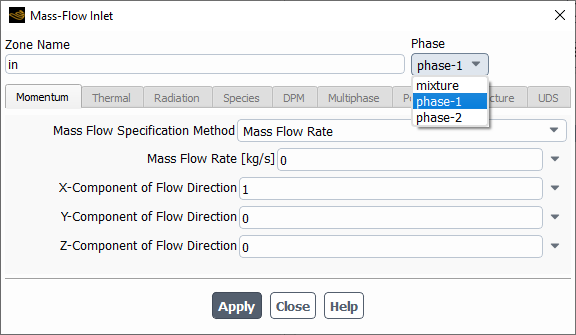

September 17, 2021 at 1:23 pmaitor.amatriain
SubscriberYou can modify it in Boundary Conditions - Phase - name of the phase (on the left side of boundary type and ID).

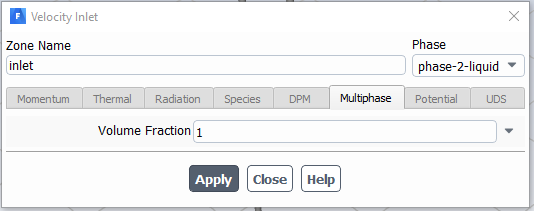

September 17, 2021 at 3:23 pmSeptember 20, 2021 at 11:04 ami.tamunodienye2
SubscriberWhen i use "velocity-inlet" as my inlet boundary condition, the volume fraction is indicated in the multiphase tab of liquid-phase or secondary phase. See blow
However, this is not the case when i use mass-flow inlet as my inlet boundary condition. No volume fraction is indicated as the multiphase tab does not comes up yet the volume fraction of the phases are important to me. Please in this case what do i do.

September 20, 2021 at 12:49 pmRob
Forum ModeratorYou'll need to set the mass flow of each phase rather than the fraction. It's a better solution if you have two phases with very different densities.

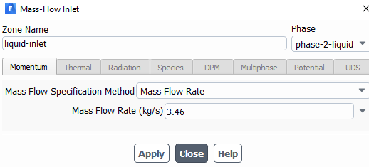

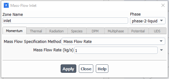

September 23, 2021 at 5:30 pmi.tamunodienye2
SubscriberYes, it is two phase, air(gas) and water(liquid).
Ideal gas is selected from the density drop down menu of the air material.
Water(liquid) density is as given in the material property in fluent (998.2kg/m3)

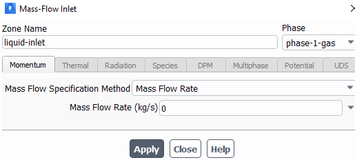

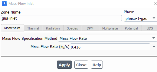

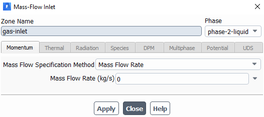

I have set the mass-flow rates as follows for both air(gas) and water.
gas-inlet(mass-flow-inlet)
liquid-inlet
I also want to track the volume fraction based on the set-up shown below. This will help me determine some flow regimes occurring in the domain.
I want to ask which set-up is appropriate if i use mass-flow rate as my inlet BC. Again, could you please help me understand how to set-up the mass fraction and it's usefulness.
Thanks

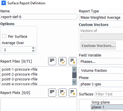

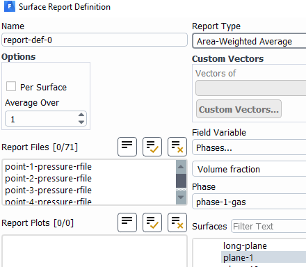

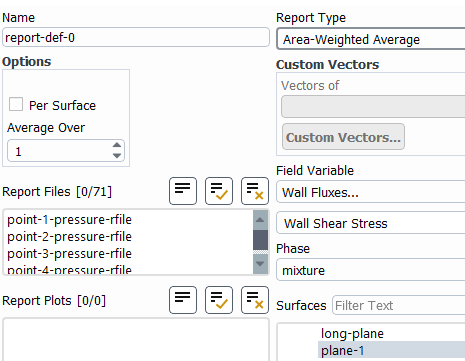

September 24, 2021 at 8:37 ami.tamunodienye2
SubscriberThe figure shows a plane surface monitor.
The set-up is to report the volume fraction of the phase 1-gas.
Since i am using mass flow rate as my BC, i wanted to ask the appropriate report type, whether mass-weighted average or area-weighted average.
September 24, 2021 at 9:53 amRob
Forum ModeratorCheck the maths definitions, I think you want area weighted volume fraction and mass weighted for mass fraction. might remember: I've been giving live training to a Uni group and need a lot more tea....
