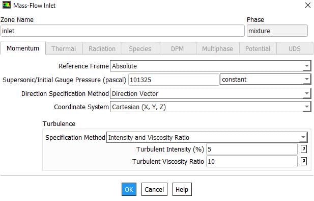

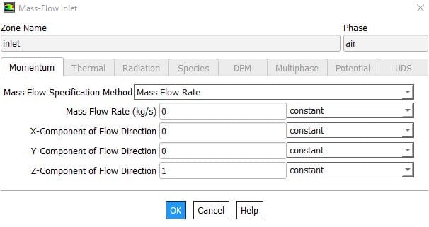

      Hey everyone,

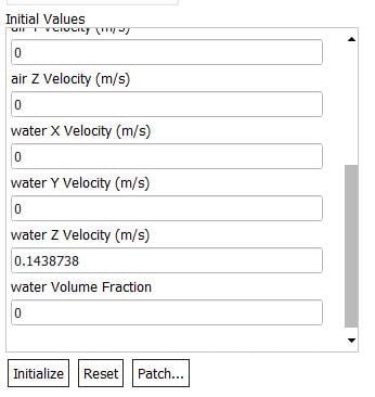

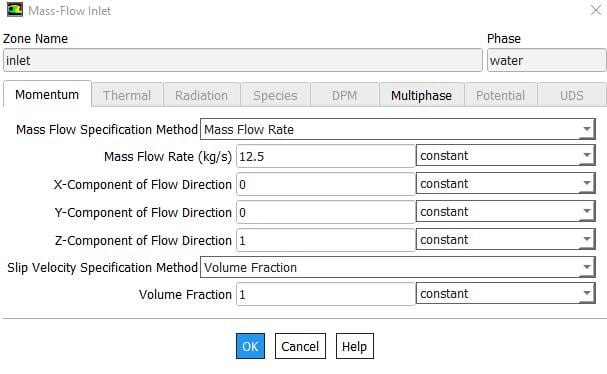

      I'm right now trying to simulate the inflow in a rainwater channel. Therefore I've chosen the Eulerian Multi Fluid model, with air as phase 1, water as phase 2.
      As my boundary condition for the inlet I've chosen a mass flow inlet. I've set 0 kg/s for air and 12.5 kg/s for water with a volume fraction of 1.

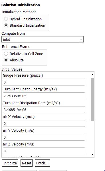

      I've done a initialization from the inlet and the velocity is generated correctly. After the calculation the post-processing shows a mass flow of max 6e-1 kg/s/m2 at the inlet instead of the set 12.5 kg/s (the area is about 0.088 m2, so it should be aroung 143 kg/s/m2).
      Can anyone tell me how this is possible? Is it not possible to choose a mass flow inlet in a VOF model? Or could there be another reason?
      Thanks in advance,
      Regards.
      Daniela

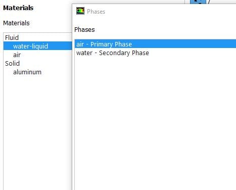

    • DrAmine

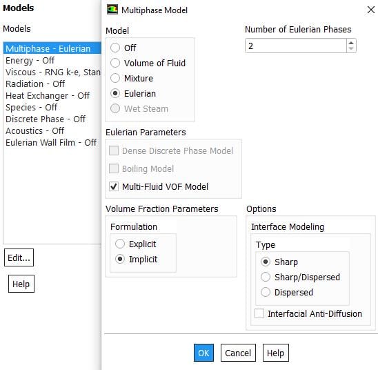

      1/Is it 2D or 3D?
      2/How are you doing the post-processing?
      3/Can you confirm that you are using the Eulerian Model?
      Share screenshots of the models and of the boundary (bulk and phase) and post-processing.

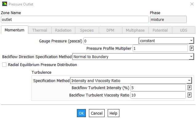

    • Keyur Kanade
      also please share screen shots of outlet boundary conditions, models used, other set up etc.
    • daniela

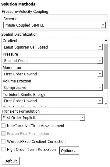

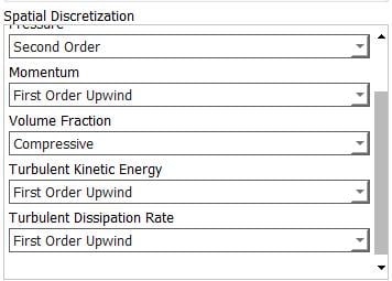

      General set up Models 1Models 2Cell Zone ConditionsBoundary 1Boundary 2Boundary 3Boundary outInitialization1Initialization2PatchPhasesRunPost with CFD Post
    • DrAmine
      What you are now post-processing is just the mass-flux applied at the boundary. You can imagine that Fluent will scale your input of mass-flow at with facets at your inlet so you will see that variation: Fluent divide your 12 kg/s by the water density and total area of inlet to get the normal velocity. What you are now showing is this normal velocity times density divided by the facet area. More important to verify under Report that the mass flow rate for the mixture and water-phase is what you provided as a boundary condition.
    • daniela
      Thanks for the quick response!

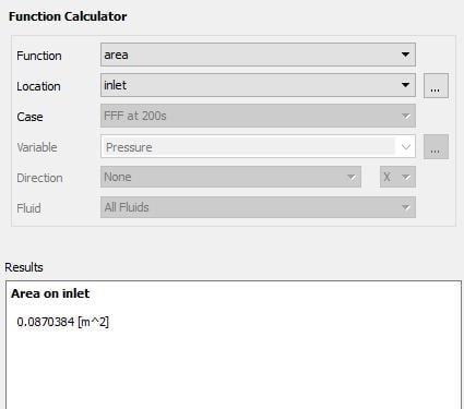

      I think I got the calculation of the flux and flow. But as my area of the inlet is only 0.088 m2, I was thinking of a flux of about 143 kg/s/m2.
      I've attached the report in the bottom, but I didn't see any specifications on the mass flow there.

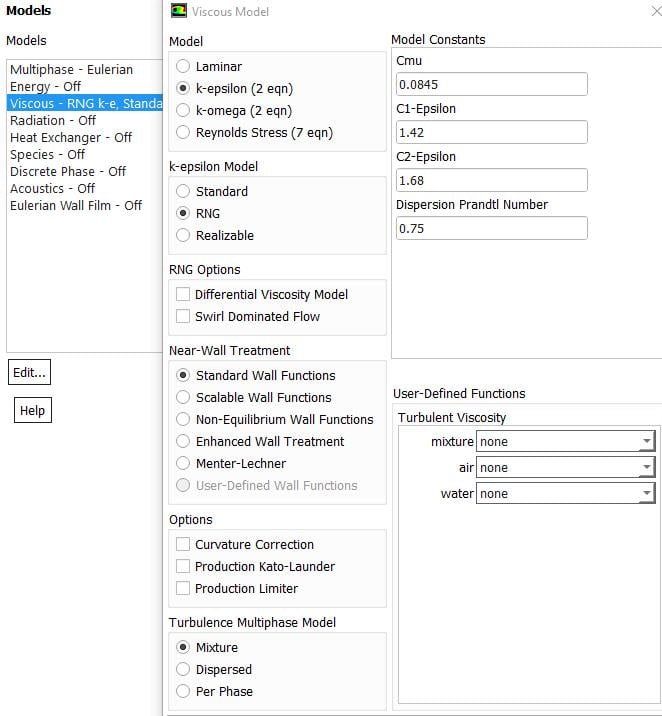

         Time                               Unsteady, 1st-Order Implicit
         Viscous                            RNG k-epsilon turbulence model
         Wall Treatment                     Standard Wall Functions
         RNG Differential Viscosity Model   Disabled
         RNG Swirl Dominated Flow Option    Disabled
         Multiphase k-epsilon Models        Mixture k-epsilon

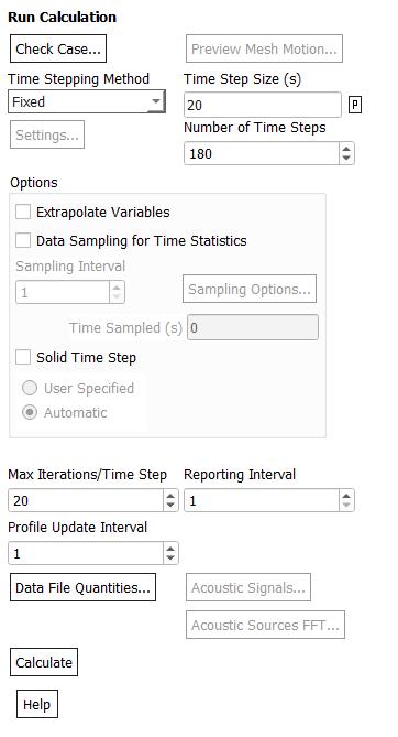

         Unsteady Calculation Parameters
            Time Step (s)                   10
            Max. Iterations Per Time Step   5

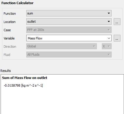

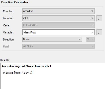

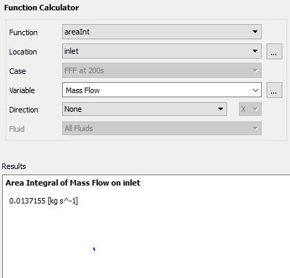

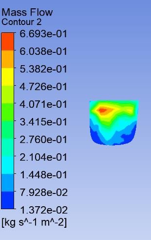

      The flow rates seem to be correct (I've chosen different time steps now).  But the CFD Post is still showing the same for the flux. Is there any possibility to check the surface area in fluent? If I check it in DM it says 0.088 m2. And if I divide 12.5 kg/s by 0.088 m2, it should be 142 kg/s/m2, right?
      Could be that I got this wrong somehow.
      Best regards,
      Daniela

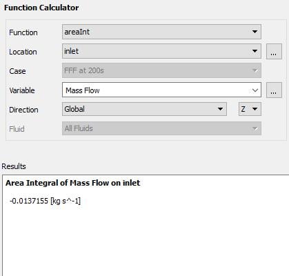

      In Fluent go to the Surface Integrals (Post Processing and/or Reports), one of those gives area.
    • DrAmine
      1/Is the contour plot from CFD-Post? Then please go to Calculators and make an area average of it at your Inlet
      2/Area inf Fluent: Reports>Surface Integral>Choose Area and then your boundary
    • daniela
    • DrAmine
      In CFD-Post make Area Integral of Mass Flow at the inlet. Does it fit your 12 kg/s?
    • daniela
      No, it doesn't fit. Also if I choose global in z direction it's negative.
      Thanks!
      Best regards,
      Daniela
    • DrAmine
      Can you please go back to Fluent and check there 2. In Fluent I am not aware about such a variable called mass flow but with dimension of flux.
      Are you working with *.dat file in CFD-Post or with *.cdat file? Which version are you using?
    • daniela
      In Fluent I can't find the variable mass flow.
      I'm using version 19.2, and for CFD-Post it's *.cdat.
      Best regards,
      Daniela
    • DrAmine
      That is what I've actually said: there is no variable called mass flow in Fluent. That is only what CFD-Post does understand when it comes into calculating mass flow based on mass flow variable. In multi-phase runs CFD-Post will try to calculate the integrated mass-flow (your input) based on that variable (which is kg/m^2s). Please build the sum of the variable "mass flow" in CFD-Post. I would say it would match the 12 kg/s.
    • DrAmine
      There is no benefit for me to post-process this quantity. An integral report is better or getting contour of velocity and if compressible the density on the inlet is more appropriate.
    • daniela
      This fits. Thank you!

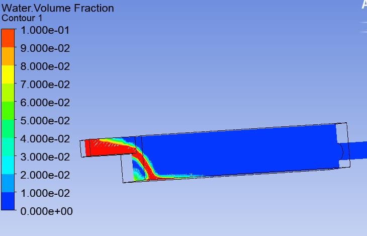

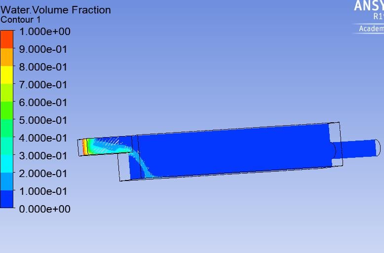

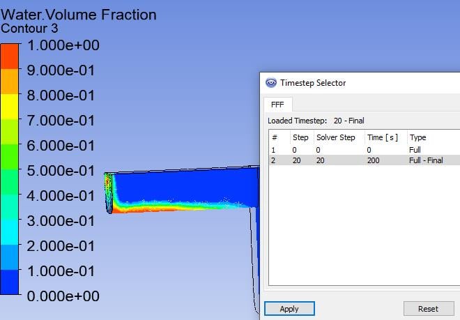

      Then there's another thing I don't understand: If I have 12.5 kg/s of inflow and I did run the calculation for 200 s, how is it possible, that the water only reached the point in the graphics (the canal has a length of 1m, so 0.088 m3). With a inflow of 12.5 kg/s of water it should be 2500 kg (or liter) after 200s, which is way more than the volume of the canal. Might be, that I misunderstand the contour "volume fraction".

    • DrAmine
      Contour might be correct but as we do not have any idea about your model any comments will be only given by suspicion. We require some informations about your Case: Which boundaries are included and where?
      From the plot it looks after a sort of open channel flow (?) where the water flow is sub-critical and that is why the height is decreasing. Check if you have an outlet if water reached that outlet. Moreover post screenshot of Fluent Residuals.
      It might be that water reached a level far away but due to coarse resolution the whole vof field is smeared..
    • daniela
      Basically water is filled in an small open container and it should flow into another bigger container with open surface before getting into a pipeline. To model the open surface I've set atmospheric pressure at the top.
      The big tank has a volume of 2.5 m3, that's why I'm only simulating 200s right now, because I just wanted to see how the water reaches the end of the big container.
      I have already decreased the maximum of the volume fraction contour, but it still doesnt reach the end of the container or the pipe.
      Thanks.
      Best regards,
      Daniela
    • DrAmine

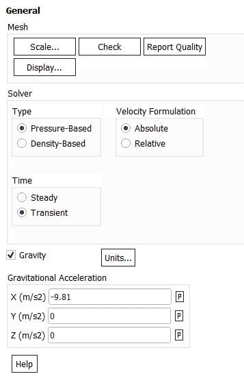

      1/Ensure deep convergence every time step. From residual plot your run is not looking as it should. Share with us settings in FLUENT.
      2/work with FLUENT post processing to avoid any issues.

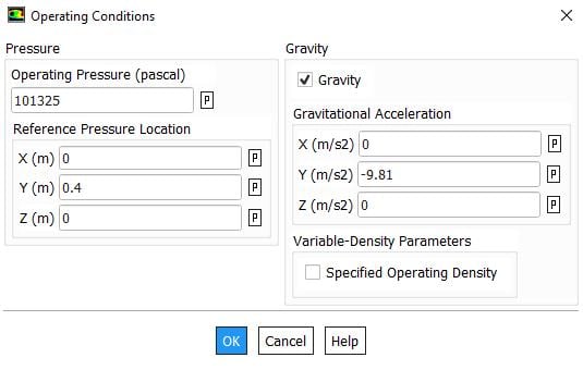

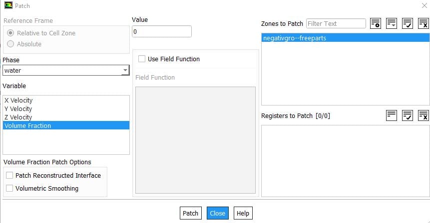

    • DrAmine
      Ensure gravity is set properly and free surface is set as symmetry or free slip wall. Include a air layer above water at inlet in case you want to use pressure boundary at top
    • daniela
      Thanks!
      Is there a way to ensure convergence or do I just have to increase the number of iterations?
      Best regards.
    • DrAmine
      Rather smaller time step size and not more than max. of 20 iterations per time step.
      Post screenshot Of solution methods and operating conditions
    • daniela
    • DrAmine
      Please use VOF model with implicit volume fraction and give thai density as operating density. Eulerian model for this case is too complicated
    • daniela
      Okay.
      Which density should I set as operating density? Water or air?
      Best regards,
      Daniela
    • DrAmine
      Give air as first approximation
    • DrAmine
      Check this
Viewing 28 reply threads
