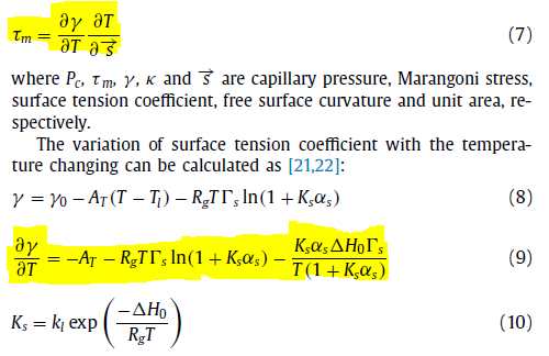

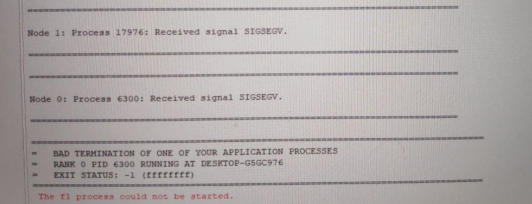

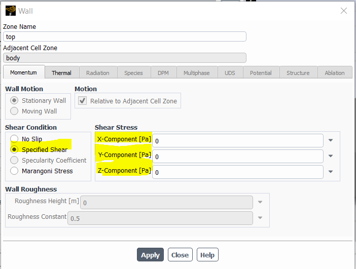

SubscriberDEAR allI want to simulate the laser welding with the FLUENT. I just activate the solidification and melting (without VOF). I face a problem to import the Marangoni effect into my simulation. In the BOUNDARY CONDITION (MARANGONI STRESS), I found the formula for surface tension gradient variation base on the temperature. Since I could not import the surface tension gradient by UDF in the MARANGONI STRESS, I try to import this effect by UDF in the SPECIFIED SHEAR. I attach the formula for this part and shot screen of specified stress.To be honest, I do not know which Macro I should use to write this formula. I try DEFINE_PROPERTY and DEFINE_PROFILE. In my UDF, I consider the surface tension graidient as a constant. Everytime I run this code, Fluent would close. It is very painful. Please help me to find the error of this UDF.Here you can find the UDF that I wrote for this part.DEFINE_PROFILE(marangonix, t, i){face_t f;cell_t c;Thread *tc;real grad_temp, gama_temp;begin_f_loop(f,t){c=F_C0(f,t);tc = THREAD_T0(t);//tc=F_C0_THREAD(f,t);grad_temp= C_T_G(c,tc)[0];gama_temp=-0.00043;F_PROFILE(f,t,i)=gama_temp*grad_temp;}end_f_loop(f,t)}DEFINE_PROFILE(marangoniy, t, i){face_t f;cell_t c;Thread *tc;real grad_temp, gama_temp;begin_f_loop(f,t){c=F_C0(f,t);tc = THREAD_T0(t);//tc=F_C0_THREAD(f,t);grad_temp= C_T_G(c,tc)[1];gama_temp=-0.00043;F_PROFILE(f,t,i)=gama_temp*grad_temp;}end_f_loop(f,t)}DEFINE_PROFILE(marangoniz, t, i){face_t f;cell_t c;Thread *tc;real grad_temp, gama_temp;begin_f_loop(f,t){c=F_C0(f,t);tc = THREAD_T0(t);//tc=F_C0_THREAD(f,t);grad_temp= C_T_G(c,tc)[2];gama_temp=-0.00043;F_PROFILE(f,t,i)=gama_temp*grad_temp;}end_f_loop(f,t)} -

Ansys EmployeeHello,
What is the error message that you are getting? It would be sometimes easier to debug knowing the error message and where to look at.

RK
Ansys EmployeeThis could be a systems related issue, can you please try to run it without UDF to see if the simulation runs fine? We could then narrow down the issue to UDF.

pourya.heidari
SubscriberDear Rahul
I tried it without UDF. It works fine, and the results are reasonable. I am sure that the error is because of the UDF. I can not debug the UDF.

DrAmine
Ansys EmployeeCheck if you can access the temperature gradients first. My question: why are'nt you using the default Marangoni Stress Wall BC?
