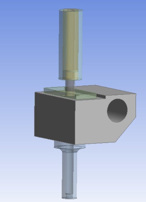

I wanted to investigate a FDM extrusion system. The model I created with DesignModeler, it consists of 9 bodies, 8 solids and 1 fluid streaming/moving through the system.
Then I went on to creat a mesh. I checked all the contacts that were made and named them (they were all correct), used name selection for all important features. Then moved on to the setup portion and I encounter issues that I don't know how to deal with:

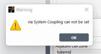

- Does not have a shadow, cannot be displayed either. In other fluent analyses that I have made, the wall could always be displayed and I had never only interfaces.
- And then I cannot use system coupling as a thermal condition either. But this is what I want when the walls are in contact and heat just flows through them.

Forum ModeratorThe walls associated with the interface zones are to account for pairs that don't fully overlap. They aren't visible, and are generally left alone. Interior zones represent the surface between connected cell zone but are also created to contain all of the facets of the cells within a fluid (or solid) zone, again, the latter are left alone.
In your model, none of the parts are connected, and unless you're moving these you may want to look at multibody parts to get a conformal mesh. You'll then have no interface pairs.
