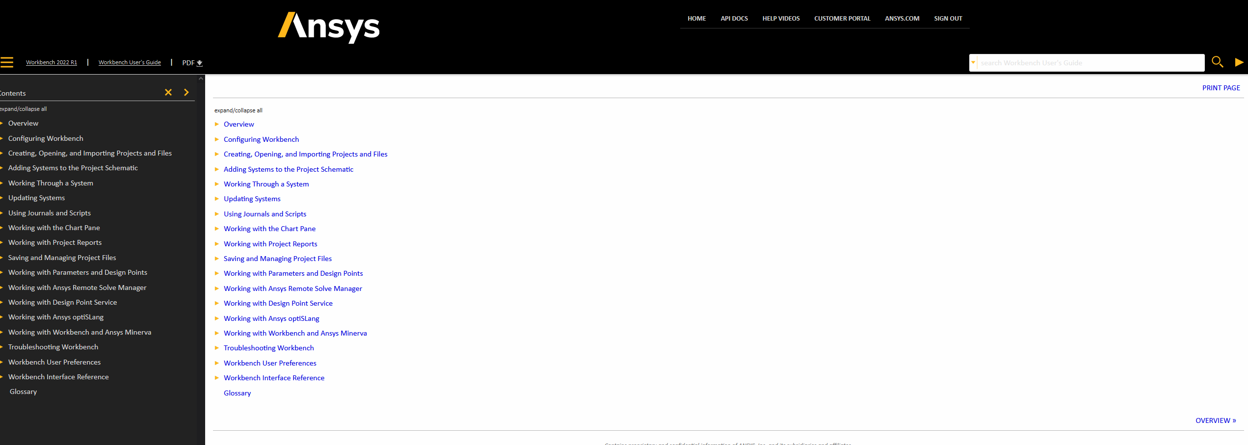

Thanks for replying. The Help documentation that seems to be available on the student version of ANSYS is the html ported version seen here. I have seen some prior theory manuals and help documents which had chapters, but this most current html version does not have that. If I search for 'Nonlinear Adaptivity' there are a mountain of results that just contain those words. I cant really find exactly what I'm looking for this way. Manual rezoning as a search criteria has no results.
April 11, 2022 at 3:46 pmmrife
Ansys EmployeeAh ok good. That is the Ansys Workbench Help and not the Mechanical APDL help...but it's close. Select the Home in the upper right. That should take you to a list of Product/Help. Go to the "M" section and find Mechanical APDL...then from there the path I gave earlier.
Mike
April 11, 2022 at 4:30 pmnds88
SubscriberThanks, I got it now. If I am understanding this correctly, to implement this process in Mechanical, I need to issue a Command in my Solution branch. It's a bit cumbersome to use but I guess I will try to get it working.
