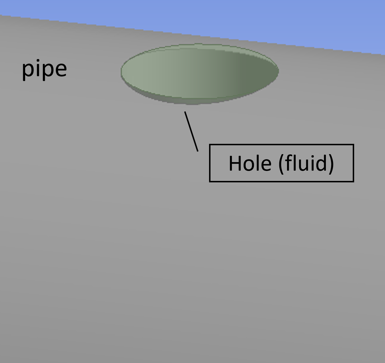

SubscriberI am not sure if I understand the question correctly, but can you please elaborate?
Is the hole on side of a pipe, from where the fluid outlet will be? What issue you are currently facing and what workflow you are currently using to extract the fluid domain?Â

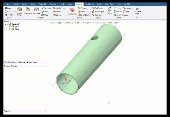

SubscriberThank you so much! That's what I want to know. If you know the way using new desing modeler, please let me know.Â
November 6, 2023 at 6:10 am
Charudatta Bandgar
SubscriberYou should be able to create a circular sketch and pull it to create the outlet geometry, that you can boolean in to the central fluid geometry as well.
November 6, 2023 at 3:47 pm
YH
SubscriberThank you. I could make it.Â
