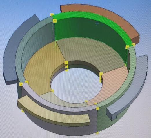

oguzhankose96
SubscriberThe following model may be think of a similar model. All contacs are frictional contact. The selected body in the photo is the area we want to analyze. The rear surface of the overhang is the fixed support. -
September 2, 2019 at 1:28 pm
peteroznewman
SubscriberI don't see an obvious candidate to convert a piece of this geometry into a lumped mass and connect it with a spring to the main body.
I do see a possibility of converting this uniform, thin-walled geometry into a midsurface and using shell elements to greatly improve the solution time.
