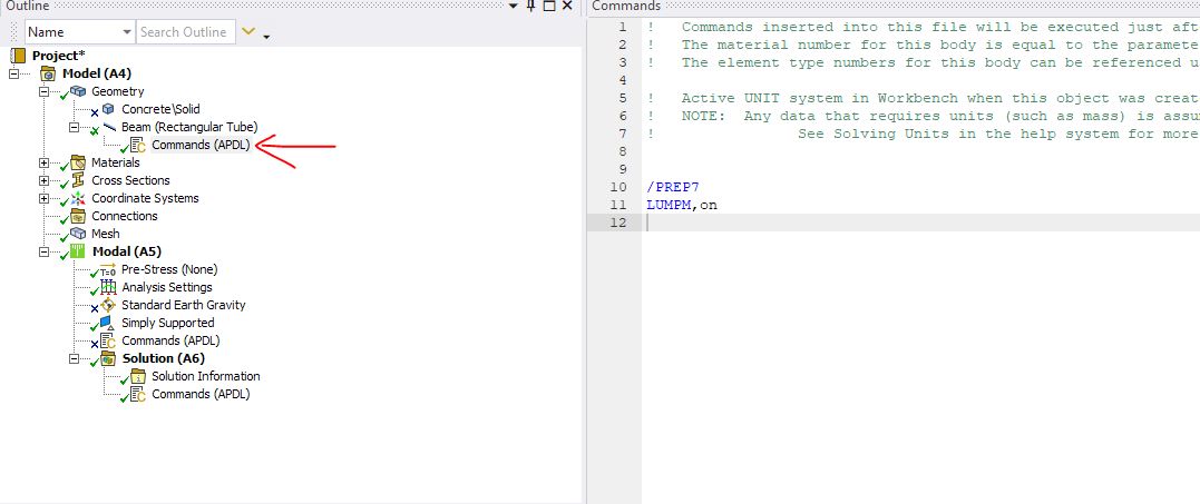

      If you are using MAPDL, you can simply add a new line "/prep7" before "LUMPM, ON". Below is an example:

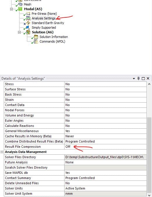

      If you are using Mechanical, below is what you can do:
      Wenlong

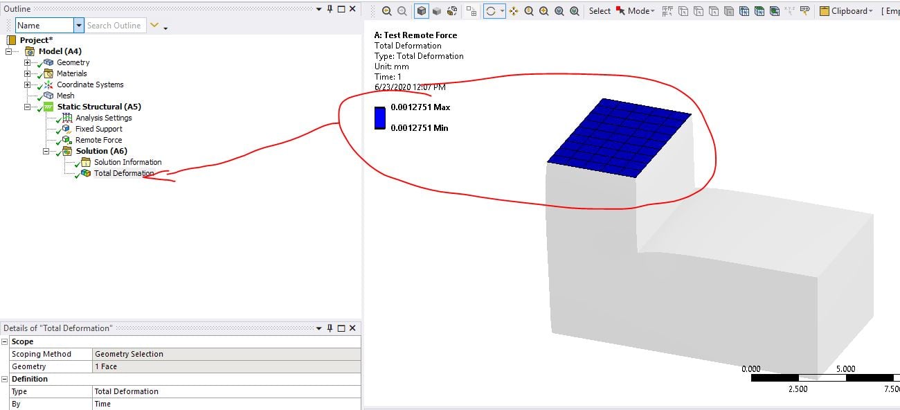

      In this case, you can apply a displacement control to the top face, in this way you will be constraining the nodes on the top face to move for the same amount.
      If you need to apply a force, you can apply a remote force and change the behavior to "coupled" (Ref: https://ansyshelp.ansys.com/account/secured?returnurl=/Views/Secured/corp/v201/en/wb_sim/ds_Geometry_Behavior.html)

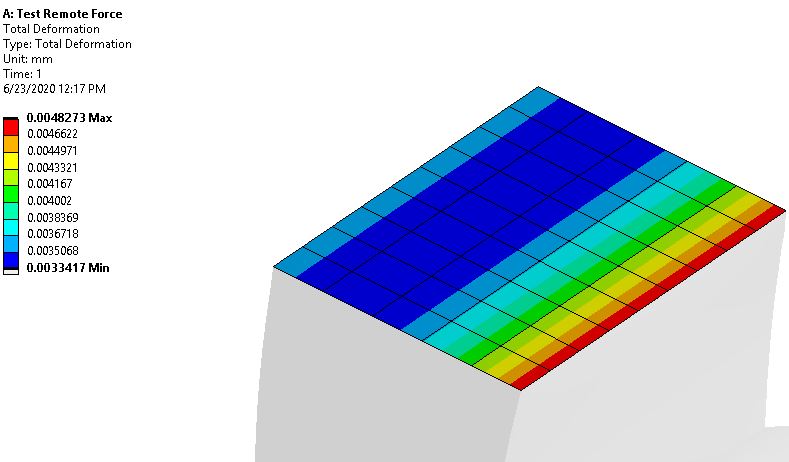

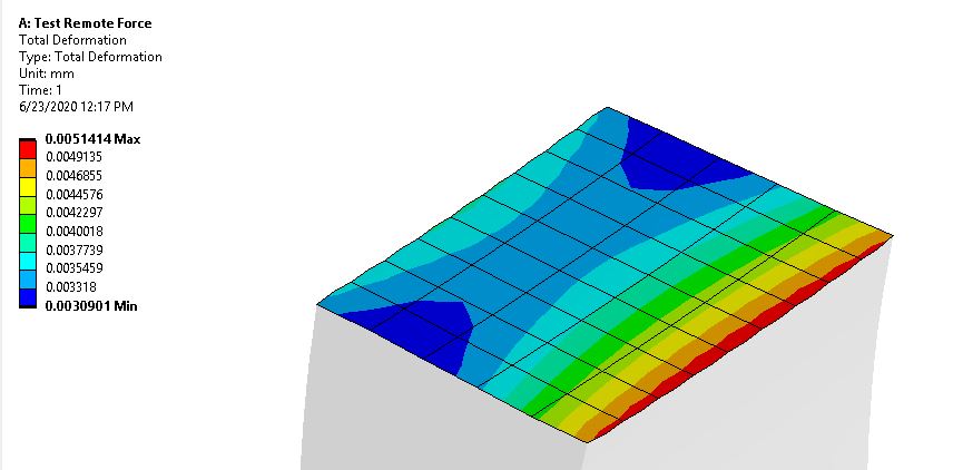

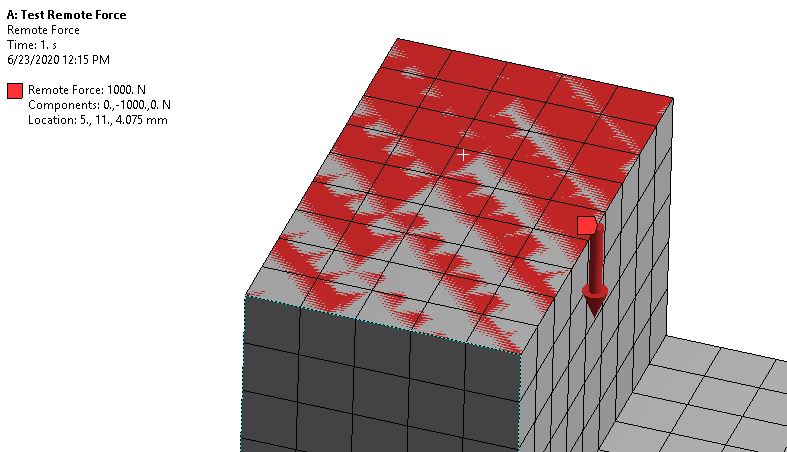

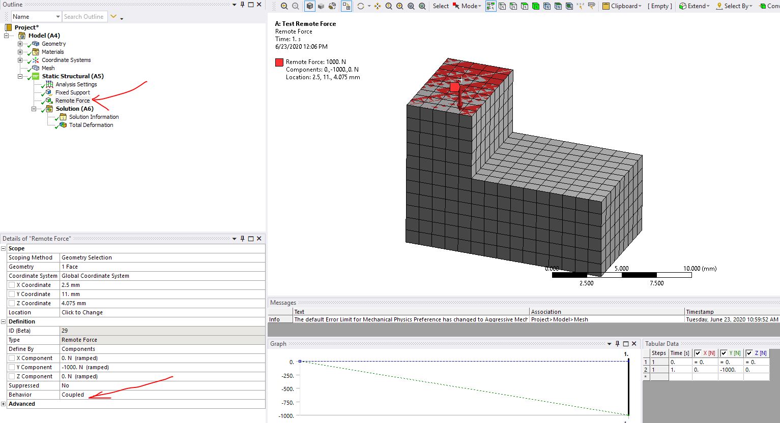

      Let me expand more: For displacement control, you can simply insert a displacement boundary condition to the top face.
      For remote force:
      A Remote Force is equivalent to a regular force load on a face or a force load on an edge, plus some moment.The advantage of using a remote force load is that you can directly specify the location in space from which the force originates.
      Another advantage is you can specify the behavior of the remote force, there are three behaviors "deformable", "rigid", and "coupled.
      To illustrate, we can imagine a remote force applied to a face, the location of the force is not on the center of the face.
      For "Deformable", you can imagine the face as deformable and the area close to the force location will deform more.
      For "rigid", you can image the face as a rigid plate, it will not deform but it will rotate because the force is not applied to the face center.
      For "couple", every point on the face will be applied to the same amount of force. The geometry has the same DOF solution on its underlying nodes as the remote point location
      Below is an illustration wiith behavior "coupled".
