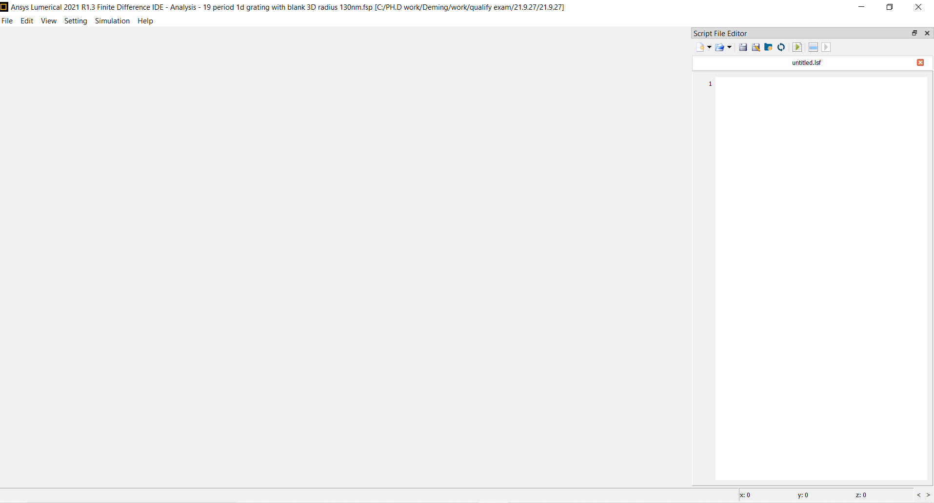

SubscriberI used the lumerical for a long time. Today it suddenly cannot open any files, I did not make any change. When I open the file from the lumerical, it just stucks at this page. Even though I restart the laptop or install the software again, this did not solve this problem. Could you know how to make the softward work again?
September 29, 2021 at 3:21 pmLito
Ansys EmployeeTry to remove the Lumerical product preference.ini files. Step #4 from this post. Otherwise, check your graphics/display drivers, this might have been updated by Windows updates. You might have to update it using the drivers from the manufacturer's website.
