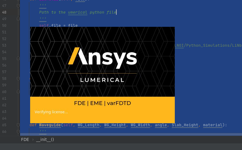

      Hallo,
      i have a problem with Lumerical Python Automations. I was using Lumerical to simulate some MMI and suddenly i get a PyCharm Error, i close PyCharm and start it again and since then when i try to start Lumerical from Python i get stuck on Verifying license... Screen and nothing happend after this. Do anyone know hor to fix this? The OS is Linux CentOS7. And Version of Lumerical is 2021-r1.1. I will attach a photo of the stuck screen. My code to start Lumerica is :
      class FDE:
          #Init Programm
          def __init__(self, file):
              Path to the lumerical python file
              self.file = file
              lumpai = imp.load_source('lumapi', self.file)
              self.lum = lumpai.MODE()
              # self.lum = lumpai.FDTD()
              self.lum.importmaterialdb("......../lib.mdf")
              print('Lumerical FDE API is started')
          #Close Programm
          def Close(self):
              self.lum.close()
              print('Lumerical FDE API is closed")
      Thank you fro your Help.

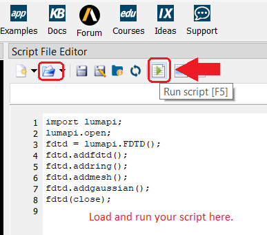

      To troubleshoot the issue — try running the example python script below (lumtest.py) from the Lumerical CAD/GUI using our bundled Python3.
      import lumapi
      fdtd = lumapi.FDTD()
      fdtd.addfdtd()
      fdtd.addring()
      fdtd.addmesh()
      fdtd.save("mytestpy.fsp")
      • martinmi
        @Lito,
        I just tested the example you gave me in the Lumerical CAD/GUI and everything works fine. I also tested accessing the /tmp directory and it is fine. However, the problem is still there. When I try to start Lumerical from PyCharm, I get the screen with "Verifying License"....
        • Lito
          @martin,
          Please try the latest release, Lumerical 2022 R2.1. Otherwise, should the issue persist with PyCharm and Lumerical 2022R2.1, run the API script directly from terminal. >>>https://optics.ansys.com/hc/en-us/articles/5771091294739

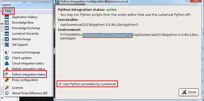

          Try to run the Python API from the CAD/GUI > Script editor window. Otherwise, see this Knowledge Base (KB) to configure your shell environment.
          How to run Lumerical API (Python) scripts in Linux – Ansys Optics
          Note that the KB shows the bash shell environment. Modify your's according to your linux distro and shell. Running scripts will always require a CAD/GUI connection and a GUI license. Ensure that you are connected to your Linux machine via GUI connection.
          Lumerical product components and licensing overview – Ansys Optics
          Remote connection to Linux with a graphical interface – Ansys Optics
