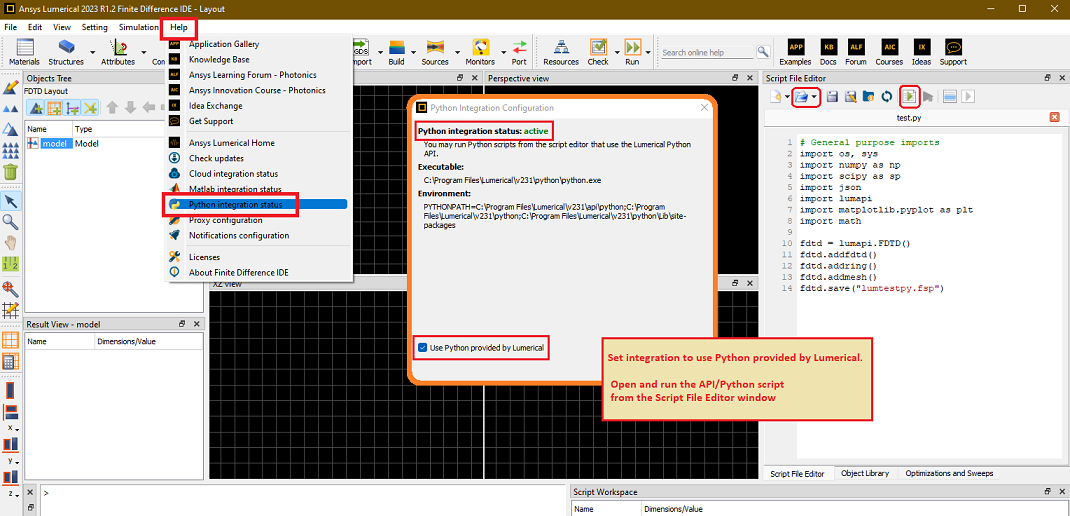

      The Python API applies to all Ansys Lumerical solvers. On windows, simply set the Python integration to use the bundled Python 3 and add the "import lumapi" into your script. Run the Python script.py script from the Script File Editor window as shown in the image below.
      Note: On Linux, it requires the Gnome or Mate terminal when running from the Lumerical CAD/GUI. Otherwise, to run directly from Terminal, see this KB > How to run Lumerical API (Python) scripts in Linux – Ansys Optics.

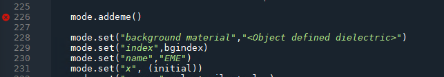

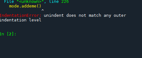

      Hi, Thank you for your response, i understand that. I am running the software in windows and using spyder notebook to code in python. When i use mode.addeme() command , it is not allowing me to run. So I want to know if mode.addeme() is the right command to call EME solver using python, using the setup:

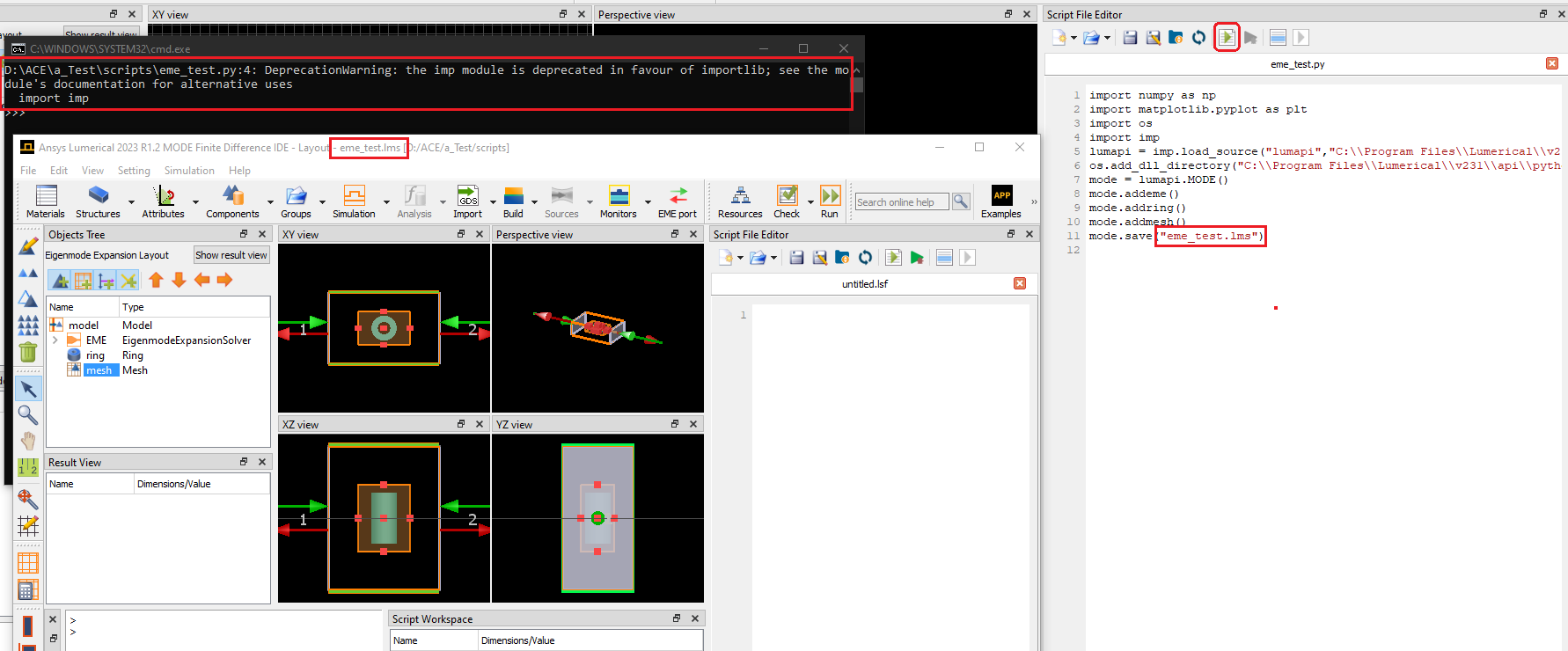

        Try the script below on Spyder notebook. I ran this from the script file editor window in the CAD with Python integration using our bundled Python3. The script should create a new EME simulation file, “eme_test.lms” on your current working directory.

      Thank you, it worked. Apparently , the notebook was showing error at wrong place. Now I am able to run the code.
