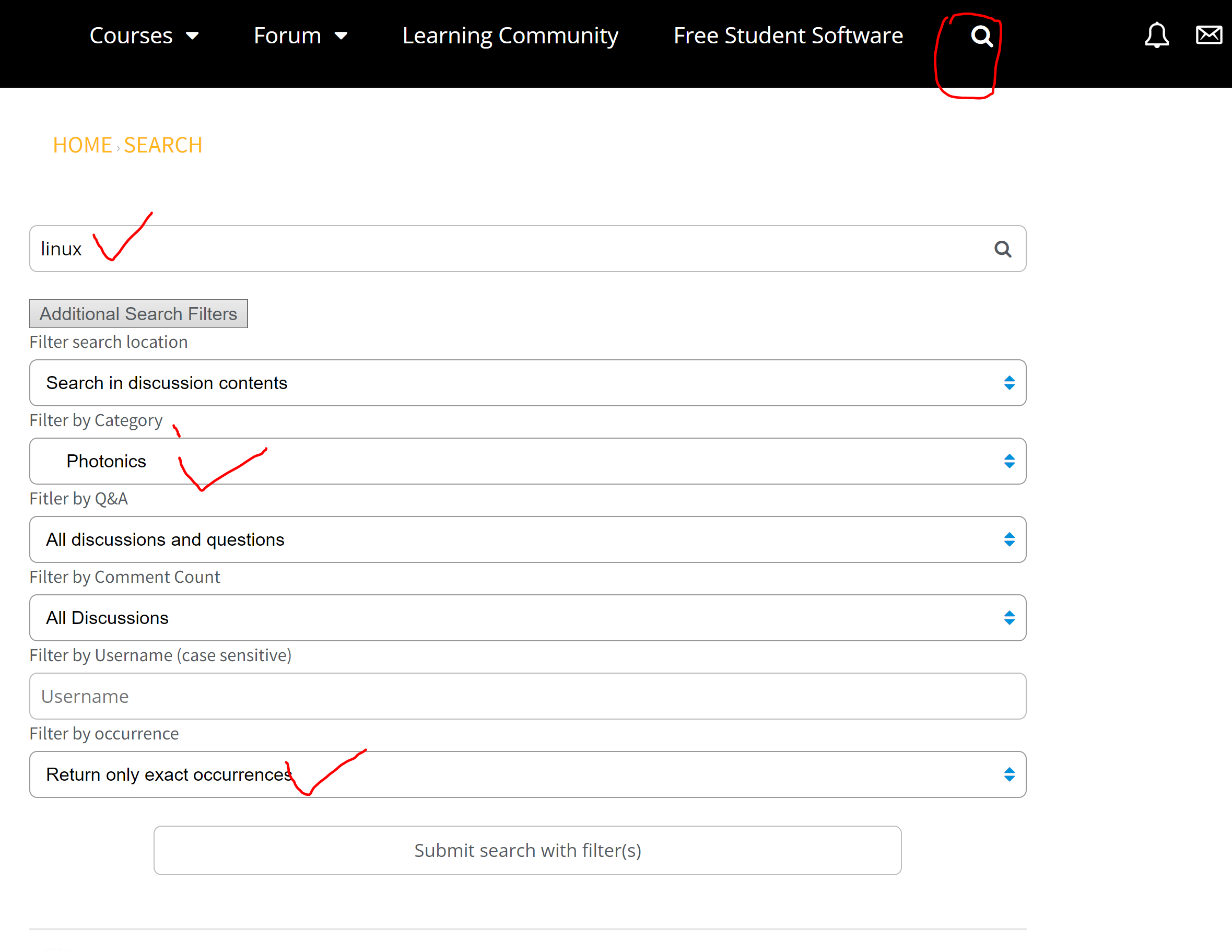

      Some ALF posts may be related to solving issue. For your convenience, please search in this index post: Index of Ansys Insight posts -Single place to search topics written by Ansys-Lumerical Engineers You can use Ctrl^F and search "linux" inside this page. or search the whole Photonics Forum:
