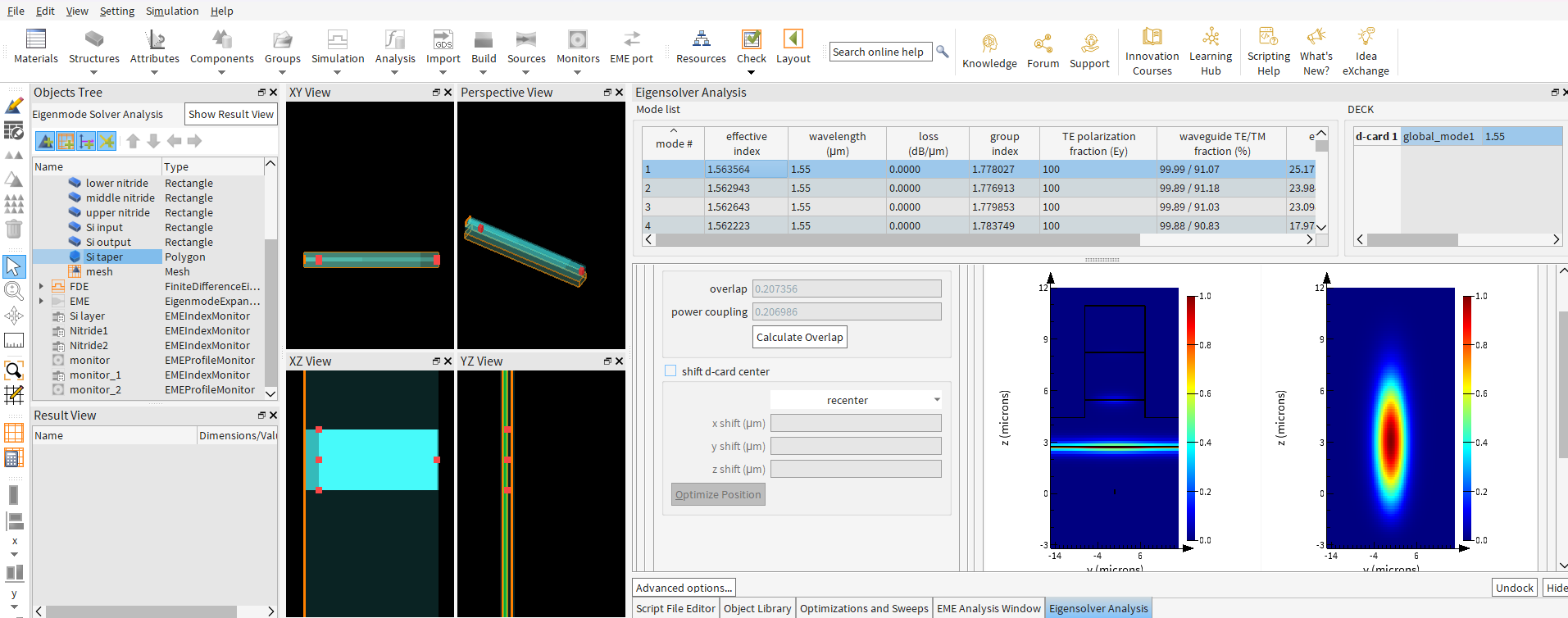

It seems you were not able to find the taper modes as described in the article.
When you open the unmodified file, try searching for the taper modes first, and then for the fiber modes.
Make sure you are able to obtain the results as shown in the screenshot in the article.Best regards,

SubscriberHi Kirill,
I am experiencing the same issue from the unmodified example files. The taper mode shown in the example is not found by the FDE solver, even if the search is performed near n~1.44 and >20 trial modes are used.

Forum ModeratorHi Sarah,
Please start a new thread and include screenshots, along with information about your Lumerical version and your hardware, especially the CPU model.
