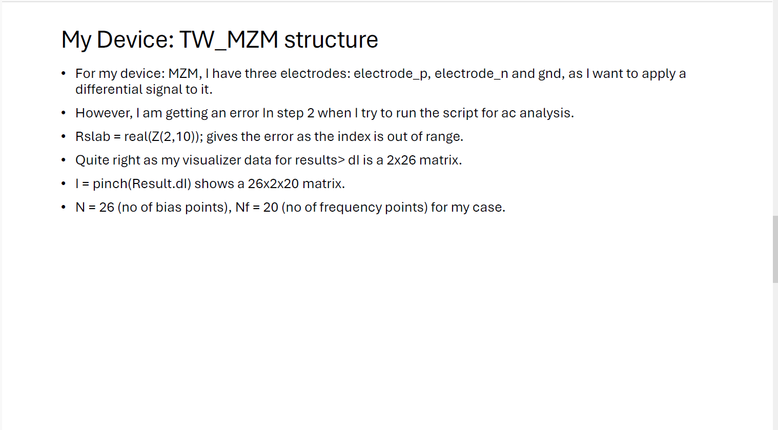

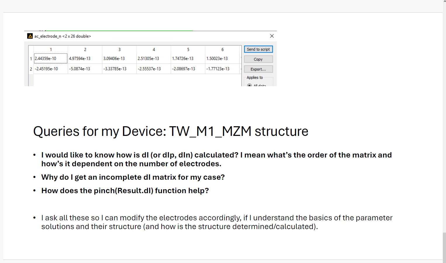

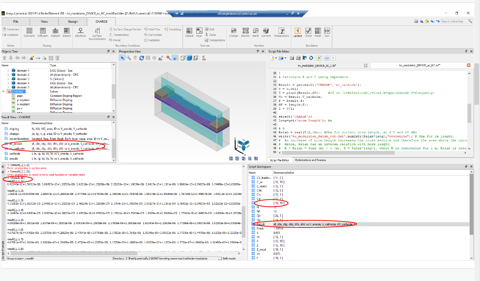

Hope you all are doing good.ÂI am facing an issue with the size of matrices and hence the result while doing a lumerical charge simulation. It would be great if someone could explain to me the following (it's after I define a dc voltage sweep - total 26 points, on one of my electrodes out of three electrodes and I perform a ssac - AC analysis - total of 20 frequency sweep points, and then use the command "run Charge" in the lumerical script:
1. I would like to know how is dI (or dIp, dIn) calculated in Lumerical charge when the it is run for a p-n junction Si MZM modulator? I mean what’s the order of the matrix and how’s it dependent on the number of electrodes?Â2. I have three electrodes. For a simpler case, I am keeping the ac signal on only one electrode, the second electrode is kept at ground (but I intend to use it for differential signalling) and the third electrode is the ground for both the signals, always. I am getting an incomplete dI matrix for my case when I am trying to follow the traveling MZM modulator example by Ansys. I can only see a 2x26 matrix for dI.Â3.How does the I = pinch(Result.dI) function work for my case? I can know this if I can know how lumerical Charge calculates the matrices for dI. I see a 26x2 matrix for I in visualize data but I see it's size in the script results window as 26,2,20.ÂI have been trying to find out the principle of such matrices from the Ansys sources but have been unsuccessful.

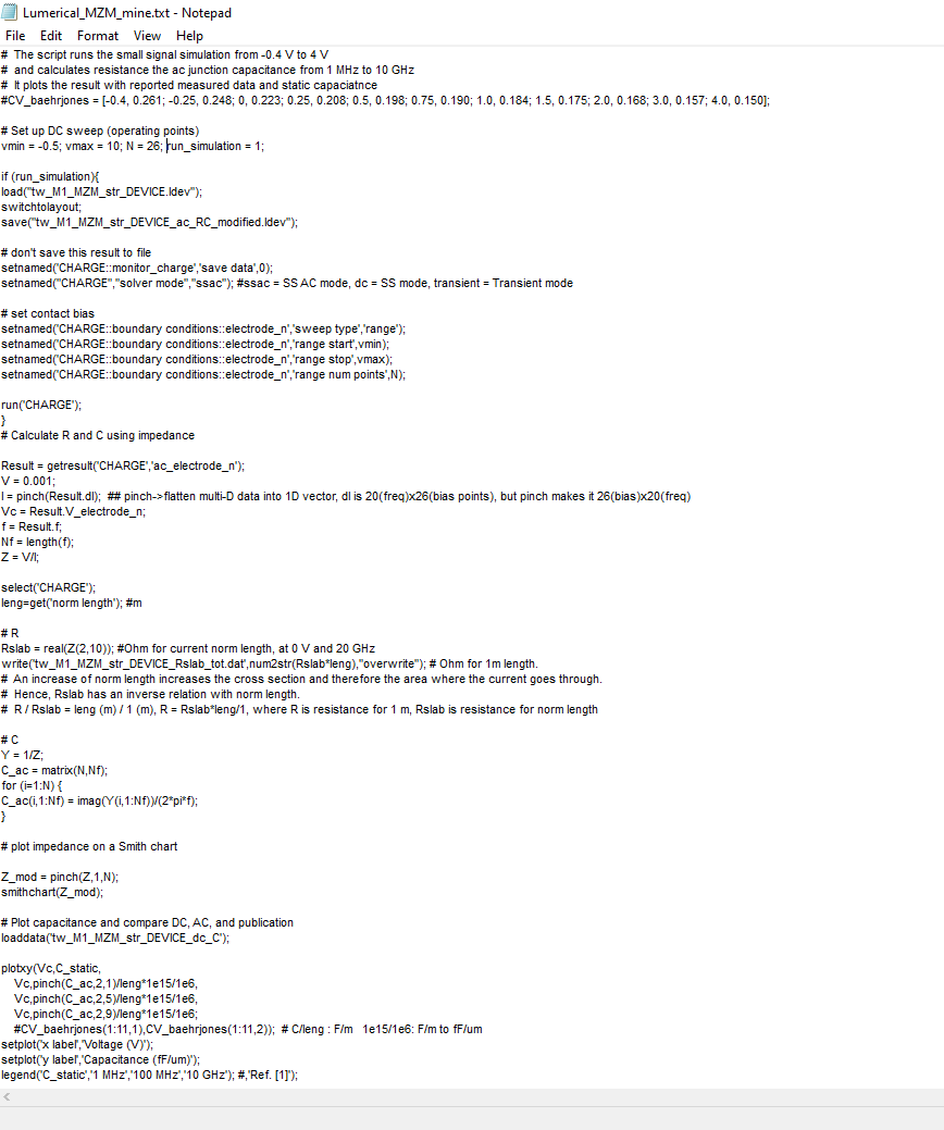

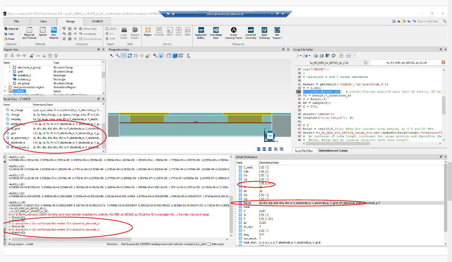

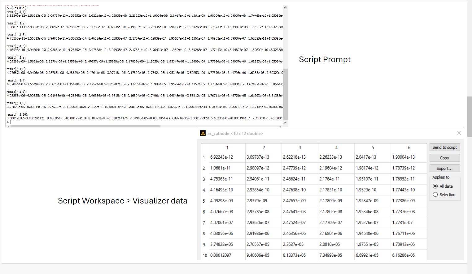

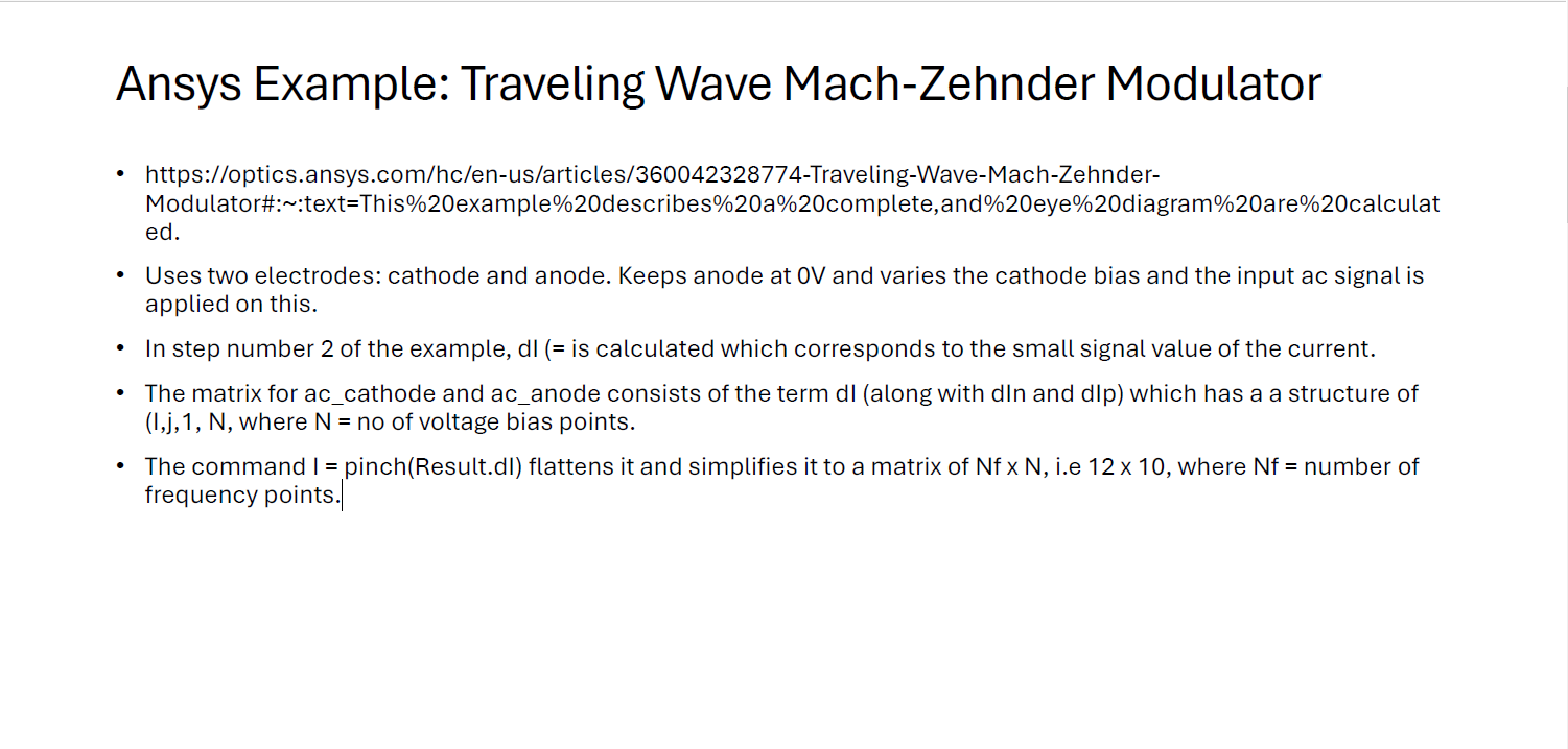

I am sharing images of the ppt of the issues I am facing. The first 3 images are of the Ansys example that I am following, and the rest are for my device and the issue. The last is the code that I am using following the example of MZM modulator. I would like to understand the working fo the calculations or how they are made and stored, so that I can work on them accordingly with more than two electrodes in my simulations.

Sorry for my late response here, dI (and dIn, dip) is the small signal current due to a small signal ac voltage applied to any electrode (whichever boundary condition was enabled for small signal ac calculation). The dimension will depend on your settings. The last dimension is always the frequency points from the small signal settings in the solver. The one before that is for the small signal source voltage. If you enabled small signal analysis for one contact only then this will have a dimension of 1. If you enable small signal analysis for multiple contacts then it will have dimension greater than one and each one will give you result for applying the small signal voltage to each of the enabled contacts. The other dimensions are for the DC voltage values at which you are running the ac analysis for. E.g., if you select "last" bias point only for the analysis then these will have dimension of 1. If you select "all" bias points and are sweeping the DC voltage on that contact then it will have that many points.

Apologies for the late response, and thank you for replying. I have been working on understanding the example and trying to design my own device simulation based on that. There are a number of confusions for me still, so I am reaching out to the Ansys Lumerical team for that. Below are my queries for the moment (as of now for the original Ansys example – https://optics.ansys.com/hc/en-us/articles/360042328774-Traveling-Wave-Mach-Zehnder-Modulator#:~:text=This%20example%20describes%20a%20complete,and%20eye%20diagram%20are%20calculated.):
# set contact bias
setnamed(‘CHARGE::boundaryconditions::cathode’,’sweeptype’,’range’);
setnamed(‘CHARGE::boundary conditions::cathode’,’range start’,vmin);
setnamed(‘CHARGE::boundary conditions::cathode’,’range stop’,vmax);
setnamed(‘CHARGE::boundary conditions::cathode’,’range num points’,N);run(’CHARGE’);}
Query: When the script runs this, are all the parameters evaluated for all the electrodes?# Calculate R and C using impedance
Result = getresult(’CHARGE’, ‘ac_cathode’);V = 0.001;
I = pinch(Result.dI);
Vc = Result.V_cathode;
f = Result.f;Nf = length(f);
Z = V/I;select(’CHARGE’);
leng=get(‘norm length’); #m
Query: When the script runs this, the evaluated parameters are extracted for the electrode: cathode i.e. a particular electrode, right? Now, if I have put more than one electrode in my device, say two electrodes, then why does I contain the values pertaining to the other electrode, i.e as you said I has a matrix as (#DC bias index, #electrodes index, #Frequency index)? The result variable has been used to extract the values for one particular electrode, right? I would be (N, 2, Nf) matrix even though it is evaluated for a particular electrode, so should it not be a (N, 1, Nf) matrix always?Based on the answers to above, I can proceed ahead and better understand the simulation process flow (basically the simulation parameters). I eagerly look forward to your reply.
