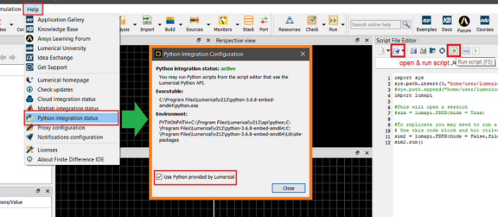

      Do you have a GUI connection to your Linux machine? Our API and scripting environment requires a GUI interface and Gnome or Mate terminal/desktop environment. See the following KB articles for details.

      As a side note, I was able to use the API and run your script from CAD, by first launching the gnome-terminal by using "dbus-launch gnome-terminal", and then from this new terminal window launching the CAD. Launching Python directly from the terminal still gives me the hang as for the other options, only launching from the GUI works. Moreover I tried to reproduce the problem from the CAD by running a script with just "import lumapi", then in the new terminal running "ftdt = lumapi.FDTD()" and pressing CTRL-C while it runs : the terminal window crashes and running a script afterwards work. So I can't reproduce from inside the GUI.

      Are you able to run the sample script I provided from my previous post in the CAD/GUI's script file editor window with the Python API integration set to use the Python bundled by Lumerical 2022 R2.1? This should confirm if you have the API integration working on our machine.
