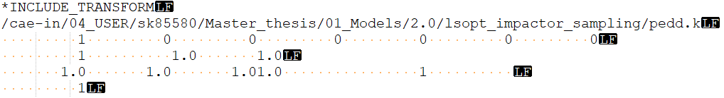

SubscriberI have used a *INCLUDE_TRANSFORMATION card and when I run the -lstasc file it shows me a error that the include file is not read.
The same file when I run with the dyna solver it was able to read the include file and has no errors. The include file has a non-design part.
I also would like to mension that when I load the file I can also see the parts from the *INCLUDE would'nt this mean that it already read the include? and only solver cannot detect the *include?

Ansys EmployeeIt's actually an LS-DYNA error. You are exceeding 80 character limit in the line. Split the path in two lines and add "+" at the end. Not sure how it worked when you ran it outside of ls-tasc, dyna should have returned same error.
*INCLUDE_TRANSFORM
/cae-in/04_USER/......../2.0 +
/lsopt_impactor_sampling/pedd.k

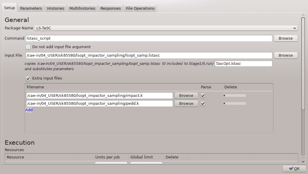

Subscriberwhen I load in the .k file which has the parameters defined, I can find them in lsopt but when I load the .tasc file lsopt cannot identify the parameters.
May 13, 2022 at 3:47 pmigandiko
Ansys EmployeeYou should select .k file as an extra input file for ls-tasc stage and turned on file parsing (parse check box -> on). LS-OPT will not read the file if "parse" is turned off.
May 16, 2022 at 9:34 amMay 16, 2022 at 10:44 amshk1048
SubscriberIt worked when I first imported .k file and turned on parse then imported my main .tasc file. But does't know if this is the way to do it. Because when I reopen the file it tells me that they are added manually.
