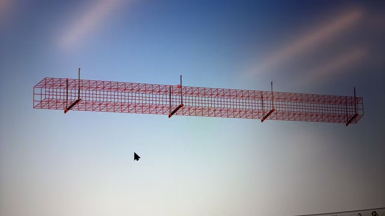

Ansys EmployeeHello, could you please let us know the specific questions you have with ls-dyna/ls-prepost? From the picture, it seems you need to constraint the bracket, apply perhaps gravity load so that the brackets support the weight of the duct and define contact between the duct and brackets. If you are new to ls-dyna, I suggest going through some of the examples at https://www.dynaexamples.com/ or LSDYNA Home.

Subscriber我想知道怎么创建支架 支架是等边角钢 我不知道用什么命令

Subscriber可以告诉我如何定义接触吗
