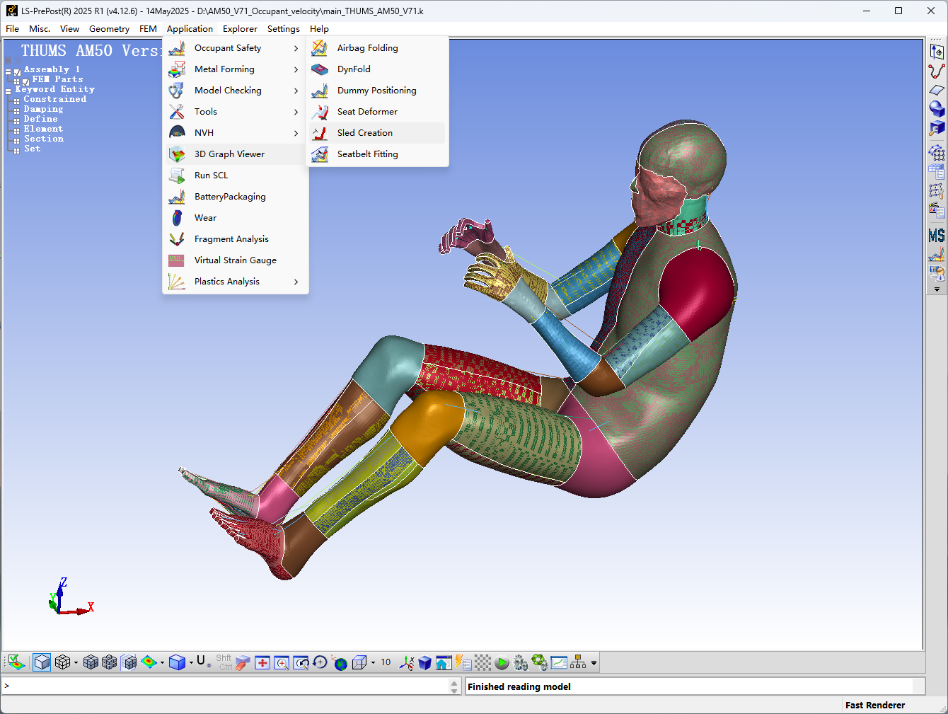

Ansys EmployeeIf I translate your question: "May I ask if ANSYS officially provides a dummy tree file for adjusting the THUMS dummy?"
Could you explain more on this? You can try dummy positioning feature, does it not work for you?

SubscriberNandaThank you for your reply.The dummy positioning function is not working.I'm not sure if I need to import a joint_set.k file or some other file to adjust the pose of the Thums dummy.as far as I know,the THUMS positioning tool in LSPP has been developed 10 years ago and is not currently being improved.In 2022, there was a similar question in the learning forum to mine.The link is as follows:https://innovationspace.ansys.com/forum/forums/topic/thums-position/ -

Ansys EmployeeAfter speaking with our LS-PrePost developers, THUMS has long been discontinued, we are not supporting nor suggesting customers/users to use it. Please consider using any dummy models from here: LSDYNA Dummy Models
