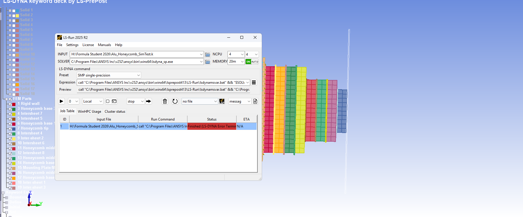

SubscriberI am a Third year engineering student working on an aluminium honeycomb Impact Attenuator for my FS/FSAE team.
For my project within Prepost/Dyna I followed this video:
?si=tv_cjp77mjVnGBDFÂI've done everything up to the point where I need to run my simulations but it gives me an error termination and I don't know what to do.

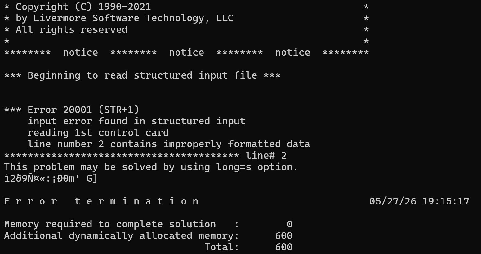

SubscriberHi
Please check if you have blank and extra lines in the deck. If possible please save the model by hitting ctrl+s with in LSPP and close and reopen the model for correcting formatting issues.Â
Cheers, Ram
May 27, 2026 at 8:46 pm
Jaydongordon46
SubscriberI've went and checked and nothing seems to be blank or extra. I retraced my steps yet I see nothing that shouldn't be there or should be there
I ran it again and nothing still.
Same error termination
