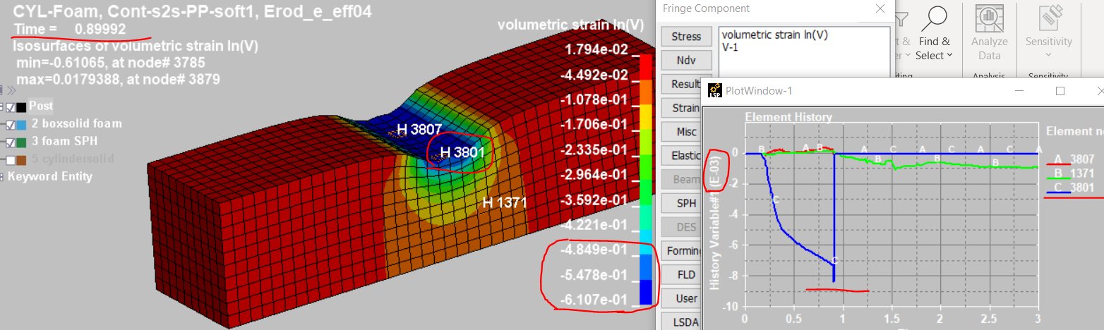

I’m using mat63 Crushable Foam for which lspp generates (fringe 81 mat063;pfringe ) “volumetric strain ln(v)” fringe map, which looks reasonable to me.
I was not able to find lspp GUI way to output the volumetric strain time-history for selected elements. Instead, I tried the “etime 81” command, which produced History Variable #1 graphs.
The issue I’m facing is a significant mismatch between fringe map and element history values (see Figure below).
Please advise on the right way to output history of “volumetric strain ln(v)”.

Ansys EmployeeYou can output history for a particular element using one of the following two approaches:
Post -> History -> Element
First choose the appropriate fringe plot using Post -> Fringe, then use Post -> History -> Scalar to plot the history of that particular fringe
