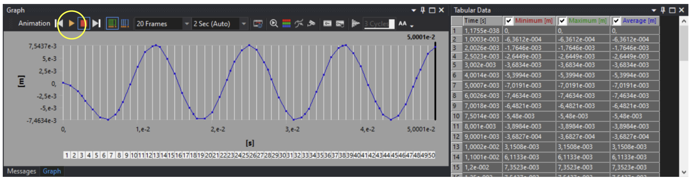

      I’m modeling a transient impulse load on a cantilever beam in ANSYS Mechanical (LS-DYNA). The goal is to apply a 20,000 N load on the free end of the beam for 0.005 seconds, and then release it so that the beam vibrates freely.
      When I perform the same simulation in Explicit Dynamics, the motion looks physically correct, the beam deflects under the short pulse and then oscillates freely around zero displacement.

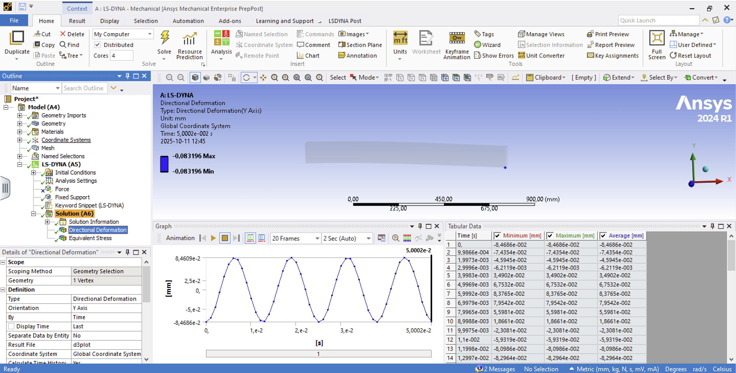

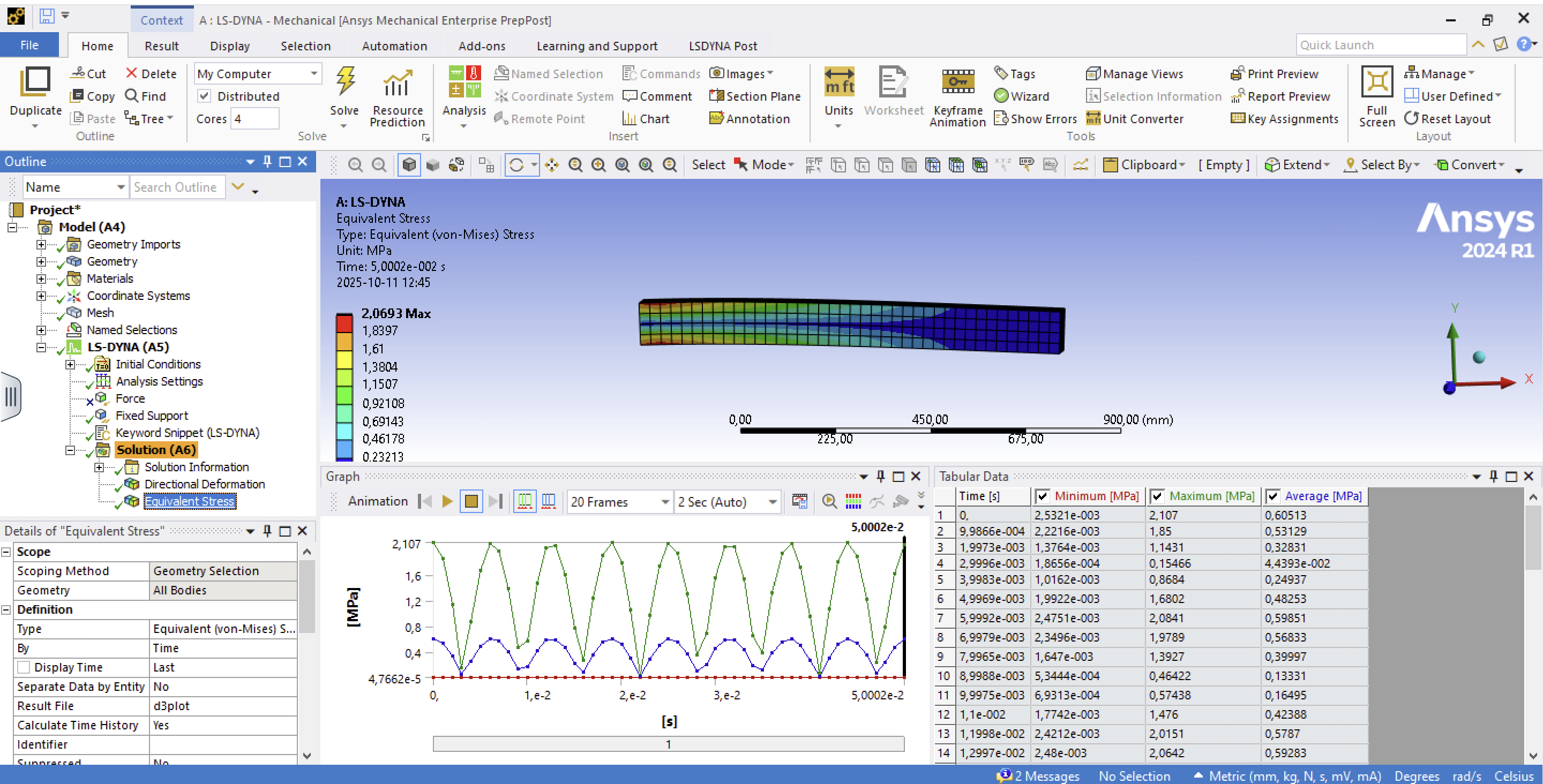

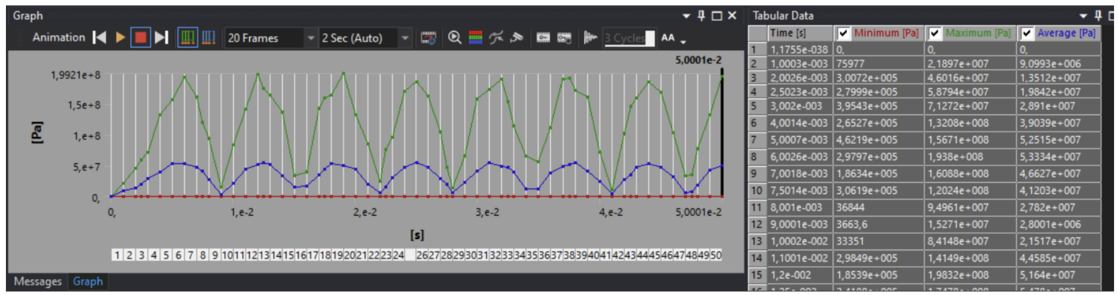

      However, in LS-DYNA, the deformation and stress results differ.
      The amplitude of the oscillation is not consistent with the expected physical response,
      and the displacement does not start at zero even though the loading is transient and begins at time = 0.

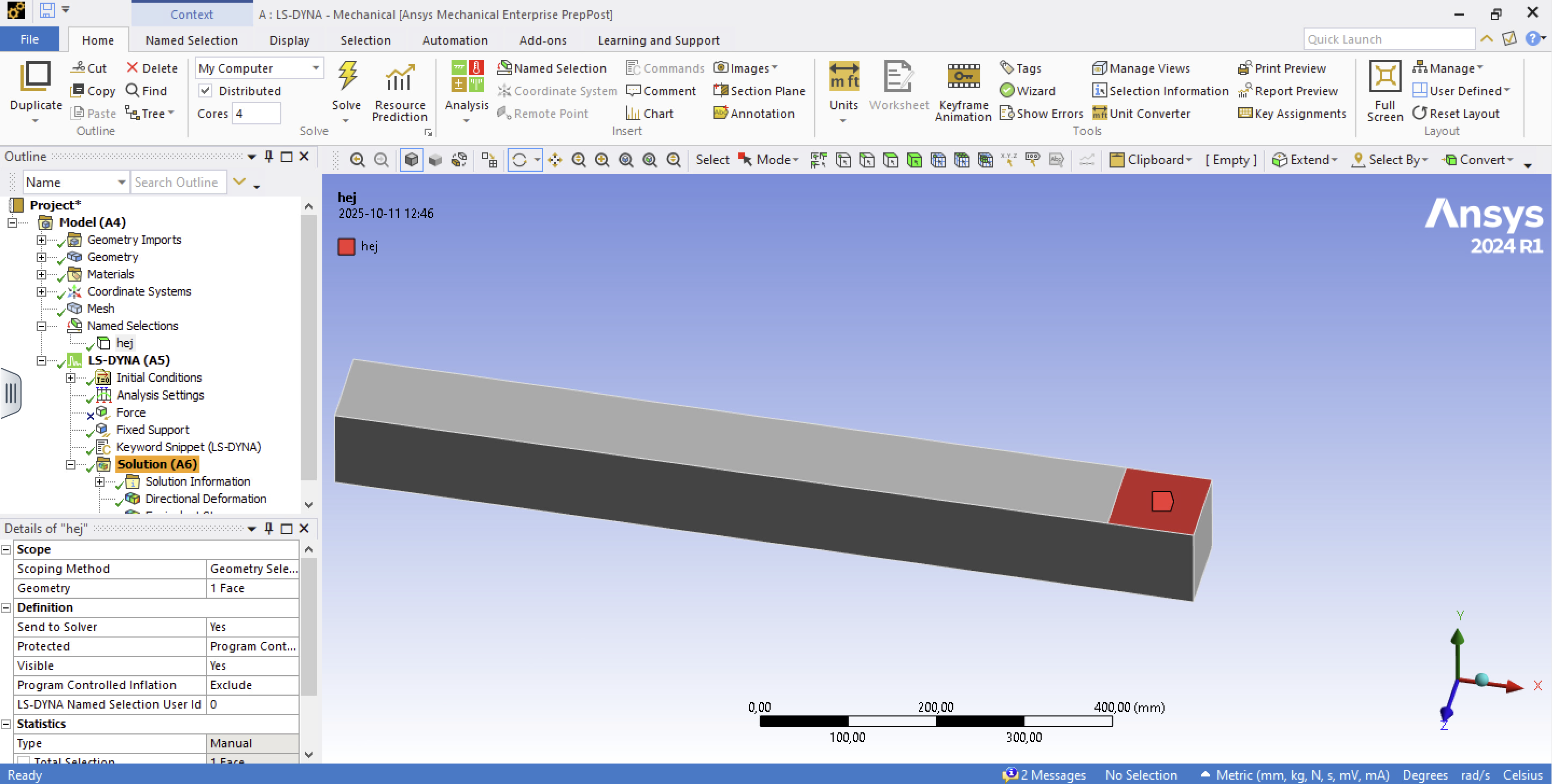

      The loaded surface area is 10,000 mm², so 2.0 N/mm² corresponds to a total load of 20,000 N.
      Named Selection = hej.

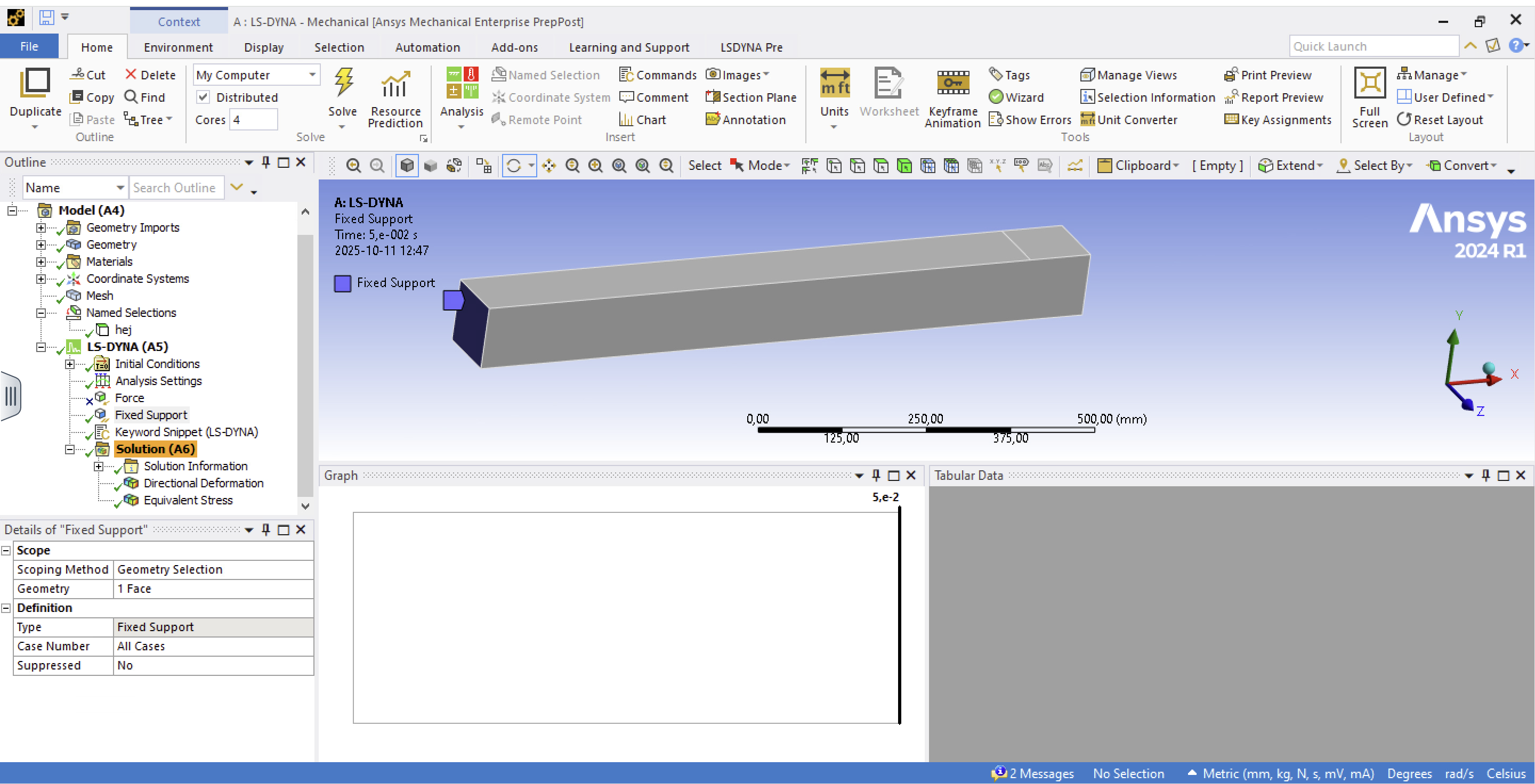

      I will attach:
      • Plots of the expected response (from Explicit Dynamics)
      • Plots of the current LS-DYNA results
      • Pictures of named selection and fixed support
