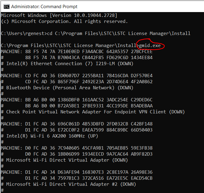

Reno Genest
Ansys EmployeeHello Brian,
If this does not work, you will have to generate the license file in manual mode using the gmid.exe program located in the LSTC license manager installation directory. Here is the procedure:
- Open command prompt as administrator.
- Cd to the gmid.exe directory.
- Run the gmid.exe program:
4. Copy all the output text to a text editor and replace "MACHINE" for "SERVER". Here is the example for my machine:
SERVER: 88 F5 74 7A 7E10E0ED F3A4AC8C 642A5357 27BCFCEE

SERVER: 06 59 77 E1 8AD6FA51 D895E688 4F78F613 194E0D6E
# Â Â Â Â 06 59 77 E1 AE5C4CD1 1B643273 639FA3A8 DD9334FE
# Generic (UP)
# Number of CPUs:12

5. Save the text file as LSTC_SERVER_INFO and send it to your Ansys account manager to cut the key.
Let me know how it goes.
