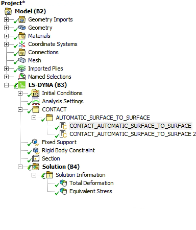

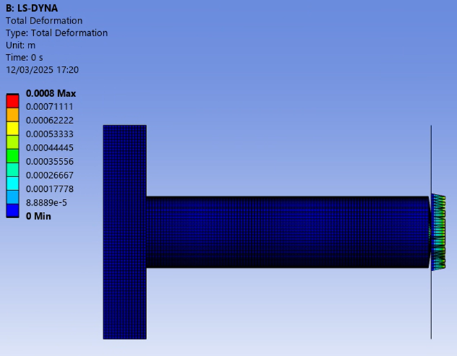

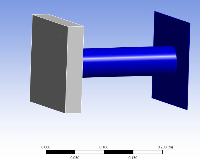

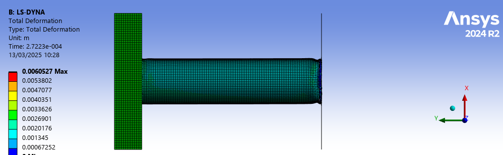

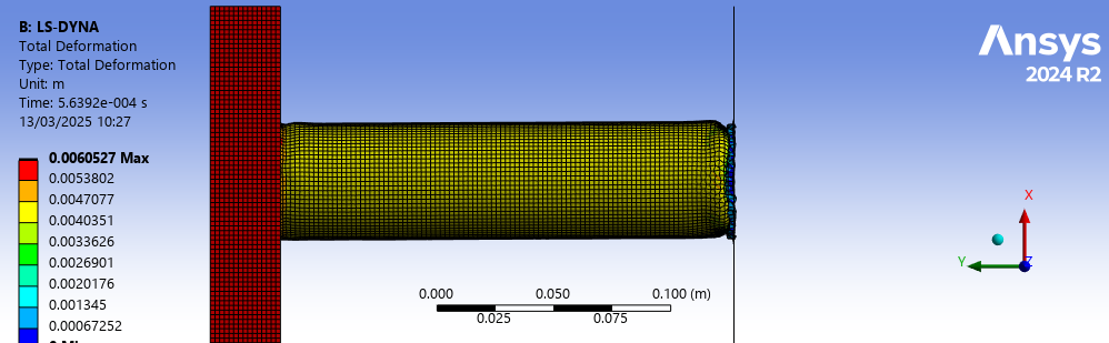

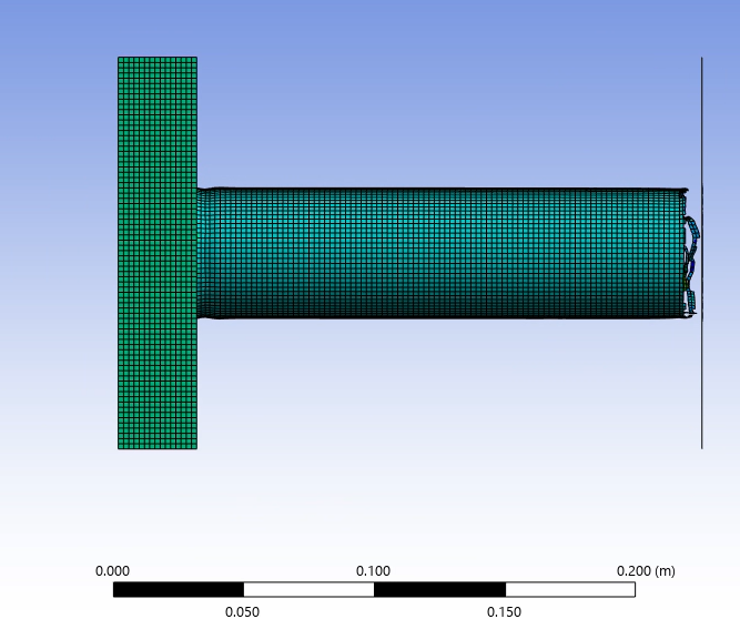

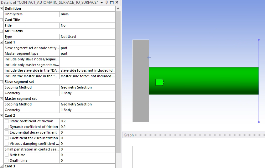

SubscriberHi, I am currently trying to perform a simple composite tube impact simulation in LS-DYNA (through Workbench) where I used ACP to model the composite tube and a mechanical model to model a rigid wall (shell) and rigid impactor. I gave the impactor an initial velocity and the wall a rigid constraint. In addition I used the keyword manager to define the contacts between wall and tube, and tube and impactor. However, whenever I run the simulation the deformation tracker shows the tube being pushed through the wall. I assumed this to be either a contact definition problem or an error due to initial overlap between the wall and the tube. I tried visualising the wall with the Thickness Shell display option but this does not show overlap. I have added screenshots for clarification.
42 % run:
50% run:
settings:

Ansys EmployeePlease check whether displacement scaling is set to true scale instead of autoscale.

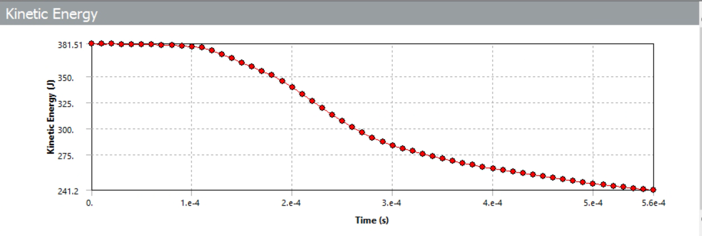

Please share the energy summary curve.
March 13, 2025 at 10:31 am
12OP12
SubscriberThank you for your response. I have added the energy result and I am looking at the results using the true scale.
However, looking at the results, the deformation looks far from being what you expect for a composite tube (almost more like a metal tube being plastically deformed) and the acceleration reaches almost 270g for an impactor moving at 12 m/s (5.3 kg)...

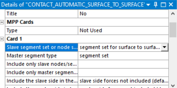

Also, what is the effect of setting the slave segment set and master segment type? Have used both these settings and part/part, results stay strange.

Ansys EmployeeIf you choose segment type, it will generate a segment of select object and use it for contact detection.
If you want to run your model faster, you can try running the case with a higher number of cores. You can also use mass scaling to reduce the simulation.
