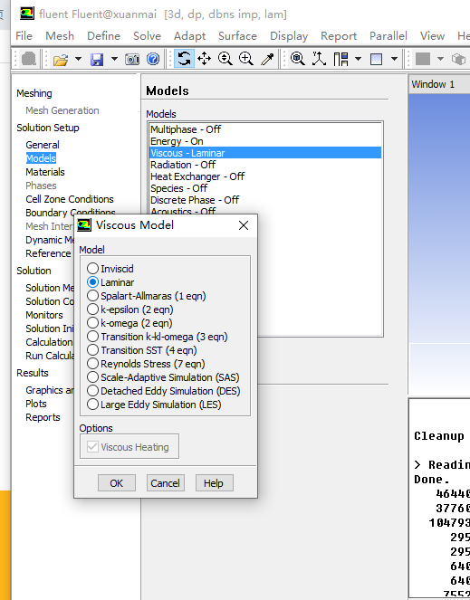

    • zhangdongjie
      Low pressure boundary slip only works in 3D. How can I open this button in 2D?n
      If it's only available in 3d you can't open it in 2d. You could use a 2.5d model, ie 3d but only one cell thick. n

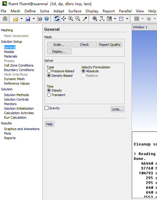

    • zhangdongjie
      Your answer helped me a lot, but when I chose density based instead of pressure based. Low pressure boundary slip disappeared again. How can I get him out?
    • zhangdongjie
      Your answer helped me a lot, but when I chose density based instead of pressure based. Low pressure boundary slip disappeared again. How can I get him out?nn
      See 7.2.3. Slip Boundary Formulation for Low-Pressure Gas Systems in the 2020R2 Theory Guide. n
