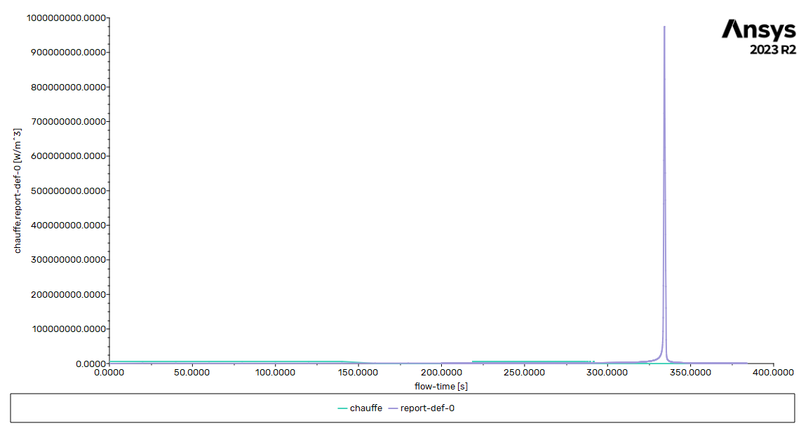

      I'm trying to model a battery during thermal runaway including the combustion of the vented gas. When running a non-reactive model, the thermal abuse model is running fine :
      Heat Generation due to thermal abuse reaction profile :

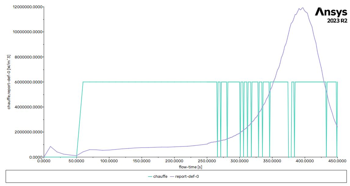

      When adding the partially premixed combustion model, heat generation from the thermal abuse is divided by ~100 :
