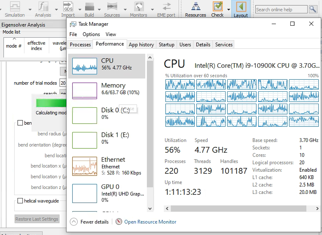

      Hi All
      I recently noticed that my computer was running under a very low CPU usage during emulation. Does anyone know how to get higher CPU usage (maybe closer to 100%)? I guess a higher CPU usage can greatly increase the simulation speed.
    • Lito
      Calculating modes or other computations within the CAD uses the settings from the Design Environment tab in the Resources Configuration. It should automatically detect the number of Cores on your machine and use this to run the calculations. Otherwise, set this to the maximum number of Logical processors/threads on your machine.
      Best Lito
    • cqtavee
      Thanks! It works!
