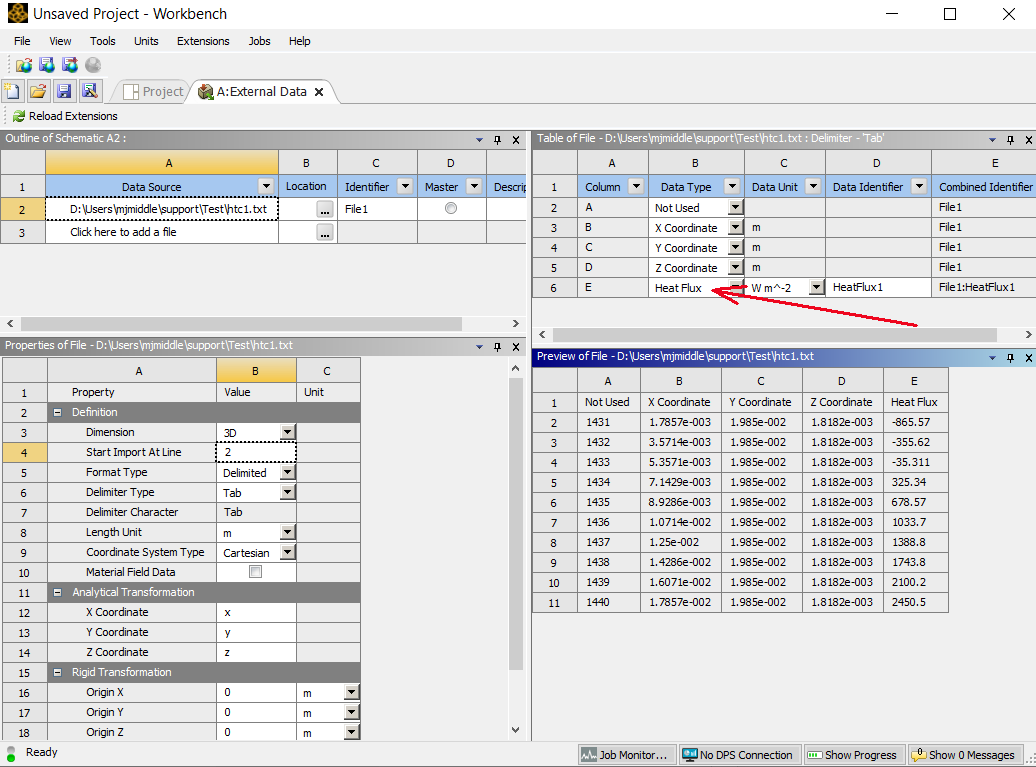

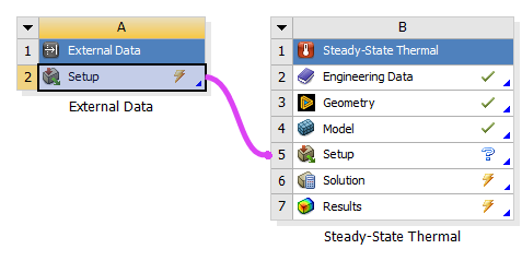

      Better yet, why not use “External Data” to import all the heat flux:
      It must be difficult to know the heat flux at each element number. It’s more typical to know XYZ locations of each heat flux. For each time point, you can use another data file in the same “External Data” system and click in the “master” for one. Or just append another column of heat flux data to all one file. Each column would be the heat flux values for another time point.

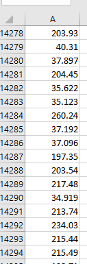

      1) The heat flux data that I need to use comes from an algorithm (not developed by me) that determines the heat flux per element of the mesh per time step, which results in 144 .csv files (one for each 10 min time step) with ~20k rows each (This seems like a good indicator for using External Data, too). This csv is basically one column with the flux values

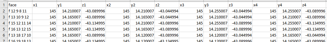

      2)  I also have a .csv file that helps me keep track of what are the coordinates of each face's nodes. The row order is the same as the .csv's in 1) That file looks like this:
      Now, going back to my script, essentially what I do is sweep through various named selections via mechanical API (roof faces, wall faces, etc) and find the corresponding rows in the .csv from 2). So, after some work, I end up with a json like this:

      Yes, I think External Data is the best choice to apply the heat flux.
      I see one heat flux value for each row containing 4 node xyz locations in your data. How are you applying the one heat flux value for the 4 corner node locations? Are you applying this same value at each corner node location? This would conflict with the one heat flux value of an adjacent element applied at its 4 corner nodes, 2 of which are shared by the previous mentioned element. You would have to compute centroid of each of these 4 node locations in order to apply the heat flux at the centroid, The face centroid is the location that the heat flux is applied when using External Data import. So expecting that the values are applied at the node locations, when they are actually applied to element centroid locations is probably why you have some descrepancy between the two methods.

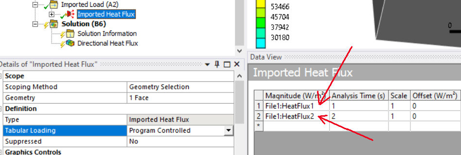

      You can select 144 csv files for the external data if you want but since your python script controls the output of the data at each 10 sec interval why not just open the data file in append mode: open(file, ‘a’) and just write to one csv file?

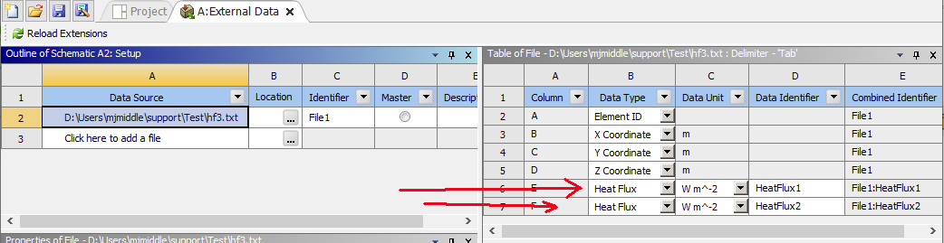

      I guess it would be hard to add columns instead of rows, but I think you can use the python csv module to do that. Or you can just save all the data to a large dictonary while your script is running for all time points, then at the end write it all out to one file in the format you want, having each column be a time point. This way you can use only one csv file. You would have multiple rows assigned as heat flux in the external data:
      Then in Mechanical You have to “add row” to the table and set each row ID:
