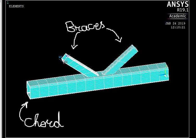

      I am analyzing a rectangular hollow steel section. When I draw the load displacement curve, the load keeps increasing always unless the curve becomes smooth and parallel to x-axis rather than the curve going down after reaching ultimate load. What can be the problem?
      Please insert images of your model, the geometry, the material data, the support, the load and the results graph.
    • Ahmad Abubakar
      This is rectangular hollow section model with K joint. All the ends of braces are constrained except one brace loaded axially in compression with displacement loads.
      E= 210 GPa
      poissions ratio= 0.3
      Displacement load = 100 mm

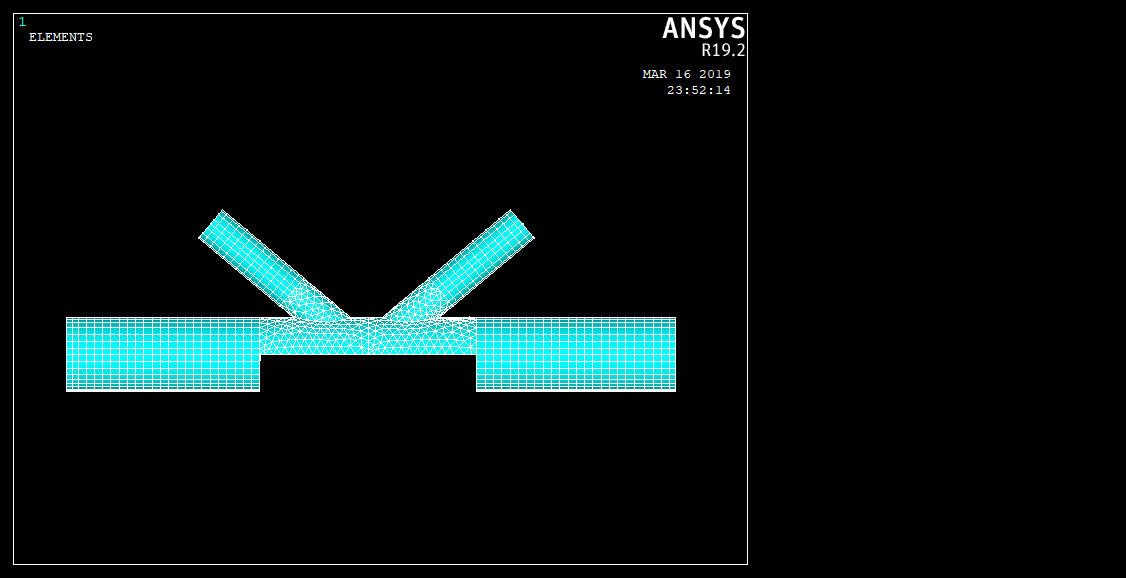

    • Vitaliy Degtyarev
      Hello Ahmad,
      How do apply the load to your model? Generally, a descending branch can be obtained if the model is loaded by imposed displacements (not forces) applied in small increments. The load-displacement curve becomes the reaction-displacement curve in this case.
    • Ahmad Abubakar
      Yeah I applied displacement loads but no negative slope experienced.
    • Vitaliy Degtyarev
      You may try to add steps/substeps to apply the displacements in smaller increments. If you upload your model I could look into it.
    • Ahmad Abubakar
      I've tried it with various substeps ranging up to 200 but it doesn't help

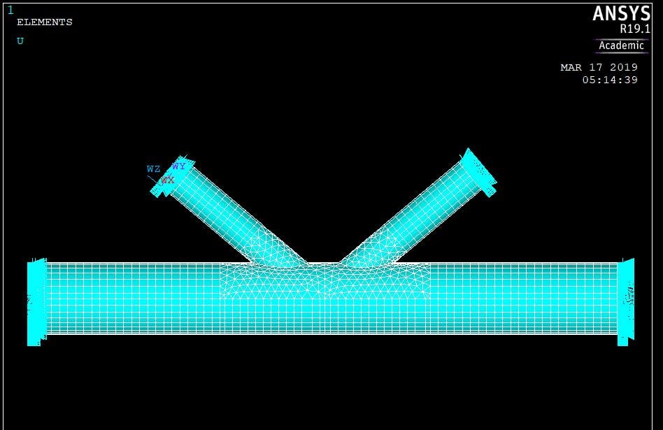

    • Ahmad Abubakar
      Here is the model for circular hollow section.

    • Bhargava Sista
      Ahmad, the multilinear plastic model that you defined does not include any information about the ultimate load. Once the total plastic strain in the material goes beyond the max. value defined in the curve, the solver treats the material as perfectly plastic (stress-strain curve parallel to X-axis). If the objective of your simulation is to check at what point does the structure fail, then look for the displacement at which the max. stress in the structure reaches its ultimate strength.
    • Ahmad Abubakar
      Hey,
      But as for the case of tensile test where the curve experiences negative slope when necking occurs, shouldn't there also be a negative slope for my case when the specimen undergoes large deflection when loaded?
    • Bhargava Sista
      But the curve that you had input does not contain that portion of the material so the model will not record that response.
      A bit of digression but relevant information: when you input the material response note that the deformation should be uniform (same strain throughout the material) which is not the case when necking happens.
      Also, you're performing a static analysis in which case a negative slope is considered as instability and you will run into convergence issues. In your case, you're still able to achieve convergence (I'm assuming you do) as your loading is displacement driven.
    • Vitaliy Degtyarev
      Ahmad,
      When I ran your file, I got some errors; and the model looks as shown below, which does not seem to be correct. Could you double check your model?
      Thanks,
      Vitaliy
    • Ahmad Abubakar
      Hey,
      Thats little strange I just copied the code I posted and by me it runs okay.
    • Vitaliy Degtyarev
      Below is the error message I received. Hopefully, ANSYS people on the forum could help us with this.
      Internal error in the volume Sweeping.  The VSWE command is ignored.
       (Reference: Match 510) Please send the data leading to this operation
       to your technical support provider, as this will allow ANSYS, Inc to
       improve the program.
    • Ahmad Abubakar
       Hey Vitaliy,
      Can you run this code? Its with same material model but with rectangular hollow section and mapped meshing.
      finish
