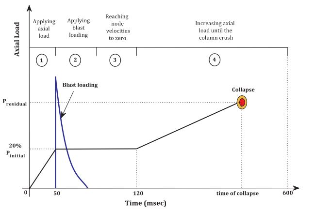

      I have to calculate the axial load carrying capacity of a steel column after getting damaged by blast loading.This has to be done in these steps
      I am working in ANSYS WB 15. Should I perform analysis in explicit dynamics only or other than the blast loading steps in the transient analysis?
      How exactly is the blast load applied to the column?  Is it applied to faces on only one side of the column?   Is it a pressure-time load history?   Is the pressure uniform or does it have a shape along the column?
      How are you modeling the column?  Solids?
      Since the graph is showing 600 ms, it looks like Explicit Dynamics would be a good fit. Do you have an Explicit material for the column that can be eroded by the stress of the blast?

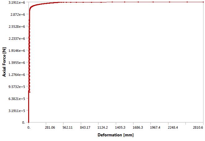

      I have done this analysis in Explicit Dynamics and got the following curve between axial load and deflection. The analysis got stopped by the time around 461 msec (maybe because of the erosion of elements).
      From this graph what value should be taken for the collapse load.
      The workbench file is attached here. Please check the modeling part also because when I changed mesh type to hex-dominant results are quite different.
