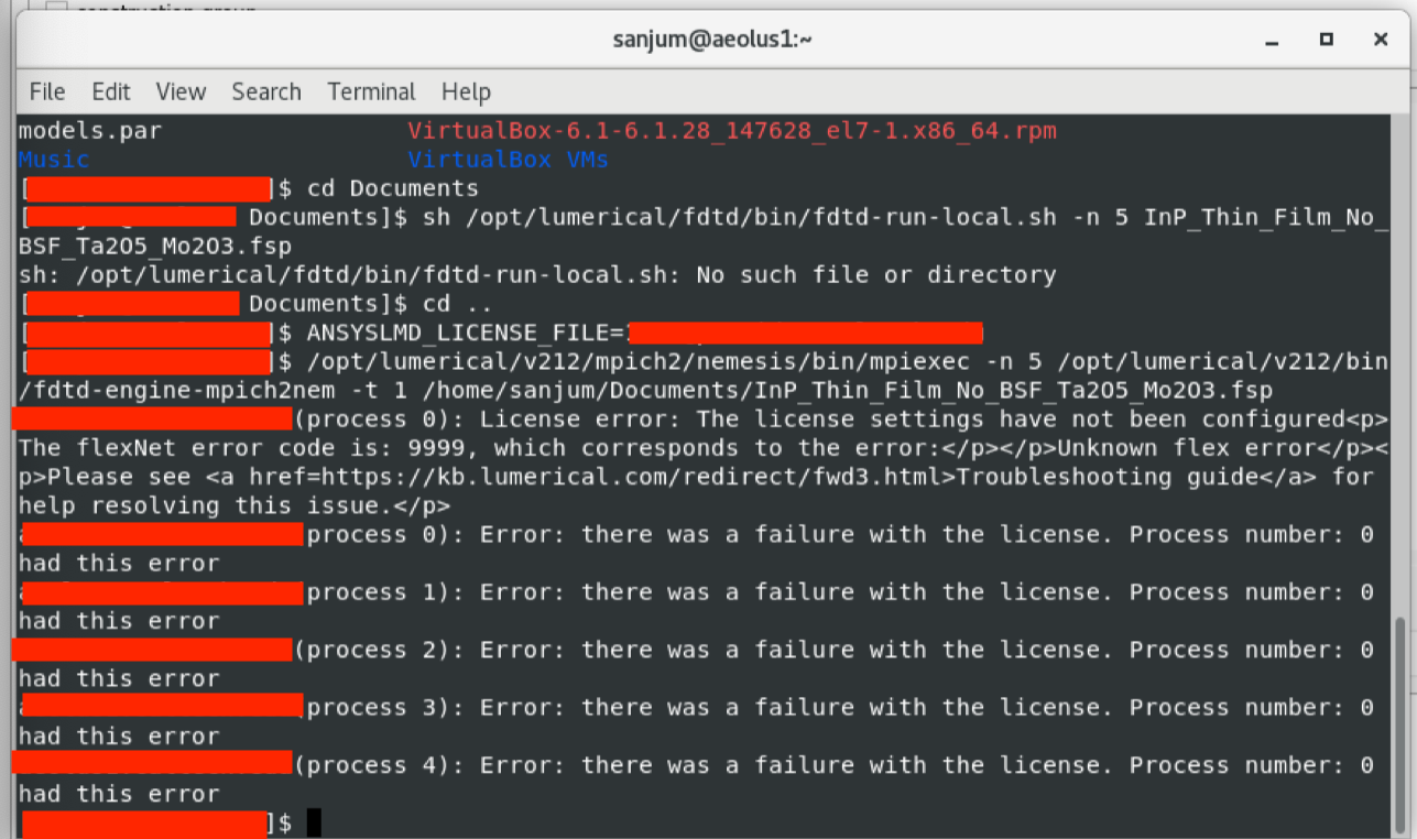

SubscriberI'm trying to run a simulation from the terminal using MPI. I used the following command: /opt/lumerical/v212/mpich2/nemesis/bin/mpiexec -n 5 /opt/lumerical/v212/bin/fdtd-engine-mpich2nem -t 1 /home/sanjum/Documents/InP_Thin_Film_No_BSF_Ta2O5_Mo2O3.fsp
and I got the following error:
aeolus1.caltech.edu(process 0): License error: The license settings have not been configured
The flexNet error code is: 9999, which corresponds to the error:
Unknown flex errorPlease see Troubleshooting" rel="nofollow">https://kb.lumerical.com/redirect/fwd3.html>Troubleshooting guide for help resolving this issue.
aeolus1.caltech.edu(process 0): Error: there was a failure with the license. Process number: 0 had this error
aeolus1.caltech.edu(process 2): Error: there was a failure with the license. Process number: 0 had this error
aeolus1.caltech.edu(process 3): Error: there was a failure with the license. Process number: 0 had this error aeolus1.caltech.edu(process 4): Error: there was a failure with the license. Process number: 0 had this error
aeolus1.caltech.edu(process 1): Error: there was a failure with the license. Process number: 0 had this error
I was able to run this simulation using the GUI, so I do not know what the issue is and am having trouble figuring it out. Please help me figure this out.

SubscriberUpdate: I realized that every time I run this, it changes the configuration from Ansys to Lumerical, but I don't know what the new terminal commands should be.

Ansys EmployeeSee this post on how to set the environment variable in Linux. If you want to temporarily set the variable in your current terminal/shell session run:
export ANSYSLMD_LICENSE_FILE=port#@licenseserver

Ansys EmployeeDo you have a GUI interface/connection on this Linux machine? Are you able to run the simulation from the FDTD CAD? You can open the CAD from the Terminal:
/opt/lumerical/v212/bin/fdtd-solutions
Is this happening to all simulation files? Download and run this example (mwp.fsp) from the Linux machine. Try to check the permission on the files. Ensure that you have read/write access to the files.
