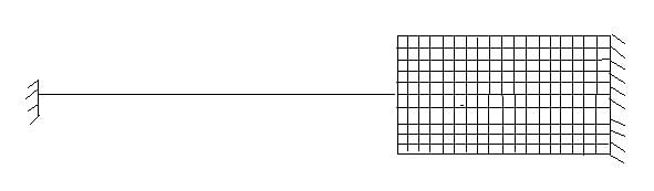

      how can I do this modeling in ansys?, I want to replace a linear beam in a large part of the solid beam to save calculation time and keep the last part of the solid beam that is of my interest.

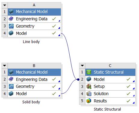

      I decided to make two Mechanical Models, one with a line body, the other with a solid body. You mesh each one individually, then merge those two models into a new Model cell (in a Static Structural system) where you can connect the two meshes, one a beam mesh, the other a solid mesh.

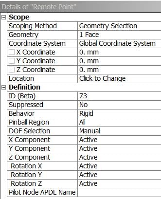

      I created a Remote Point on the end of the solid beam. I activated all the DOF on the remote point.
      Then I created a Fixed Joint between that point and the vertex on the line body.

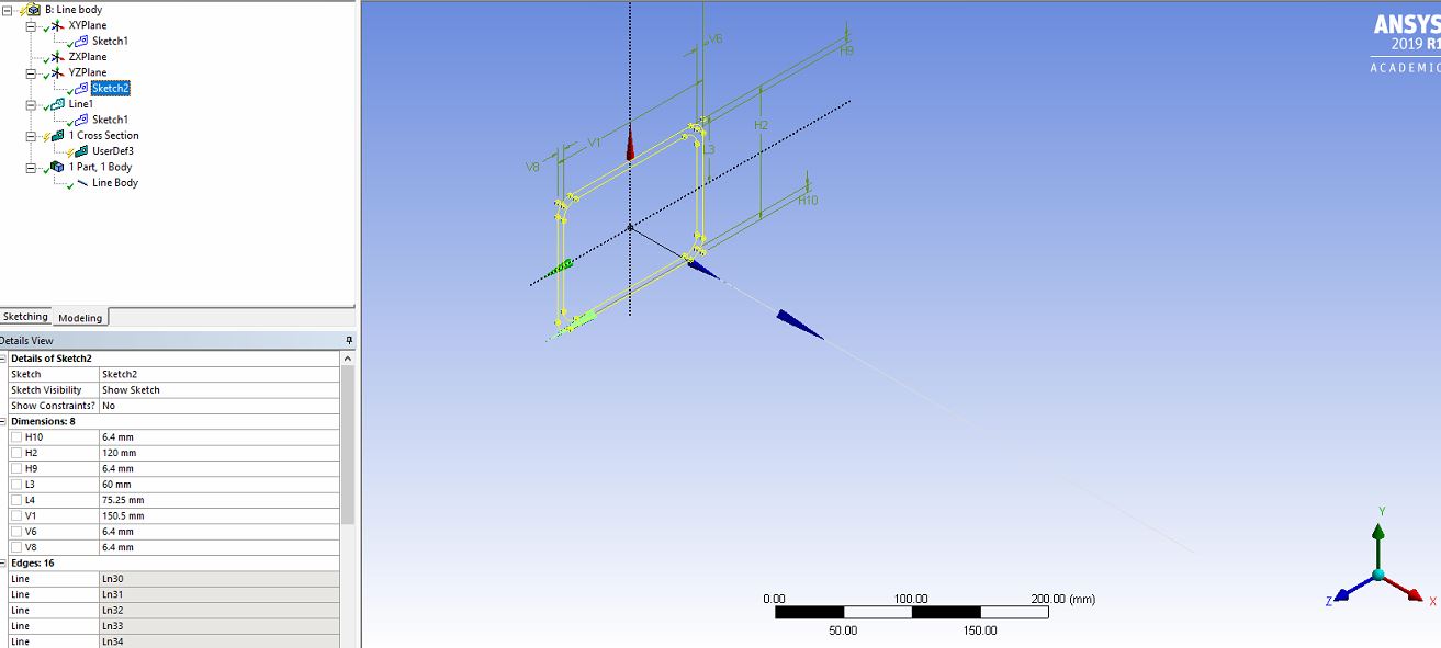

      I use DesignModeler, it is possible to change the plane of the cross section? because the centerline of the beam is on the X axis and the solid beam also has the axis on X since the solid is imported from another program.
       Thanks for your time.
    • mekafime
      I solved the cross section.

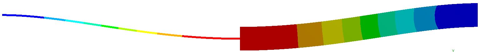

      Thanks for your help I was able to solve the model with variation of results and with a minimum calculation time.
