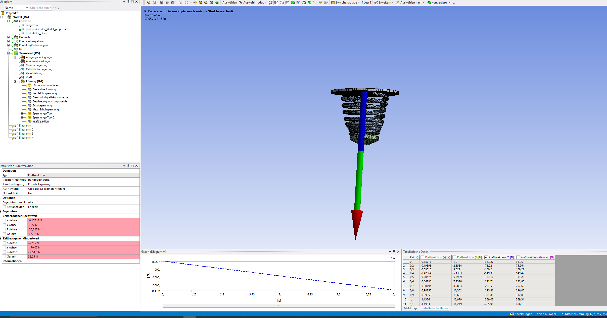

I am currently trying to illustrate the diffrence between a linear and a progressive spring.
For the linear spring the reaction froce is linear when I apple a displacement in the analysis.
But as shown in the picture for the progressive spring (variation in the outer diameter and the distance between windings) the reaction force still stays linear.
Do you maybe see a mistake here?
May 9, 2022 at 10:21 pmpeteroznewman
SubscriberThe mistake is if you have not defined self-contact between the turns of the spring coil. If the coils pass through each other in the simulation, you will get a linear spring. It is only progressive when adjacent coils touch each other.

SubscriberAdd a frictional contact and select the coil surface as both the target and the contact side of the pair.
Try solving this in Static Structural instead of Explicit Dynamics.

SubscriberIn Static Structural, you would apply a displacement to compress the spring over 1 second. You can see the force over time if you insert a Probe, Reaction Force on the Displacement.
In Transient Structural, you could apply a displacement to compress the spring over 1 second.

SubscriberNot true. In Static Structural, under Analysis Settings, use Minimum Substeps larger than 1 and you will get results on the way to the final condition. For example, if you set the Minimum Substeps to 31, you will get 30 results between 0 and the final condition.

SubscriberTry using line elements in Static Structural as shown in this discussion: /forum/discussion/20614/defining-self-contact-in-static-structural-in-spring-line-body-and-plate
