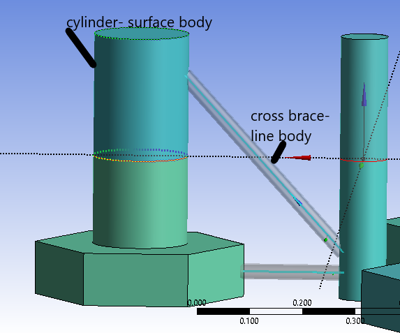

      I am doing hydrodynamic analysis in Ansys Aqwa. In a semisubmersible sturcture, I have to use surface bodies for cylindrical columns and line bodies for cross braces so that a hybrid approach using potential flow and morison equation will be used in analysis.
      I created the said braces using line from sketch option and later applied a circular cross section to get the cross braces. Now, my question is about the area where the brace and cylinder meet.As of now, they are different bodies in a part. Should I perform the  analysis as it is or should I do some joint operations or share topology operations for cylindrical surface body and cross brace line body.

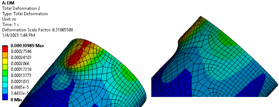

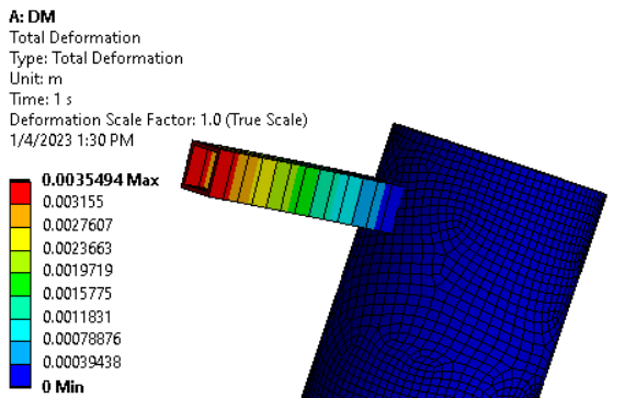

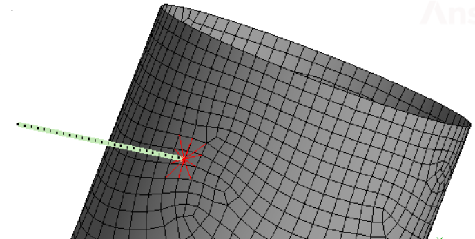

      A mentioned above, for a DM model, you must connect beams to shells in Mechanical since only SpaceClaim will do it in the CAD system. If you use a contact, set formulation to MPC. A joint should be set to fixed joint in most cases. Select the beam end vertex for contact/reference side. Select face for target/mobile side. In either case set a pinball radius on the side with the face selection. This connects constraints only within that pinball radius (red lines below):
      Thse constraints stiffen the model a bit in this locationm but may be more approiate to represent a beam welded at the cross section perimeter in this case:
      Scaled result on the cylindrical surface:

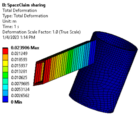

      Here is the same model setup using the share topology in SpaceClaim that connects only the one node at the beam end to one node on the surface:
      This may be appropriate in some models, but I don’t think it’s as good for this one.
