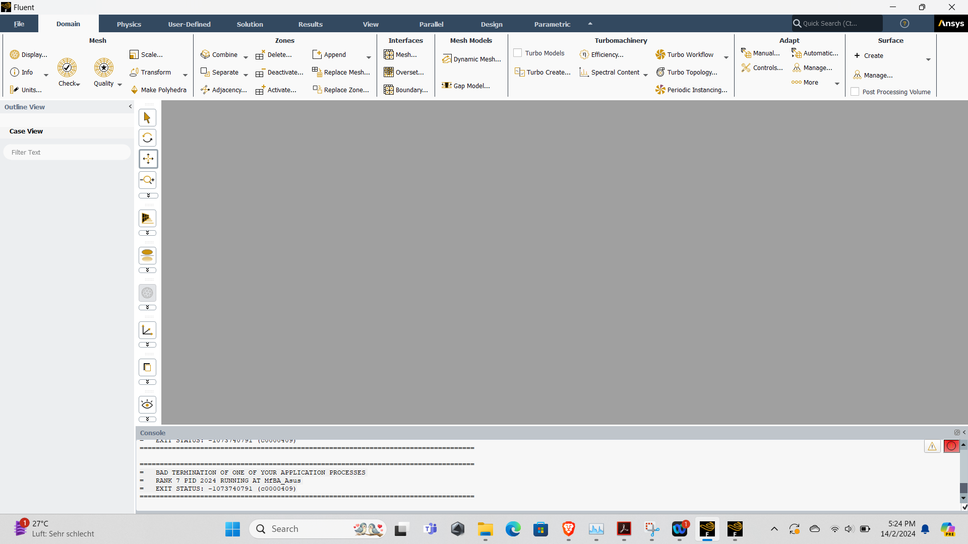

      I've encounted an error that says "Cannot switch mode due to license unavailability or licensing error" when I'm trying to go to "Switch to Solution" after i've completed the mesh.
      Please can you check the cell count, and if there is another solver running on your PC.
    • Muhamad Faiz
      How to check for the cell count and to know if there's other solver running?
      When meshing is complete there ought to be a message in the TUI. Re the solver, what else is running?
    • Muhamad Faiz
      Btw, fyi I also can't access the Solution from the Fluent Launcher. After I press start the curser loads for a very long time
      OK. If you reboot do you still have the problem? If so please expand the Console (TUI) window and post the screenshot(s).

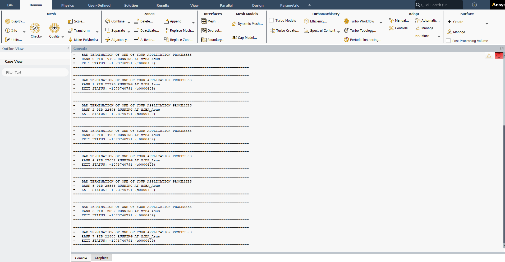

    • Muhamad Faiz
      I can't close the Window, it hangs. I need to end the programme from the task manager
      OK, and what's the text above what you posted? That's following a problem, what comes before may show what that problem is. How did the reboot go?

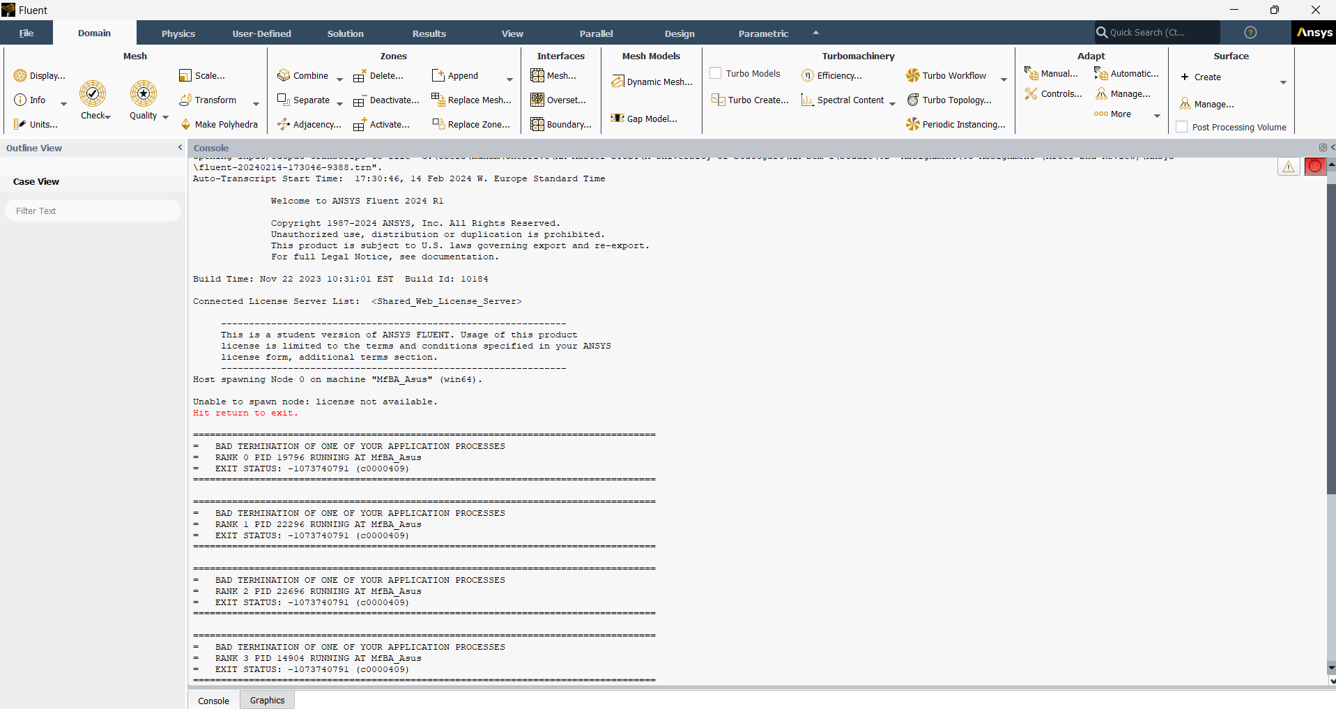

    • Muhamad Faiz
    • George Karnos
      Hello Muhamad,
      When installing, did you right-click on setup.exe and choose: more->run as administrator? If not, can you do so?
      Are there any errors, listed in the following file:
      C:\Program Files\ANSYS Inc\ANSYS Student\install.log
    • George Karnos
      Also,
      If you look under %TEMP%\.ansys You will see log and out files.
      Do those list any errors?
    • Muhamad Faiz
      Update: Problem solved due to lowering the number of processors to 4.
