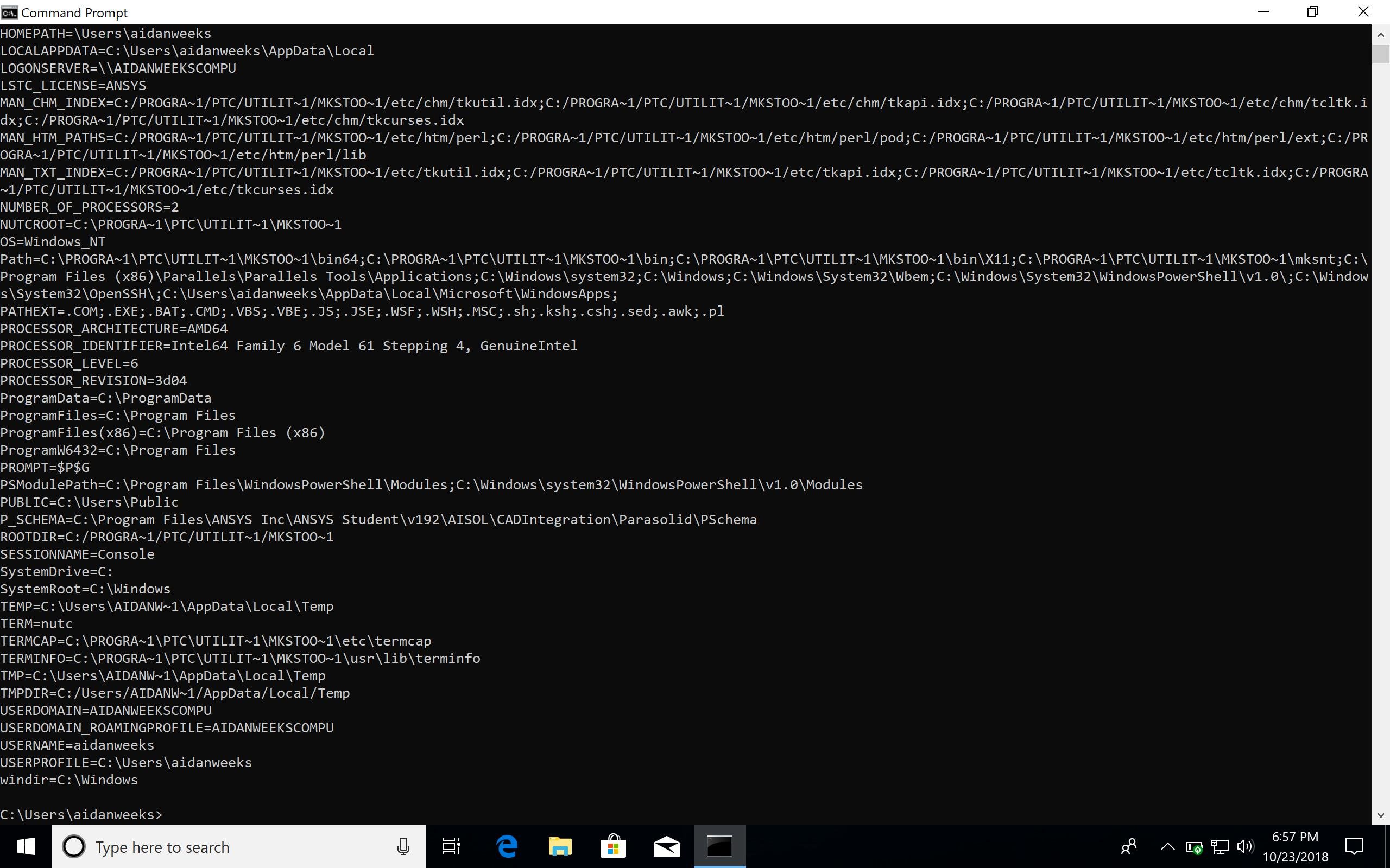

      Open CMD Prompt, then issue the following command
      set
      capture the screenshot of the output and post it here.
      Also, this "%temp%.ansys" is not the search from Windows File Explorer, it's the search box on Windows Taskbar (the one next to Windows Start Menu).
      Thanks,
      Win
    • aidanweeks95
      Hi,  here is screenshot. And I did search the last bit on the Windows Taskbar
      Aidan
