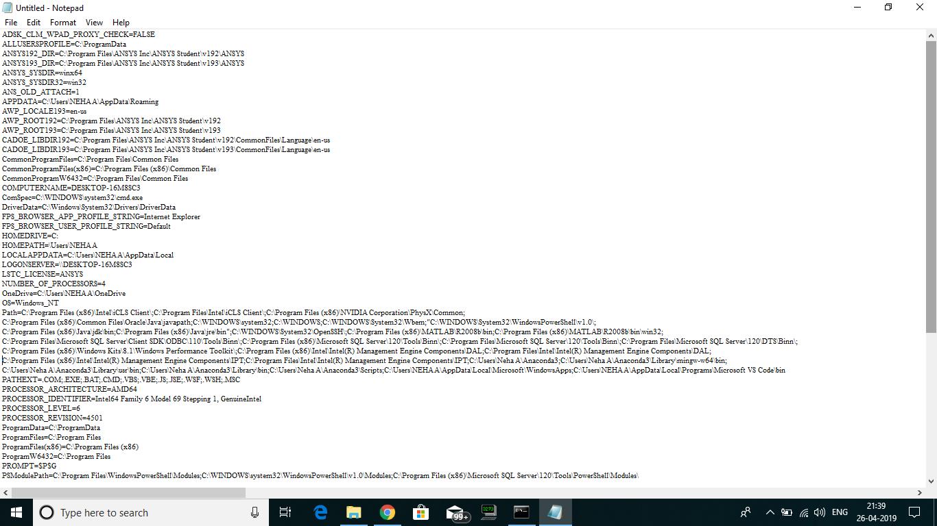

Ansys EmployeeHi nikhil12345,

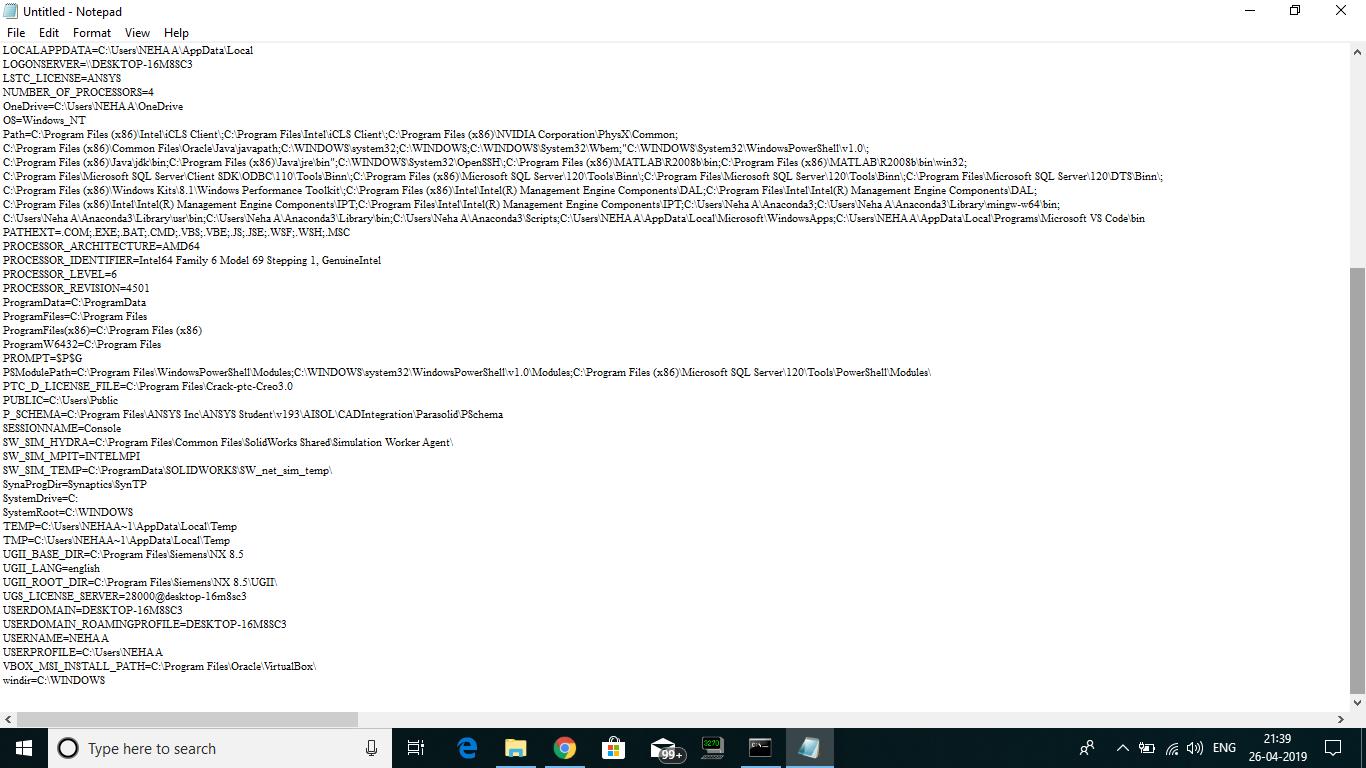

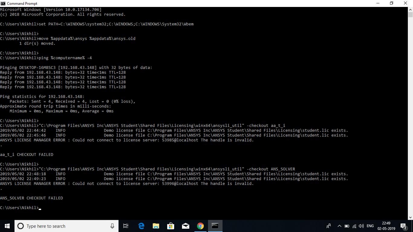

Could you please open a command prompt, and type:
set
and post a screenshot of the result?
Thank you,
Jake
April 25, 2019 at 6:56 pm
April 25, 2019 at 7:09 pm
JakeC

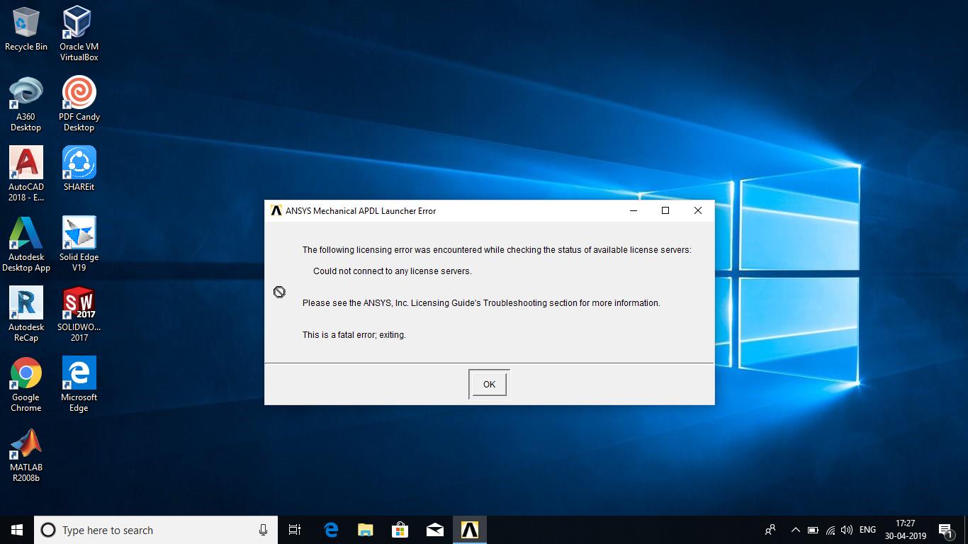

Ansys EmployeeHi nikhil12345, it doesn't look like all of it was included in the pic.
Please try this instead:
set | clip
That will put the output in your clipboard.
Then paste it into the post here.
Thank you,
Jake

JakeC
Ansys EmployeeStart -> type cmd -> Click on "Command Prompt"
At the prompt type:
set | clip
Then open a new / blank notepad document, and right click in the white area and select paste.
Then copy and paste that into a post here in this thread.
Thank you,
Jake

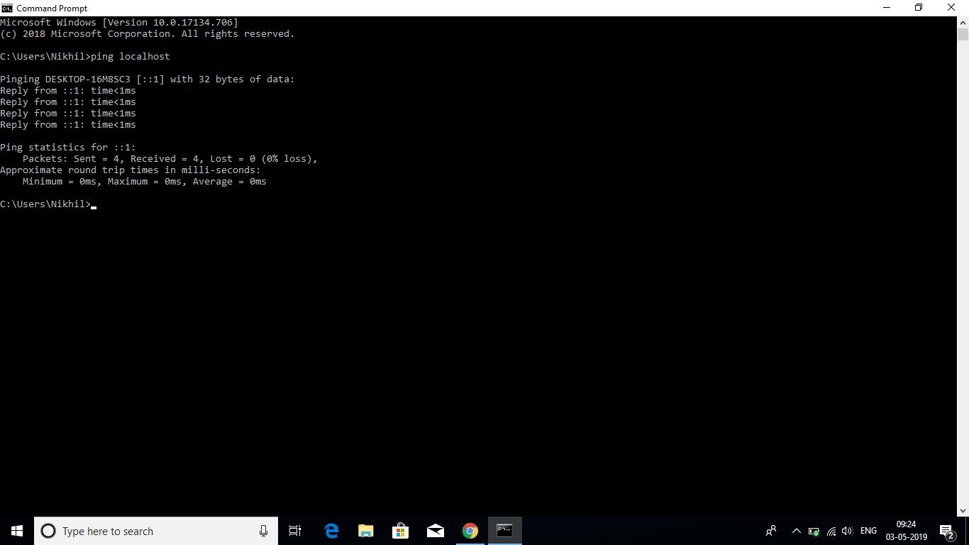

April 29, 2019 at 2:27 pm

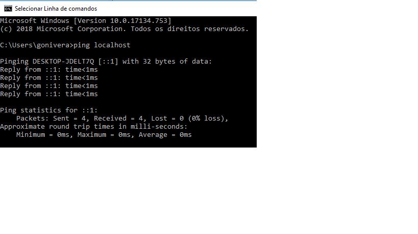

George Karnos
If you open a DOS CMD Prompt and type in the following, What is the output?
ping localhost
Thank You,
Geo

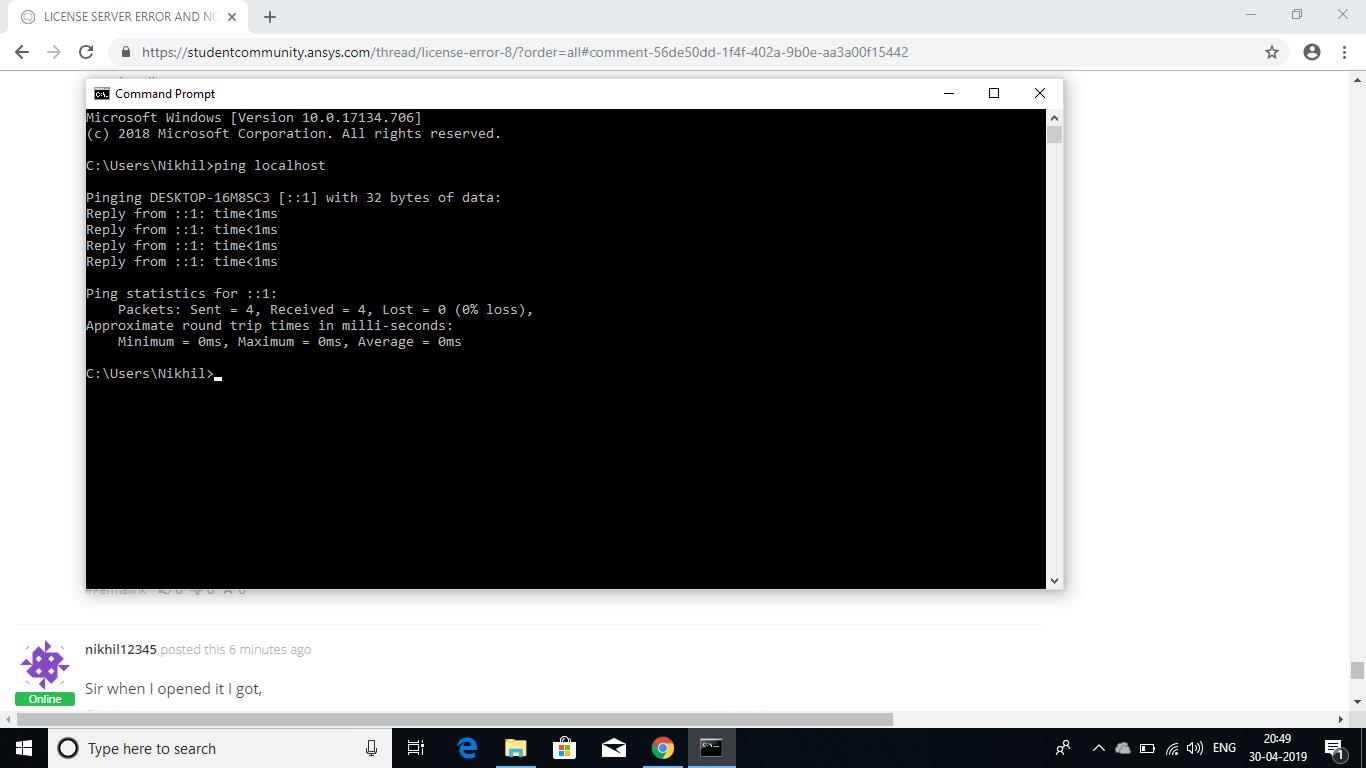

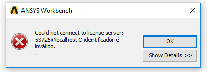

April 29, 2019 at 5:56 pm
nikhil12345
Subscriber Sir, Thanks for the reply,
Here is the pic of ping localhost.
 Sir, I don't know to change the local user name and if I change it will it work? As I am getting local server error or could not connect to the license server.

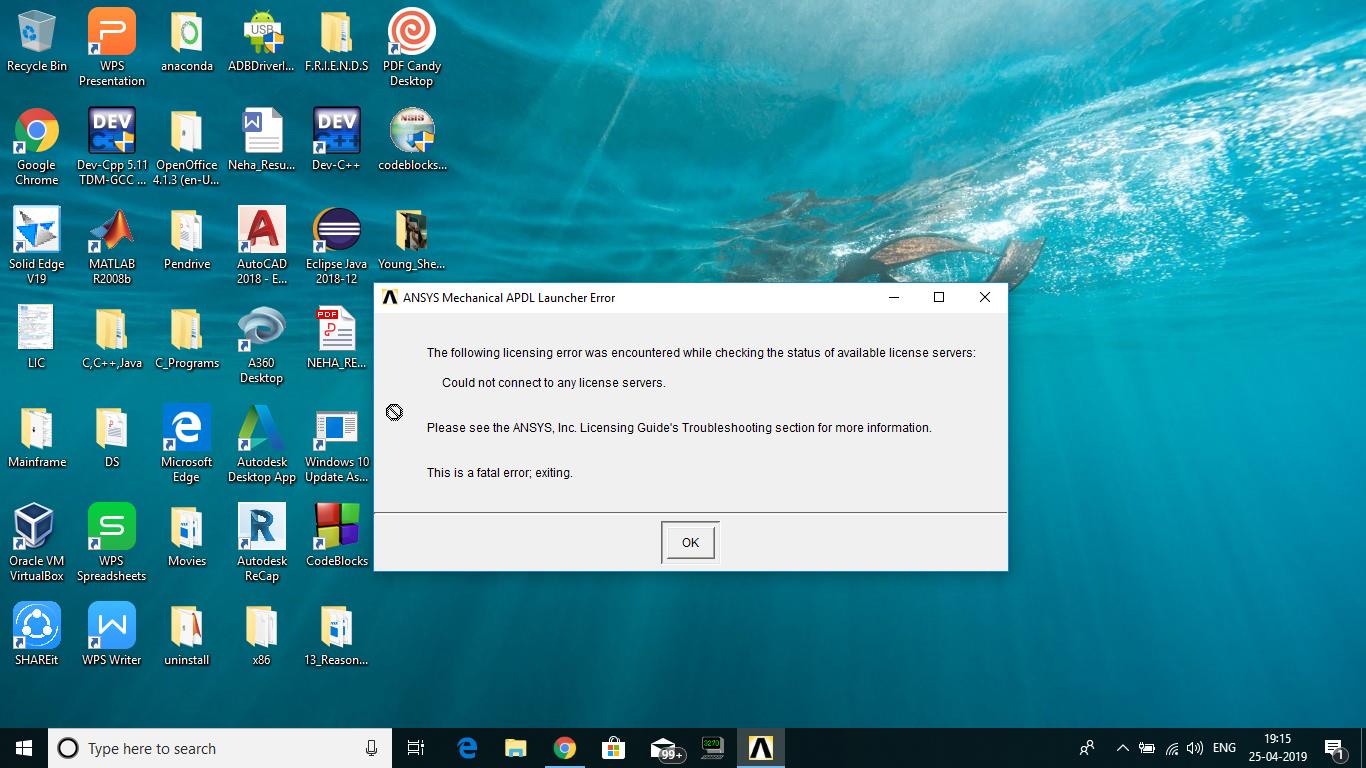

Can you specify the reason? This was one or two weeks back, I had version 19.2 which got the same error so I uninstalled it and installed it again it got the same error so now I installed this new version. And it shows the same error. So can you please help me out. And now I again installed it, should I set an environment variable for license and should I install the license manager and license server.
The new error is that could not connect to any license server and could not connect to local host,
.jpg?width=690&upscale=false)
Thank you

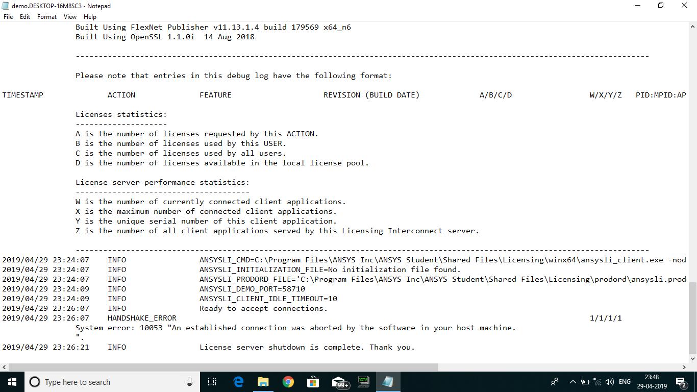

nikhil12345
SubscriberHello sir, I found this while searching servers and other stuff,
which reads as,
NORMAL STARTUP 2019/04/29 22:51:22
ANSYS Licensing Interconnect version 1.9.7 (20181112) for winx64. Updated at ANSYS Release 2019 R1. Started on 2019/04/29 22:51:22 by NEHA A@DESKTOP-16M8SC3:winx64 with pid 8212.

2019/04/29 22:53:20Â Â INFOÂ Â Â Â Â Â Â Â Ready to accept connections.
2019/04/29 22:53:21Â Â HANDSHAKE_ERRORÂ Â Â Â Â Â Â Â Â Â Â Â Â Â Â Â Â Â Â Â Â Â Â Â Â Â Â Â Â Â Â Â Â Â Â Â Â Â Â Â Â Â Â Â Â 1/1/1/1Â Â Â Â Â Â Â Â Â Â Â Â Â Â Â Â Â Â Â Â Â Â Â Â Â Â Â Â Â Â Â Â Â Â Â Â Â Â Â 65488:127.0.0.1Â Â Â
System error: 10053 "An established connection was aborted by the software in your host machine.
2019/04/29 22:53
6Â Â INFOÂ Â Â Â Â Â Â Â License server shutdown is complete. Thank you.

2019/04/29 23:26:07Â Â INFOÂ Â Â Â Â Â Â Â Ready to accept connections.
2019/04/29 23:26:07Â Â HANDSHAKE_ERRORÂ Â Â Â Â Â Â Â Â Â Â Â Â Â Â Â Â Â Â Â Â Â Â Â Â Â Â Â Â Â Â Â Â Â Â Â Â Â Â Â Â Â Â Â Â 1/1/1/1Â Â Â Â Â Â Â Â Â Â Â Â Â Â Â Â Â Â Â Â Â Â Â Â Â Â Â Â Â Â Â Â Â Â Â Â Â Â Â 65788:127.0.0.1Â Â Â
2019/04/29 23:26:21Â Â INFOÂ Â Â Â Â Â Â Â License server shutdown is complete.
This might help you solve the problem and sorry for troubling you guys.
Thank you.
(C) 2007 - 2019 ANSYS, Inc. Unauthorized use, distribution, or duplication is prohibited.
Built Using FlexNet Publisher v11.13.1.4 build 179569 x64_n6
Built Using OpenSSL 1.1.0i 14 Aug 2018
Please note that entries in this debug log have the following format:
TIMESTAMPÂ Â Â Â Â Â Â ACTIONÂ Â Â Â Â Â Â FEATUREÂ Â Â Â Â Â Â Â Â Â REVISION (BUILD DATE)Â Â Â Â Â Â Â A/B/C/DÂ Â Â Â Â Â Â Â Â W/X/Y/ZÂ Â PID:MPID:APP:USER@HOST
LATFORM
ISPLAYÂ Â Â Â Â Â Â Â Â Â Â Â Â Â Â Â Â Â SOCKET:IPÂ Â Â Â Â Â
Licenses statistics:
A is the number of licenses requested by this ACTION.
B is the number of licenses used by this USER.
C is the number of licenses used by all users.
D is the number of licenses available in the local license pool.
License server performance statistics:
W is the number of currently connected client applications.
X is the maximum number of connected client applications.
Y is the unique serial number of this client application.
Z is the number of all client applications served by this Licensing Interconnect server.
2019/04/29 22:51:22Â Â INFOÂ Â Â Â Â Â Â Â ANSYSLI_CMD=C:Program FilesANSYS IncANSYS StudentShared FilesLicensingwinx64ansysli_client.exe -nodaemon -demo -log C:UsersNEHAA~1AppDataLocalTemp.ansysdemo.log
2019/04/29 22:51:22Â Â INFOÂ Â Â Â Â Â Â Â ANSYSLI_INITIALIZATION_FILE=No initialization file found.
2019/04/29 22:51:22Â Â INFOÂ Â Â Â Â Â Â Â ANSYSLI_PRODORD_FILE='C:Program FilesANSYS IncANSYS StudentShared FilesLicensingprodordansysli.prodord.xml'
2019/04/29 22:51:24Â Â INFOÂ Â Â Â Â Â Â Â ANSYSLI_DEMO_PORT=49699Â
2019/04/29 22:51:24Â Â INFOÂ Â Â Â Â Â Â Â ANSYSLI_CLIENT_IDLE_TIMEOUT=10
2019/04/29 22:53
NORMAL STARTUP 2019/04/29 22:53:52
ANSYS Licensing Interconnect version 1.9.7 (20181112) for winx64. Updated at ANSYS Release 2019 R1. Started on 2019/04/29 22:53:52 by NEHA A@DESKTOP-16M8SC3:winx64 with pid 9860.
LATFORM
2019/04/29 22:53:52Â Â INFOÂ Â Â Â Â Â Â Â ANSYSLI_CMD=C:Program FilesANSYS IncANSYS StudentShared FilesLicensingwinx64ansysli_client.exe -nodaemon -demo -log C:UsersNEHAA~1AppDataLocalTemp.ansysdemo.log
2019/04/29 22:53:52Â Â INFOÂ Â Â Â Â Â Â Â ANSYSLI_INITIALIZATION_FILE=No initialization file found.
2019/04/29 22:53:52Â Â INFOÂ Â Â Â Â Â Â Â ANSYSLI_PRODORD_FILE='C:Program FilesANSYS IncANSYS StudentShared FilesLicensingprodordansysli.prodord.xml'
2019/04/29 22:53:55Â Â INFOÂ Â Â Â Â Â Â Â ANSYSLI_DEMO_PORT=49704Â
2019/04/29 22:53:55Â Â INFOÂ Â Â Â Â Â Â Â ANSYSLI_CLIENT_IDLE_TIMEOUT=10
2019/04/29 22:55:50Â Â INFOÂ Â Â Â Â Â Â Â Ready to accept connections.
2019/04/29 22:55:50Â Â HANDSHAKE_ERRORÂ Â Â Â Â Â Â Â Â Â Â Â Â Â Â Â Â Â Â Â Â Â Â Â Â Â Â Â Â Â Â Â Â Â Â Â Â Â Â Â Â Â Â Â Â 1/1/1/1Â Â Â Â Â Â Â Â Â Â Â Â Â Â Â Â Â Â Â Â Â Â Â Â Â Â Â Â Â Â Â Â Â Â Â Â Â Â Â 65488:127.0.0.1Â Â Â
2019/04/29 22:56:09Â Â INFOÂ Â Â Â Â Â Â Â License server shutdown is complete. Thank you.
NORMAL STARTUP 2019/04/29 23:21:09
ANSYS Licensing Interconnect version 1.9.7 (20181112) for winx64. Updated at ANSYS Release 2019 R1. Started on 2019/04/29 23:21:09 by NEHA A@DESKTOP-16M8SC3:winx64 with pid 10568.
LATFORM
2019/04/29 23:21:09Â Â INFOÂ Â Â Â Â Â Â Â ANSYSLI_CMD=C:Program FilesANSYS IncANSYS StudentShared FilesLicensingwinx64ansysli_client.exe -nodaemon -demo -log C:UsersNEHAA~1AppDataLocalTemp.ansysdemo.log
2019/04/29 23:21:09Â Â INFOÂ Â Â Â Â Â Â Â ANSYSLI_INITIALIZATION_FILE=No initialization file found.
2019/04/29 23:21:09Â Â INFOÂ Â Â Â Â Â Â Â ANSYSLI_PRODORD_FILE='C:Program FilesANSYS IncANSYS StudentShared FilesLicensingprodordansysli.prodord.xml'
2019/04/29 23:21:11Â Â INFOÂ Â Â Â Â Â Â Â ANSYSLI_DEMO_PORT=55719Â
2019/04/29 23:21:11Â Â INFOÂ Â Â Â Â Â Â Â ANSYSLI_CLIENT_IDLE_TIMEOUT=10
2019/04/29 23:23:15Â Â INFOÂ Â Â Â Â Â Â Â Ready to accept connections.
2019/04/29 23:23:15Â Â HANDSHAKE_ERRORÂ Â Â Â Â Â Â Â Â Â Â Â Â Â Â Â Â Â Â Â Â Â Â Â Â Â Â Â Â Â Â Â Â Â Â Â Â Â Â Â Â Â Â Â Â 1/1/1/1Â Â Â Â Â Â Â Â Â Â Â Â Â Â Â Â Â Â Â Â Â Â Â Â Â Â Â Â Â Â Â Â Â Â Â Â Â Â Â 65488:127.0.0.1Â Â Â
2019/04/29 23:23
0Â Â INFOÂ Â Â Â Â Â Â Â License server shutdown is complete. Thank you.
NORMAL STARTUP 2019/04/29 23:24:07
ANSYS Licensing Interconnect version 1.9.7 (20181112) for winx64. Updated at ANSYS Release 2019 R1. Started on 2019/04/29 23:24:07 by NEHA A@DESKTOP-16M8SC3:winx64 with pid 7668.
LATFORM
2019/04/29 23:24:07Â Â INFOÂ Â Â Â Â Â Â Â ANSYSLI_CMD=C:Program FilesANSYS IncANSYS StudentShared FilesLicensingwinx64ansysli_client.exe -nodaemon -demo -log C:UsersNEHAA~1AppDataLocalTemp.ansysdemo.log
2019/04/29 23:24:07Â Â INFOÂ Â Â Â Â Â Â Â ANSYSLI_INITIALIZATION_FILE=No initialization file found.
2019/04/29 23:24:07Â Â INFOÂ Â Â Â Â Â Â Â ANSYSLI_PRODORD_FILE='C:Program FilesANSYS IncANSYS StudentShared FilesLicensingprodordansysli.prodord.xml'
2019/04/29 23:24:09Â Â INFOÂ Â Â Â Â Â Â Â ANSYSLI_DEMO_PORT=58710Â
2019/04/29 23:24:09Â Â INFOÂ Â Â Â Â Â Â Â ANSYSLI_CLIENT_IDLE_TIMEOUT=10
2019/04/29 23:26:21Â Â INFOÂ Â Â Â Â Â Â Â License server shutdown is complete. Thank you.
This might help you solve the problem and assist me to use the Ansys version back into working condition.
Thank you.

George Karnos
Ansys EmployeeHello Nikhil12345,
Can you make sure the following line in in your C:WindowsSystem32driversetchosts file:
127.0.0.1Â Â Â Â localhost
If not in there, please add it and try opening a DOS CMD window andÂ
ping localhost
Does it return:
Reply from 127.0.0.1: bytes=32 time<1ms TTL=128
If so, now try to run.
Thank You,
Geo

Ansys EmployeeDo you have any .err files under C:Program FilesANSYS IncANSYS Student  ?
Please post screenshot of the content of this folder C:Program FilesANSYS IncANSYS StudentShared FilesLicensingwinx64
While logging in as your new user account (that you've just created) , open CMD Prompt, thenÂ
set | clip
and post the output of this again.

tsiriaks
Ansys EmployeeThanks for the info.
While you are logging in as the new user account, try the followings in CMD Prompt and post the screenshot of the output (Note: Make sure you copy and paste the exact commands)
set PATH=C:WINDOWSsystem32;C:WINDOWS;C:WINDOWSSystem32Wbem
move %appdata%ansys %appdata%ansys.old
ping %computername% -4
"C:Program FilesANSYS IncANSYS StudentShared FilesLicensingwinx64ansysli_util" -checkout aa_t_i
"C:Program FilesANSYS IncANSYS StudentShared FilesLicensingwinx64ansysli_util" -checkout ANS_SOLVER
Thanks,
Win

tsiriaks
Ansys EmployeeCan you try George's suggestion again about the hosts file ?
Open the hosts file and remove the # in front of this line
#127.0.0.1Â Â Â Â localhost
so that it's like
save the hosts file, then open up CMD Prompt, andÂ
ping localhost

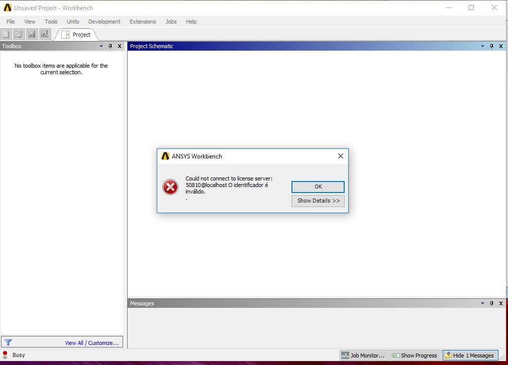

JasonL
SubscriberÂ
My wife is also having the exact same problem on her laptop
She is using Windows 10 with avira antivirus and windows firewall
The base windows language is Portuguese with ansys installed as language en-us
UK english is installed as the 2nd language
on first install it ran for a month with no issues
and then it stopped working and now gives this same error as nikhil12345
the application has been uninstalled and reinstalled multiple times, by my wife, with the same issue still occurring license server not working
I have years of experience in the IT sector installing applications like autocad with licensing servers etc as well as install software and fixing non working software.
I have re-downloaded the install file.
uninstalled the software from the laptop
removed the roaming profile and local profile ansys folders and the temp folder .ansys
I also uninstalled the C++ run-time libraries as a windows update had processed at a similar time as the error started
I also removed the files that were not uninstalled by the ansys uninstaller after a reboot
additionally I went though the windows system registry with regedit and removed keys that were not removed by the uninstaller and revid the firewall setting to make sure the executables that had tried to use tcp-ip protocols were not being blocked by the firewall  as some were being blocked. I also turned off the firewall completely to make sure this was not causing any further issues
I have replicated the same tests and have got the same results as nikhil12345
It appears to me that for some reason the setup is looking for a licensing server in the student.lic licensing file
Since the software is only installed as a client version there is no license server configured on the laptop.
From reading the messages on this board there is a separate licensing server available for download but should not be required this would be for a full commercial version
to prove this i downloaded the student application to my work laptop wi«hise is also win 10 but has english as the base language.
on install there were a couple of the c++Â run-times installed.
After a reboot of my computer the application runs fine and it seems to show that there is no configured license server
I have done a bunch of screen captures and log file dumps
as attached below
note the .ini file mentioned does not exist on the working or the not working pc
the license mode is showing as "floating" on both PC
ansys lic admin logÂ
Welcome to the Client ANSYS, Inc. Licensing Administration Utility
Hostname: DESKTOP-JDELT7Q
Installation directory: C:Program FilesANSYS IncANSYS Student
ERROR: The following problem was encountered while attempting
 to retrieve the user preferences license lists:
2019/05/02 18:26:14Â Â Â INFOÂ Â Â Â Â Â Â Â Â Â Â Â Â Â Â Demo license file C:Program FilesANSYS IncANSYS StudentShared FilesLicensingstudent.lic exists.
Could not connect to license server: 52442@localhost O identificador é inválido.
May 02, 2019 18:27: Attempting to display the license status...
DISPLAY THE LICENSE STATUS:
ANSYS Licensing Interconnect path =
ANSYS FLEXlm license path = C:Program FilesANSYS IncANSYS StudentShared FilesLicensingstudent.lic
***** Note: Due to a FLEXlm limitation, all tasks may not be found *****
***** LICENSE SERVER STATUS: C:Program FilesANSYS IncANSYS StudentShared FilesLicensingstudent.lic *****
lmutil - Copyright (c) 1989-2015 Flexera Software LLC. All Rights Reserved.
Flexible License Manager status on Thu 5/2/2019 18:27
[Detecting lmgrd processes...]
Error getting status: No SERVER lines in license file. (-13,66)Â
2019/05/02 18:28:06Â Â Â INFOÂ Â Â Â Â Â Â Â Â Â Â Â Â Â Â Demo license file C:Program FilesANSYS IncANSYS StudentShared FilesLicensingstudent.lic exists.

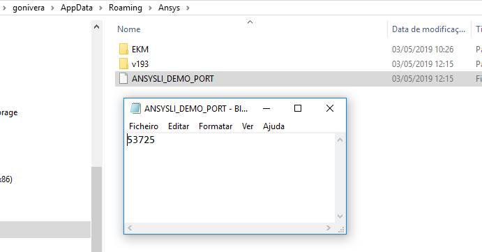

ANSYSLI exited or could not read server port ANSYSLI_DEMO_PORT.
Note: not working PCÂ also has matlab and Maple Installed which uses FLEXnet licensing service
unsure if this is a potential conflict with FLEXlm mentioned in one of the log files

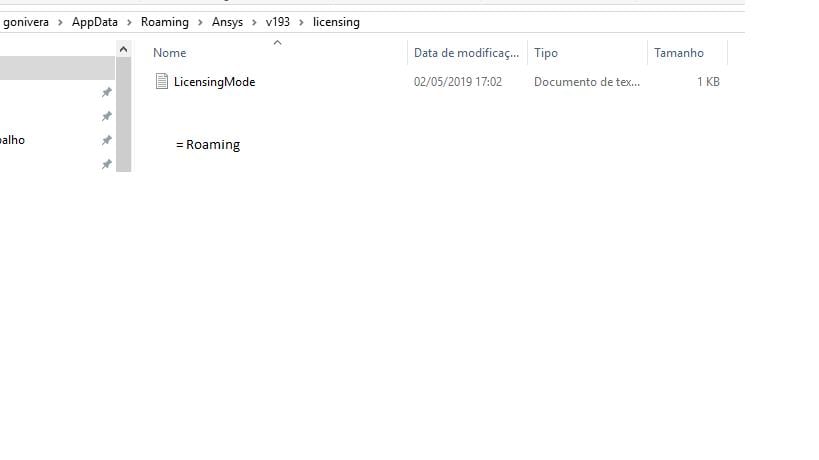

system environment variables are the same as the other user except for the default of a roaming profile giving a local and a roaming appdata folder for ansys

C:Usersgonivera>set
ALLUSERSPROFILE=C:ProgramData
ANSYS193_DIR=C:Program FilesANSYS IncANSYS Studentv193ANSYS
ANSYS_SYSDIR=winx64
ANSYS_SYSDIR32=win32
ANS_OLD_ATTACH=1
APPDATA=C:UsersgoniveraAppDataRoaming
AWP_LOCALE193=en-us
AWP_ROOT193=C:Program FilesANSYS IncANSYS Studentv193
CADOE_LIBDIR193=C:Program FilesANSYS IncANSYS Studentv193CommonFilesLanguageen-us
CommonProgramFiles=C:Program FilesCommon Files
CommonProgramFiles(x86)=C:Program Files (x86)Common Files
CommonProgramW6432=C:Program FilesCommon Files
COMPUTERNAME=DESKTOP-JDELT7Q
ComSpec=C:WINDOWSsystem32cmd.exe
DriverData=C:WindowsSystem32DriversDriverData
FPS_BROWSER_APP_PROFILE_STRING=Internet Explorer
FPS_BROWSER_USER_PROFILE_STRING=Default
HOMEDRIVE=C:
HOMEPATH=Usersgonivera
LOCALAPPDATA=C:UsersgoniveraAppDataLocal
LOGONSERVER=\DESKTOP-JDELT7Q
LSTC_LICENSE=ANSYS
NUMBER_OF_PROCESSORS=4
OneDrive=C:UsersgoniveraOneDrive
OneDriveConsumer=C:UsersgoniveraOneDrive
OS=Windows_NT
Path=C:Program Files (x86)InteliCLS Client;C:Program FilesInteliCLS Client;C:Windowssystem32;C:Windows;C:WindowsSystem32Wbem;C:WindowsSystem32WindowsPowerShellv1.0;C:Program Files (x86)IntelIntel(R) Management Engine ComponentsDAL;C:Program FilesIntelIntel(R) Management Engine ComponentsDAL;C:Program Files (x86)IntelIntel(R) Management Engine ComponentsIPT;C:Program FilesIntelIntel(R) Management Engine ComponentsIPT;C:Program Files (x86)NVIDIA CorporationPhysXCommon;C:WINDOWSsystem32;C:WINDOWS;C:WINDOWSSystem32Wbem;C:WINDOWSSystem32WindowsPowerShellv1.0;C:WINDOWSSystem32OpenSSH;C:UsersgoniveraAppDataLocalMicrosoftWindowsApps;
PATHEXT=.COM;.EXE;.BAT;.CMD;.VBS;.VBE;.JS;.JSE;.WSF;.WSH;.MSC
PROCESSOR_ARCHITECTURE=AMD64
PROCESSOR_IDENTIFIER=Intel64 Family 6 Model 69 Stepping 1, GenuineIntel
PROCESSOR_LEVEL=6
PROCESSOR_REVISION=4501
ProgramData=C:ProgramData
PROMPT=$P$G
PSModulePath=C:Program FilesWindowsPowerShellModules;C:WINDOWSsystem32WindowsPowerShellv1.0Modules
PUBLIC=C:UsersPublic
P_SCHEMA=C:Program FilesANSYS IncANSYS Studentv193AISOLCADIntegrationParasolidPSchema
SESSIONNAME=Console
SystemDrive=C:
SystemRoot=C:WINDOWS
TEMP=C:UsersgoniveraAppDataLocalTemp
TMP=C:UsersgoniveraAppDataLocalTemp
USERDOMAIN=DESKTOP-JDELT7Q
USERDOMAIN_ROAMINGPROFILE=DESKTOP-JDELT7Q
USERNAME=gonivera
USERPROFILE=C:Usersgonivera
VPD_TEMP=C:ProgramDataObviousIdeaGreenCloud Printer
windir=C:WINDOWS
C:Usersgonivera>

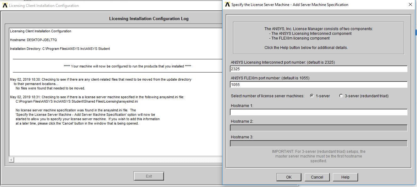

Install_licconfig
May 02, 2019 17:00: Output from ANSYS, Inc. Silent Licensing Client Installation Configuration run during Release 2019 R1 installation:
Current date and time: May 02, 2019 - 16:59
__________________________________________________________________________________________________________________________
                  ***** Your machine will now be configured to run the products that you installed *****
Checking to see if there are any client-related files that need to be moved from the update directory
   to their permanent locations...

NORMAL STARTUP 2019/05/03 11:01:23
  ANSYS Licensing Interconnect version 1.9.7 (20181112) for winx64. Updated at ANSYS Release 2019 R1. Started on 2019/05/03 11:01:23 by gonivera@DESKTOP-JDELT7Q:winx64 with pid 2684.
TIMESTAMPÂ Â Â Â Â Â Â Â Â Â Â Â Â ACTIONÂ Â Â Â Â Â Â Â Â Â Â Â Â FEATUREÂ Â Â Â Â Â Â Â Â Â Â Â Â Â Â Â Â Â Â REVISION (BUILD DATE)Â Â Â Â Â Â Â Â Â Â Â Â A/B/C/DÂ Â Â Â Â Â Â Â Â Â Â Â Â Â Â Â W/X/Y/ZÂ Â PID:MPID:APP:USER@HOST
LATFORM
ISPLAYÂ Â Â Â Â Â Â Â Â Â Â Â Â Â Â Â Â Â Â Â Â Â Â Â Â Â Â Â Â Â Â Â Â Â Â SOCKET:IPÂ Â Â Â Â Â Â Â Â Â
2019/05/03 11:01:23Â Â Â INFOÂ Â Â Â Â Â Â Â Â Â Â Â Â Â Â ANSYSLI_CMD=C:Program FilesANSYS IncANSYS StudentShared FilesLicensingwinx64ansysli_client.exe -nodaemon -demo -log C:UsersgoniveraAppDataLocalTemp.ansysdemo.log
2019/05/03 11:01:23Â Â Â INFOÂ Â Â Â Â Â Â Â Â Â Â Â Â Â Â ANSYSLI_INITIALIZATION_FILE=No initialization file found.
2019/05/03 11:01:23Â Â Â INFOÂ Â Â Â Â Â Â Â Â Â Â Â Â Â Â ANSYSLI_PRODORD_FILE='C:Program FilesANSYS IncANSYS StudentShared FilesLicensingprodordansysli.prodord.xml'
2019/05/03 11:01:27Â Â Â INFOÂ Â Â Â Â Â Â Â Â Â Â Â Â Â Â ANSYSLI_DEMO_PORT=51387
2019/05/03 11:01:27Â Â Â INFOÂ Â Â Â Â Â Â Â Â Â Â Â Â Â Â ANSYSLI_CLIENT_IDLE_TIMEOUT=10
2019/05/03 11:05:17Â Â Â INFOÂ Â Â Â Â Â Â Â Â Â Â Â Â Â Â Ready to accept connections.
2019/05/03 11:05:17Â Â Â HANDSHAKE_ERRORÂ Â Â Â Â Â Â Â Â Â Â Â Â Â Â Â Â Â Â Â Â Â Â Â Â Â Â Â Â Â Â Â Â Â Â Â Â Â Â Â Â Â Â Â Â Â Â Â Â Â Â Â Â Â Â Â Â Â Â Â Â Â Â Â Â Â Â Â Â Â Â Â Â Â Â Â Â Â Â Â Â Â Â Â Â Â Â Â Â 1/1/1/1Â Â Â Â Â Â Â Â Â Â Â Â Â Â Â Â Â Â Â Â Â Â Â Â Â Â Â Â Â Â Â Â Â Â Â Â Â Â Â Â Â Â Â Â Â Â Â Â Â Â Â Â Â Â Â Â Â Â Â Â Â Â Â Â Â Â Â Â Â Â Â Â Â Â Â Â Â 65488:127.0.0.1Â Â Â Â
  System error: 10053 "Uma ligação estabelecida foi anulada pelo software no computador anfitrião.
2019/05/03 11:05
4Â Â Â INFOÂ Â Â Â Â Â Â Â Â Â Â Â Â Â Â License server shutdown is complete. Thank you.

2019/05/03 11:26
5   INFO               C:Program FilesANSYS IncANSYS StudentShared FilesLicensingwinx64ansysli_client.exe -demo -log C:UsersgoniveraAppDataLocalTemp.ansysdemo.log
2019/05/03 11:26
5Â Â Â INFOÂ Â Â Â Â Â Â Â Â Â Â Â Â Â Â Started ANSYSLI server.
2019/05/03 11:27:40Â Â Â HANDSHAKE_ERRORÂ Â Â Â Â Â Â Â Â Â Â Â Â Â Â Â Â Â Â Â Â Â Â Â Â Â Â Â Â Â Â Â Â Â Â Â Â Â Â Â Â Â Â Â Â Â Â Â Â Â Â Â Â Â Â Â Â Â Â Â Â Â Â Â Â Â Â Â Â Â Â Â Â Â Â Â Â Â Â Â Â Â Â Â Â Â Â Â Â 0/0/0/0Â Â 1700:ALI_UTIL:gonivera@DESKTOP-JDELT7Q:winx64Â Â Â Â Â Â Â Â Â Â Â Â Â 0:192.168.1.71Â Â Â Â Â
  Could not make an SSL handshake with server 52260@localhost.
  Connection timed out while handshaking with the server.
2019/05/03 11:27:40   CONNECT_ERROR      aa_t_i                                                                              0/0/0/0  1700:ALI_UTIL:gonivera@DESKTOP-JDELT7Q:winx64             0:192.168.1.71    Â
  Could not connect to license server: 52260@localhost O identificador é inválido.

another thing I noticed
pint localhost resolves to the IPV6 localhost address as below
ping 127.0.0.1 gets the ipv4 address
the hosts file only has the ivp4 localhost uncommented, so the DNS or ip stack is resolving this on its own
C:UsersgoniveraAppDataLocalTemp.ansys>ping localhost
Pinging DESKTOP-JDELT7Q [::1] with 32 bytes of data:
Reply from ::1: time<1ms
Ping statistics for ::1:
   Packets: Sent = 4, Received = 4, Lost = 0 (0% loss),
Approximate round trip times in milli-seconds:
   Minimum = 0ms, Maximum = 0ms, Average = 0ms
C:UsersgoniveraAppDataLocalTemp.ansys>ping 127:0.0.1
Ping request could not find host 127:0.0.1. Please check the name and try again.
C:UsersgoniveraAppDataLocalTemp.ansys>ping 127.0.0.1
Pinging 127.0.0.1 with 32 bytes of data:
Ping statistics for 127.0.0.1:

#Â ::1Â Â Â Â Â Â Â Â Â Â Â Â localhostMay 3, 2019 at 11:23 amJasonL
Subscriberon checking my working PCÂ when I run ansys workbence the demo port file changes to the port number of the server and Workbench runs ok
when I started Workbench on the non working PC the port number did chage
but before the app even opens the demo port file changes back to 0
and the app comes up with the error connecting to the server.
could this be a timeout issue with the license server timeout period not being long enough as this pc has a core I3 1.6 GHz cpu and only has 4GB Ram
or some other protocol error as it appeard the app tried to connect to the server on the correct port but the server shutdown as reverted the port to 0 and stopped answering
app took about 1.5 mins to load.
before the error appeared
2019/05/03 12:15:43Â Â Â INFOÂ Â Â Â Â Â Â Â Â Â Â Â Â Â Â ANSYSLI_CMD=C:Program FilesANSYS IncANSYS StudentShared FilesLicensingwinx64ansysli_client.exe -nodaemon -demo -log C:UsersgoniveraAppDataLocalTemp.ansysdemo.log
2019/05/03 12:15:43Â Â Â INFOÂ Â Â Â Â Â Â Â Â Â Â Â Â Â Â ANSYSLI_INITIALIZATION_FILE=No initialization file found.
2019/05/03 12:15:43Â Â Â INFOÂ Â Â Â Â Â Â Â Â Â Â Â Â Â Â ANSYSLI_PRODORD_FILE='C:Program FilesANSYS IncANSYS StudentShared FilesLicensingprodordansysli.prodord.xml'
2019/05/03 12:15:49Â Â Â INFOÂ Â Â Â Â Â Â Â Â Â Â Â Â Â Â ANSYSLI_DEMO_PORT=53725
2019/05/03 12:15:49Â Â Â INFOÂ Â Â Â Â Â Â Â Â Â Â Â Â Â Â ANSYSLI_CLIENT_IDLE_TIMEOUT=10
2019/05/03 12:19:24Â Â Â INFOÂ Â Â Â Â Â Â Â Â Â Â Â Â Â Â Ready to accept connections.
2019/05/03 12:19:24Â Â Â HANDSHAKE_ERRORÂ Â Â Â Â Â Â Â Â Â Â Â Â Â Â Â Â Â Â Â Â Â Â Â Â Â Â Â Â Â Â Â Â Â Â Â Â Â Â Â Â Â Â Â Â Â Â Â Â Â Â Â Â Â Â Â Â Â Â Â Â Â Â Â Â Â Â Â Â Â Â Â Â Â Â Â Â Â Â Â Â Â Â Â Â Â Â Â Â 1/1/1/1Â Â Â Â Â Â Â Â Â Â Â Â Â Â Â Â Â Â Â Â Â Â Â Â Â Â Â Â Â Â Â Â Â Â Â Â Â Â Â Â Â Â Â Â Â Â Â Â Â Â Â Â Â Â Â Â Â Â Â Â Â Â Â Â Â Â Â Â Â Â Â Â Â Â Â Â Â 65488:127.0.0.1Â Â Â Â
2019/05/03 12:19:41Â Â Â INFOÂ Â Â Â Â Â Â Â Â Â Â Â Â Â Â License server shutdown is complete. Thank you.May 3, 2019 at 11:48 amJasonL
Subscribermake an SSL handshake with server 54476@localhost.
2019/05/03 12:44:06Â Â Â CONNECT_ERRORÂ Â Â Â Â Â 10001 (SHARED MODE)Â Â Â Â Â Â Â Â Â Â Â Â Â Â Â Â Â Â Â Â Â Â Â Â Â Â Â Â Â Â Â Â Â Â Â Â Â Â Â Â Â Â Â Â Â Â Â Â Â Â Â Â Â Â Â Â Â Â Â Â Â Â Â Â Â 0/0/0/0Â Â 7364:ANS_WB:gonivera@DESKTOP-JDELT7Q:winx64Â Â Â Â Â Â Â Â Â Â Â Â Â Â Â 0:192.168.1.71Â Â Â Â Â
  Could not connect to license server: 54476@localhost O identificador é inválido.
2019/05/03 12:44:06Â Â Â HANDSHAKE_ERRORÂ Â Â Â Â Â Â Â Â Â Â Â Â Â Â Â Â Â Â Â Â Â Â Â Â Â Â Â Â Â Â Â Â Â Â Â Â Â Â Â Â Â Â Â Â Â Â Â Â Â Â Â Â Â Â Â Â Â Â Â Â Â Â Â Â Â Â Â Â Â Â Â Â Â Â Â Â Â Â Â Â Â Â Â Â Â Â Â Â 0/0/0/0Â Â 10604:ANS_WB:gonivera@DESKTOP-JDELT7Q:winx64Â Â Â Â Â Â Â Â Â Â Â Â Â Â 0:192.168.1.71Â Â Â Â Â
  Could not make an SSL handshake with server 54476@localhost.
2019/05/03 12:44:06Â Â Â CONNECT_ERRORÂ Â Â Â Â Â 10001 (SHARED MODE)Â Â Â Â Â Â Â Â Â Â Â Â Â Â Â Â Â Â Â Â Â Â Â Â Â Â Â Â Â Â Â Â Â Â Â Â Â Â Â Â Â Â Â Â Â Â Â Â Â Â Â Â Â Â Â Â Â Â Â Â Â Â Â Â Â 0/0/0/0Â Â 10604:ANS_WB:gonivera@DESKTOP-JDELT7Q:winx64Â Â Â Â Â Â Â Â Â Â Â Â Â Â 0:192.168.1.71Â Â Â Â Â
NORMAL STARTUP 2019/05/03 12:42:59
  ANSYS Licensing Interconnect version 1.9.7 (20181112) for winx64. Updated at ANSYS Release 2019 R1. Started on 2019/05/03 12:42:59 by gonivera@DESKTOP-JDELT7Q:winx64 with pid 2668.
LATFORM
2019/05/03 12:42:59Â Â Â INFOÂ Â Â Â Â Â Â Â Â Â Â Â Â Â Â ANSYSLI_CMD=C:Program FilesANSYS IncANSYS StudentShared FilesLicensingwinx64ansysli_client.exe -nodaemon -demo -log C:UsersgoniveraAppDataLocalTemp.ansysdemo.log
2019/05/03 12:42:59Â Â Â INFOÂ Â Â Â Â Â Â Â Â Â Â Â Â Â Â ANSYSLI_INITIALIZATION_FILE=No initialization file found.
2019/05/03 12:42:59Â Â Â INFOÂ Â Â Â Â Â Â Â Â Â Â Â Â Â Â ANSYSLI_PRODORD_FILE='C:Program FilesANSYS IncANSYS StudentShared FilesLicensingprodordansysli.prodord.xml'
2019/05/03 12:43:06Â Â Â INFOÂ Â Â Â Â Â Â Â Â Â Â Â Â Â Â ANSYSLI_DEMO_PORT=54476
2019/05/03 12:43:06Â Â Â INFOÂ Â Â Â Â Â Â Â Â Â Â Â Â Â Â ANSYSLI_CLIENT_IDLE_TIMEOUT=10
2019/05/03 12:46
2019/05/03 12:46
4Â Â Â HANDSHAKE_ERRORÂ Â Â Â Â Â Â Â Â Â Â Â Â Â Â Â Â Â Â Â Â Â Â Â Â Â Â Â Â Â Â Â Â Â Â Â Â Â Â Â Â Â Â Â Â Â Â Â Â Â Â Â Â Â Â Â Â Â Â Â Â Â Â Â Â Â Â Â Â Â Â Â Â Â Â Â Â Â Â Â Â Â Â Â Â Â Â Â Â 2/2/1/2Â Â Â Â Â Â Â Â Â Â Â Â Â Â Â Â Â Â Â Â Â Â Â Â Â Â Â Â Â Â Â Â Â Â Â Â Â Â Â Â Â Â Â Â Â Â Â Â Â Â Â Â Â Â Â Â Â Â Â Â Â Â Â Â Â Â Â Â Â Â Â Â Â Â Â Â Â 65792:127.0.0.1Â Â Â Â
2019/05/03 12:46
4Â Â Â HANDSHAKE_ERRORÂ Â Â Â Â Â Â Â Â Â Â Â Â Â Â Â Â Â Â Â Â Â Â Â Â Â Â Â Â Â Â Â Â Â Â Â Â Â Â Â Â Â Â Â Â Â Â Â Â Â Â Â Â Â Â Â Â Â Â Â Â Â Â Â Â Â Â Â Â Â Â Â Â Â Â Â Â Â Â Â Â Â Â Â Â Â Â Â Â 1/2/2/2Â Â Â Â Â Â Â Â Â Â Â Â Â Â Â Â Â Â Â Â Â Â Â Â Â Â Â Â Â Â Â Â Â Â Â Â Â Â Â Â Â Â Â Â Â Â Â Â Â Â Â Â Â Â Â Â Â Â Â Â Â Â Â Â Â Â Â Â Â Â Â Â Â Â Â Â Â 65796:127.0.0.1Â Â Â Â
2019/05/03 12:46:50Â Â Â INFOÂ Â Â Â Â Â Â Â Â Â Â Â Â Â Â License server shutdown is complete. Thank you.

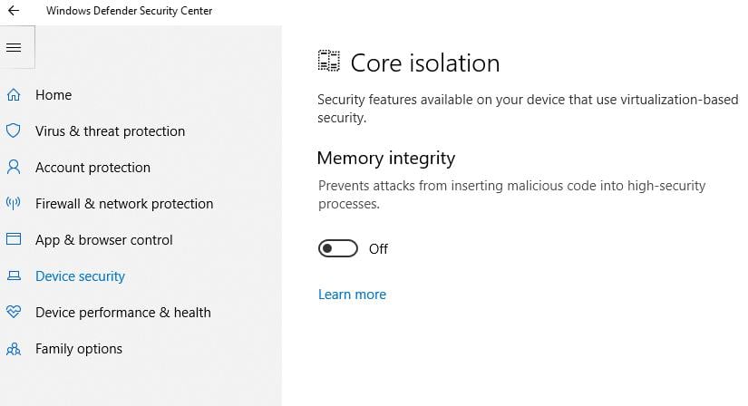

May 3, 2019 at 9:36 pmJasonL
SubscriberWife's Ansys Problem resolved
Solution - hope this helps resolve your problem also nikhil12345
on My wife's PC this was turned on in windows defender.
My PC had it off.
Upon turning this off and rebooting the PC Ansys started working ok and now shows all the extensions and the license server is working.
possibly this is breaking something in open SSL or the TCP/IP related to the kernel process security
May 4, 2019 at 3:04 pmnikhil12345
SubscriberThanks for the reply
Even I had the same problem, It was turned on. As you suggested me, I just turned it off and restarted my pc, now Ansys is working normally working.
Thank you very much
Now I am glad that Ansys is working normally
Thanks once again

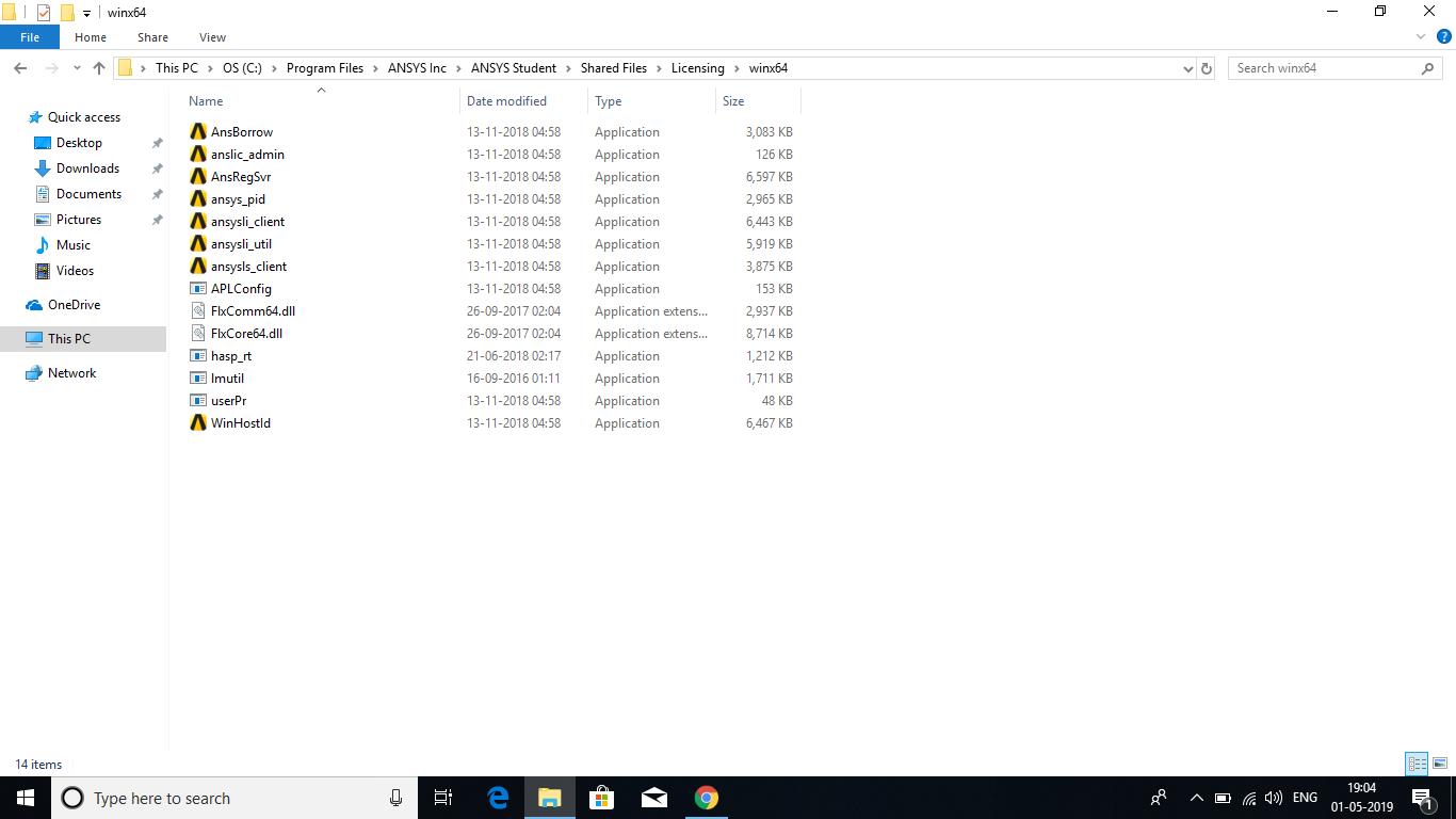

SubscriberDo this in CMD:ncd c:\program files\ansys inc\ansys student\shared files\licensing\winx64nand thisnansysli_util.exe -checkout FLUENT_SOLVERnViewing 42 reply threads- The topic ‘LICENSE SERVER ERROR AND NOT ABLE TO INSTALL ANSYS 2019R1’ is closed to new replies.
